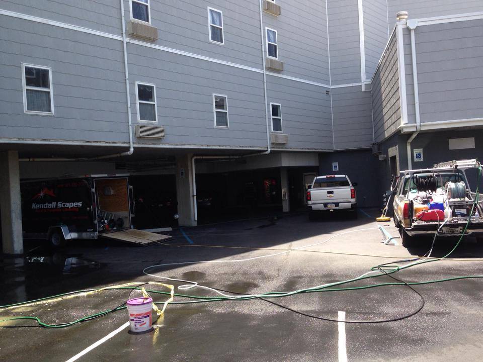

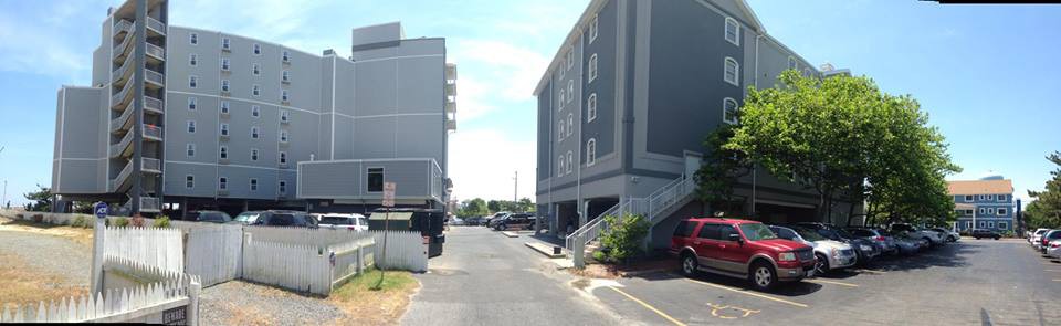

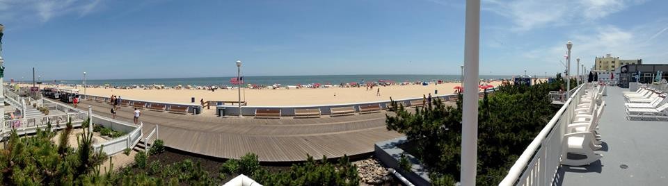

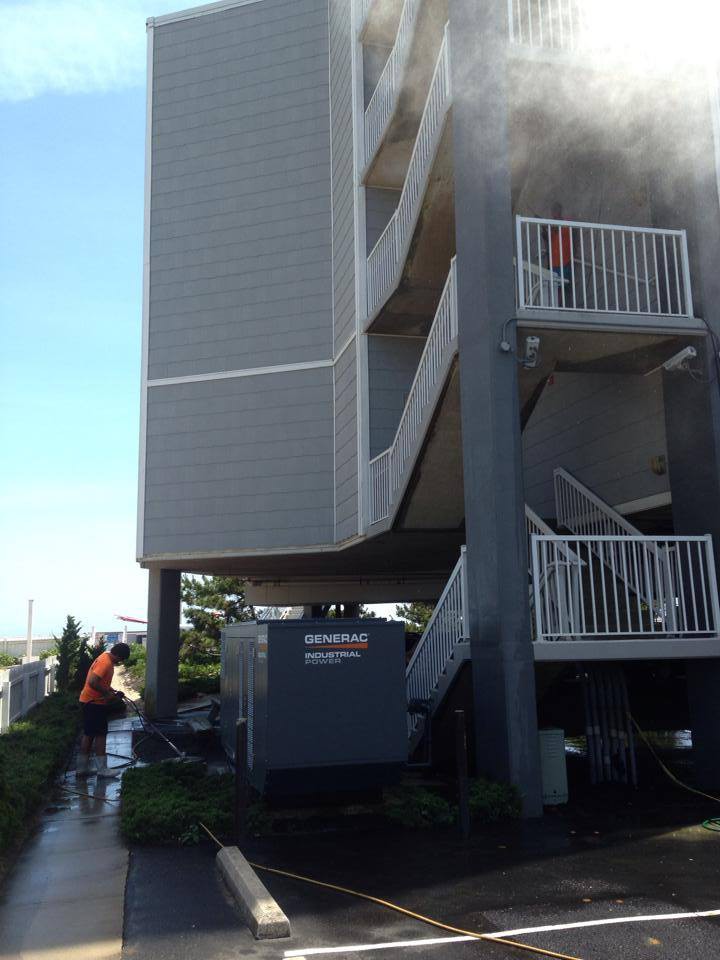

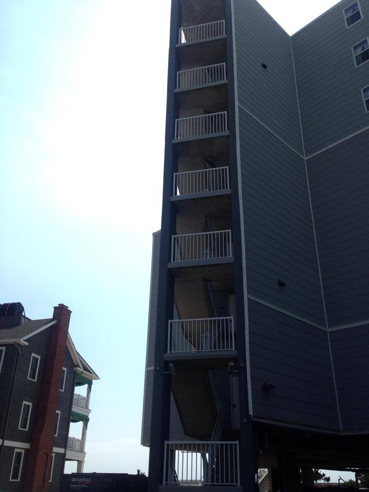

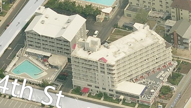

Here is a hotel power-washing job from Ocean City Maryland. This hotel has over 300+ rooms, indoor pools and boardwalk restaurant which we will be cleaning the roof of. Lots of flatwork including walkways and siding, tons of stairs and a rubber membrane roof over the pool bar area. For more information on commercial pressure washing in Ocean City Maryland, please contact us today.

lee what is your mo with all the hotel customer concerns chemical over spray, people walking around, cars etc

Will- Couldn't use any for most of the cleaning- the only chems we used was early in the morning on the round roof on the pool bar and parts of the siding.(pictured on the last picture bottom left corner) the rest had to be pressure washed.. There were too many people around and with the Ocean only a few feet away the wind is always blowing.. The cars posed a problem for us, we had blocked off empty spots, but when we were up 8 or so stories the wind drift was about 200 yards. The wind took our overspray and left a few spots on about 10 cars, we just downstreamed dawn and hand washed the cars, took about 20 min and kept us from getting a complaint.
