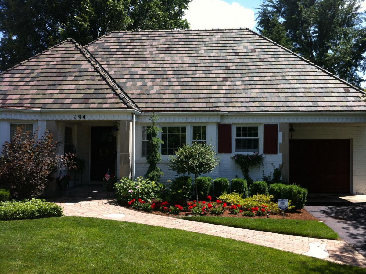

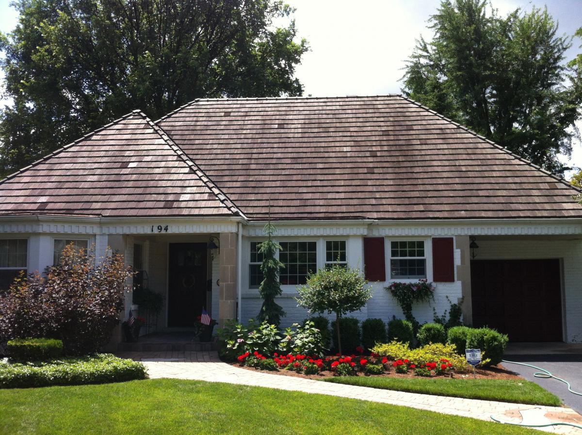

We cleaned our first glazed tile roof and with great results as you can see in the photos. We used a 50/50 mix with Gain in addition to Ammonyx LO.Even with the extra surfactant, the solution would quickly run off the tiles. These glazed tiles are smooth like ceramic tiles found in a kitchen. So we applied three light coats of solution versus one heavy coat that would have just ran into the gutters. This gave the solution plenty of time to set. I think we could have stopped at two coats and I'll try that on the next glazed tile roof. We then rinsed in which the algae, lichen and moss came off quite easily.

looks like a brand new roof DAVY
excellent job ,
EXACTLY, great point. I wouldnt have used a 50/50 mix, however the point about doing light coats and allowing to set was dead on. Congrats, you don't get allot of tile roofs up your way.
Watch going too hot on your mix with glazed or slurry coated tiles. The hotter mix can etch or remove the glaze.

Thanks for the compliments and the advise AC.

Great job
