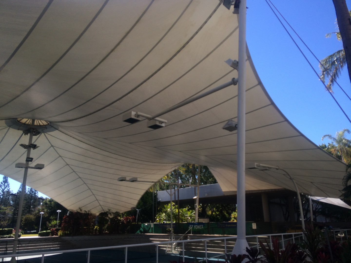

Was hoping I may get some insight into how you guys would tackle this giant sail clean. The material is Canvas and as you can imagine pretty hardy. The client wants it cleaned top and bottom. Access from underneath is ok with scissor lift although it gets tricky over the coffee shop and amenity area.
What solution would suit the clean. What ratio mix?
Anyone ever done anything like this and how did you tackle it.
Any advice and assistance is gold so thanks in advance.
Hey Nick,..first thing I'd recommend is walking away,Ha,Ha,...

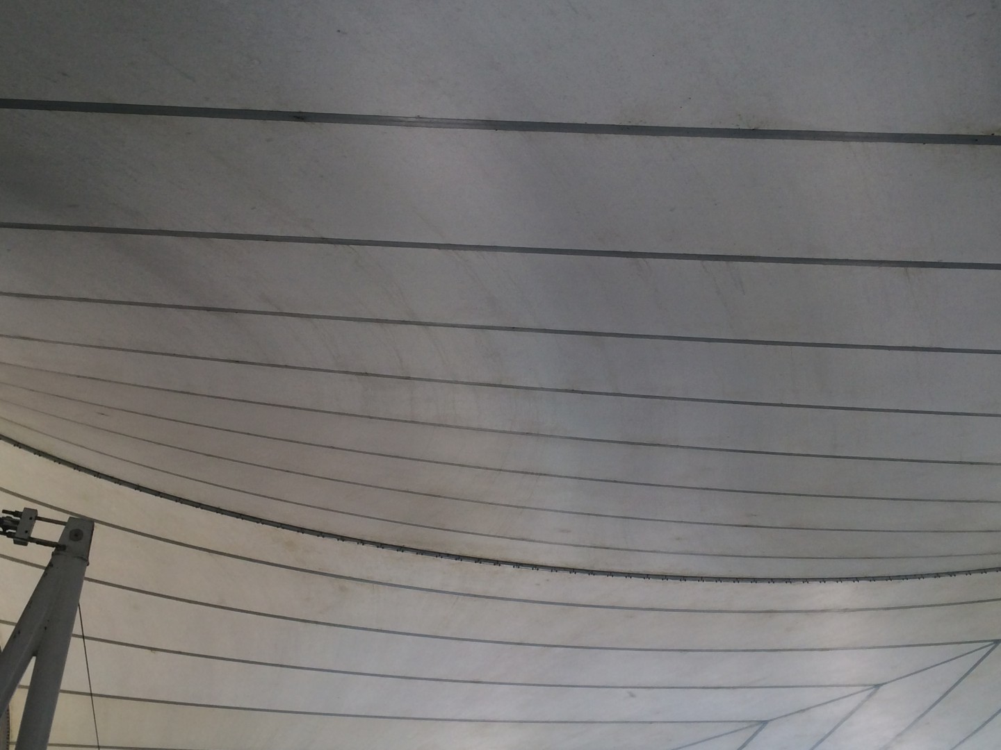

Then determine what's on it you're trying to remove,..I'll assume basic mold from the first picture. Then I'd advise a test spot with whatever cleaner you try to use on the least visible spot.
Try to do this job on a cloudy day,..it will allow your light mix to stay wet longer and work.
Having done many awnings that were moldy,..the use of sodium hypochlorite was always needed to get acceptable results.
Then I'd probably use a 1% sodium hypochlorite solution and see where that gets you. Slightly increase strength until it seems effective enough to work. Instant results on awnings and sails aren't a good thing,..you don't want to weaken the material or threads anymore than you have to. So a 10-15 minutes wait time isn't a bad thing. The addition of a soap may be needed,..but try to keep it to a minimum or you will be rinsing forever. And speaking of rinsing,..high volume and low pressure is the way to go.
Then, tell the customer to have it cleaned on a regular basis and you'll most likely be able to get away with using Sodium Percarbonate.

Thank Jeff,Hank, Michael and Dave.
The advice is very welcomed and I take on board the need for a low (1%) SH.Also keep the soap to a min so the rinse is a bit easier.
Test sample section needed also. Great advice.
