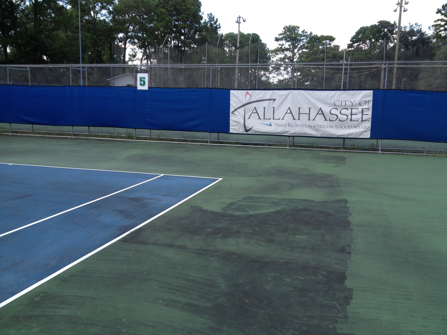

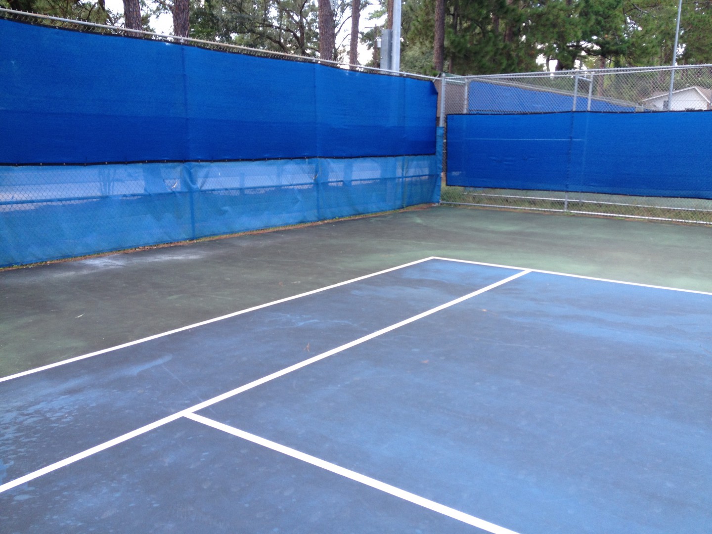

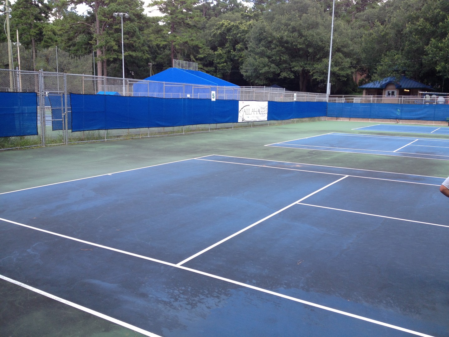

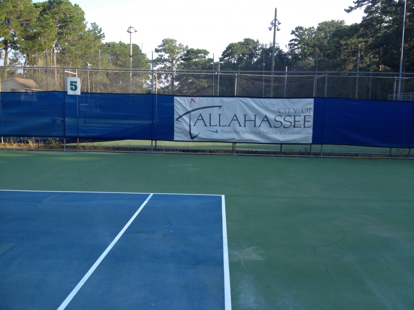

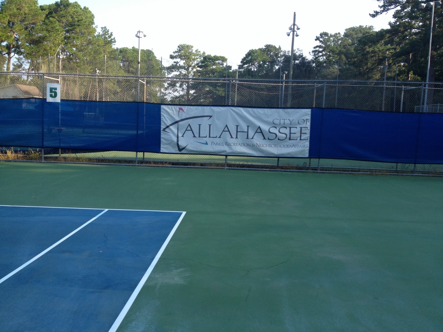

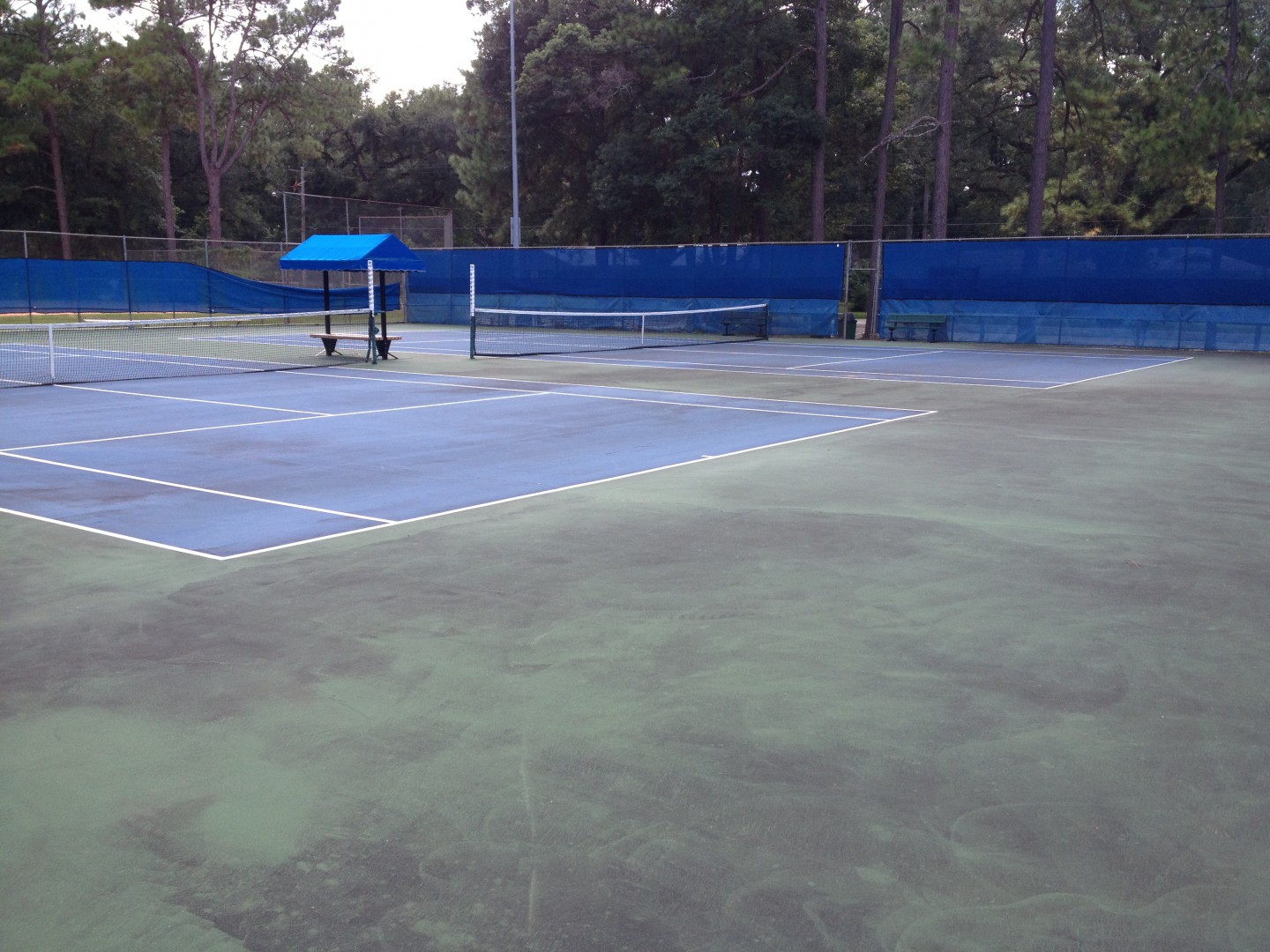

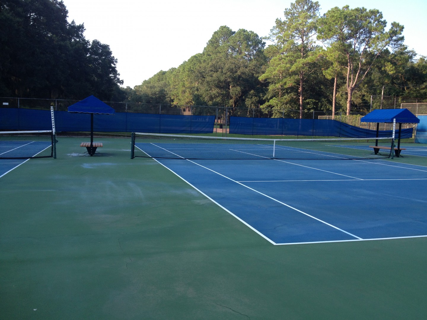

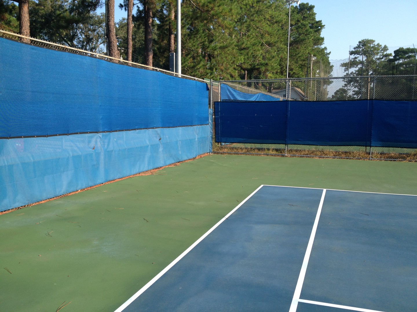

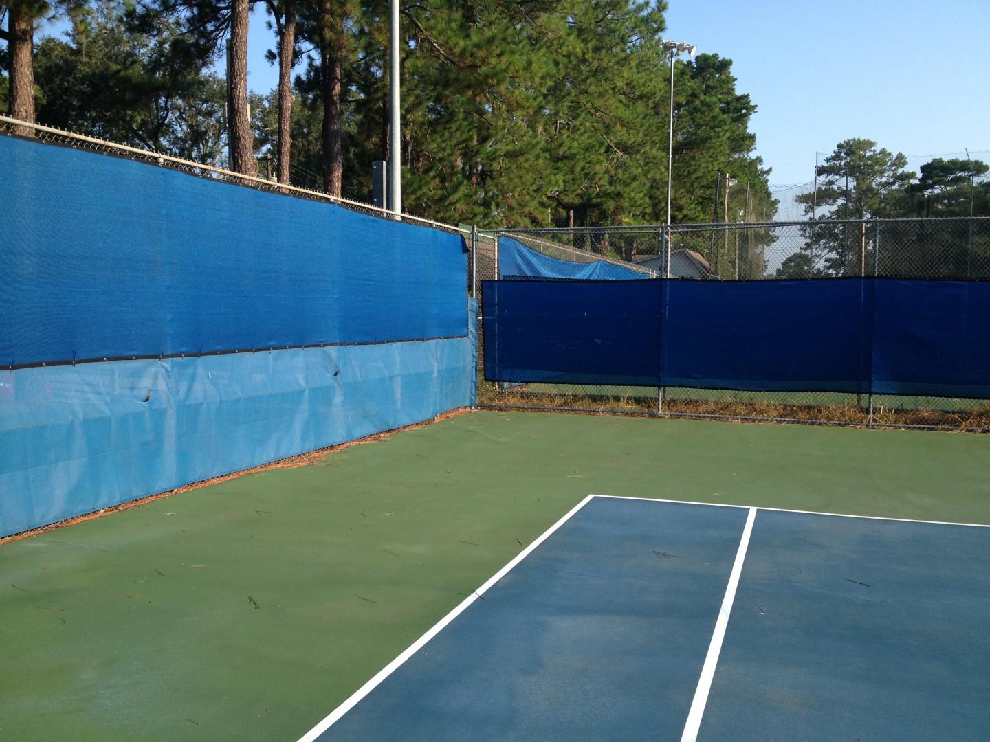

here are some that we did last year. These are concrete with a sports coating on them.You can see where someone previous attacked them with a PW. Cleaned up with 20%
