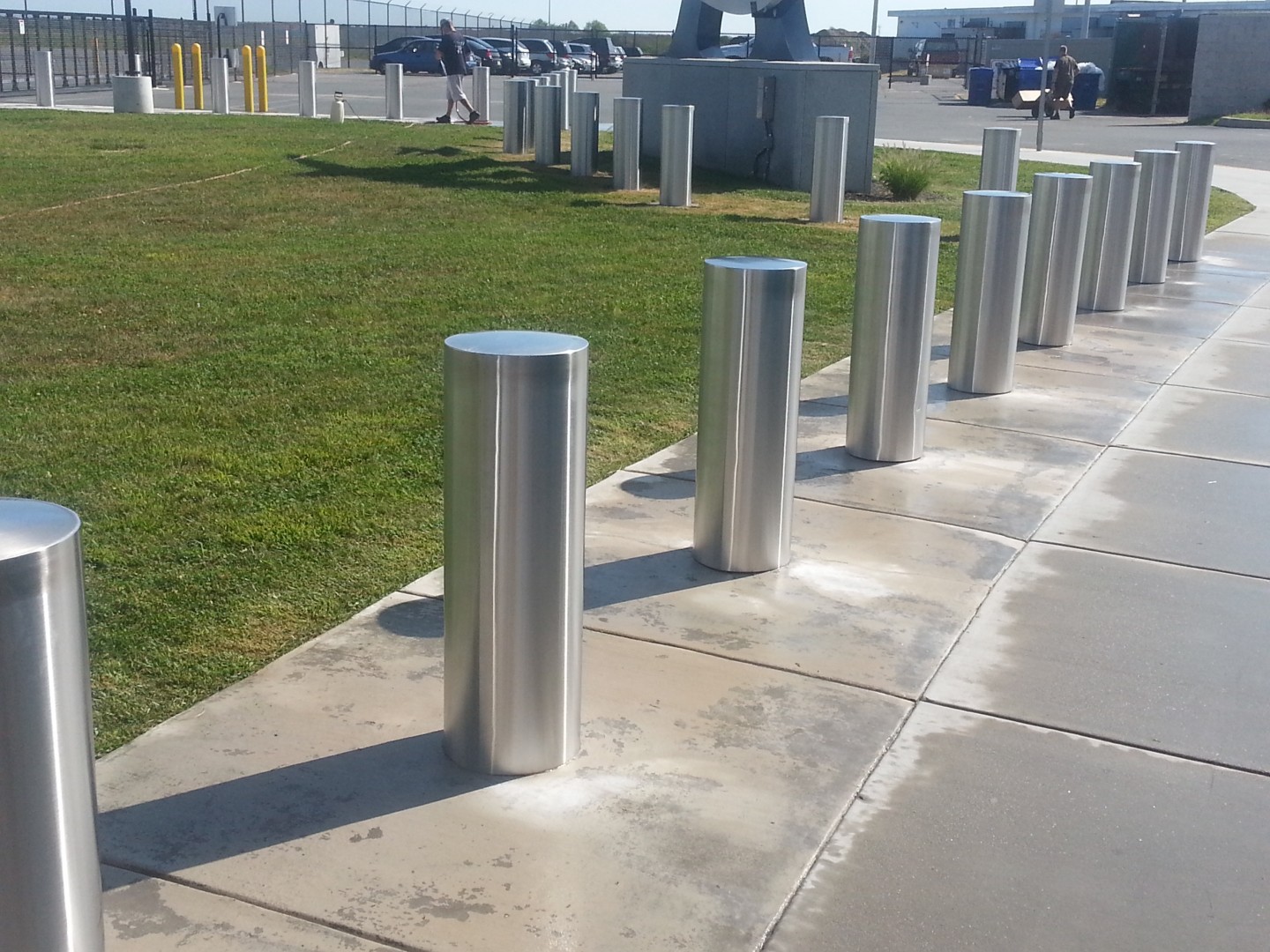

Roof Wizard was contracted to remove the rust spots on 145 Stainless Steel Ballasters at the Atlantic City International Airport. The cause of the rust is from excessive use of calcium during the snowy winter, this past year. We used F-9 at a 3:1 dilution and pretty much only needed one coat in most areas. A couple of bad stains needed multiple coats and some light agitation. The airport management was very pleased with the results and happy we only took four hours to complete the job. No disruptions or complaints, even directly in front of the terminal main entrances.
