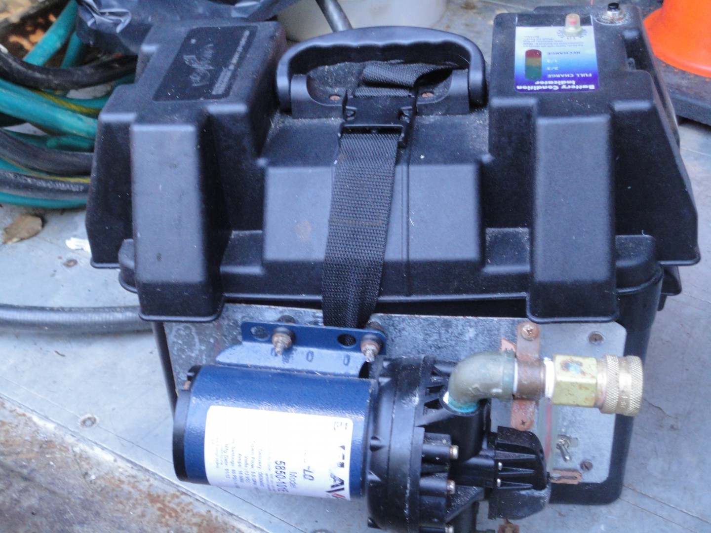

Eric I'm sure you hava a battary in there somewhere. Try to make a braket to add a small pump to the side of it. Something like this sidewinder. I have this hooked up to my soap tank.
