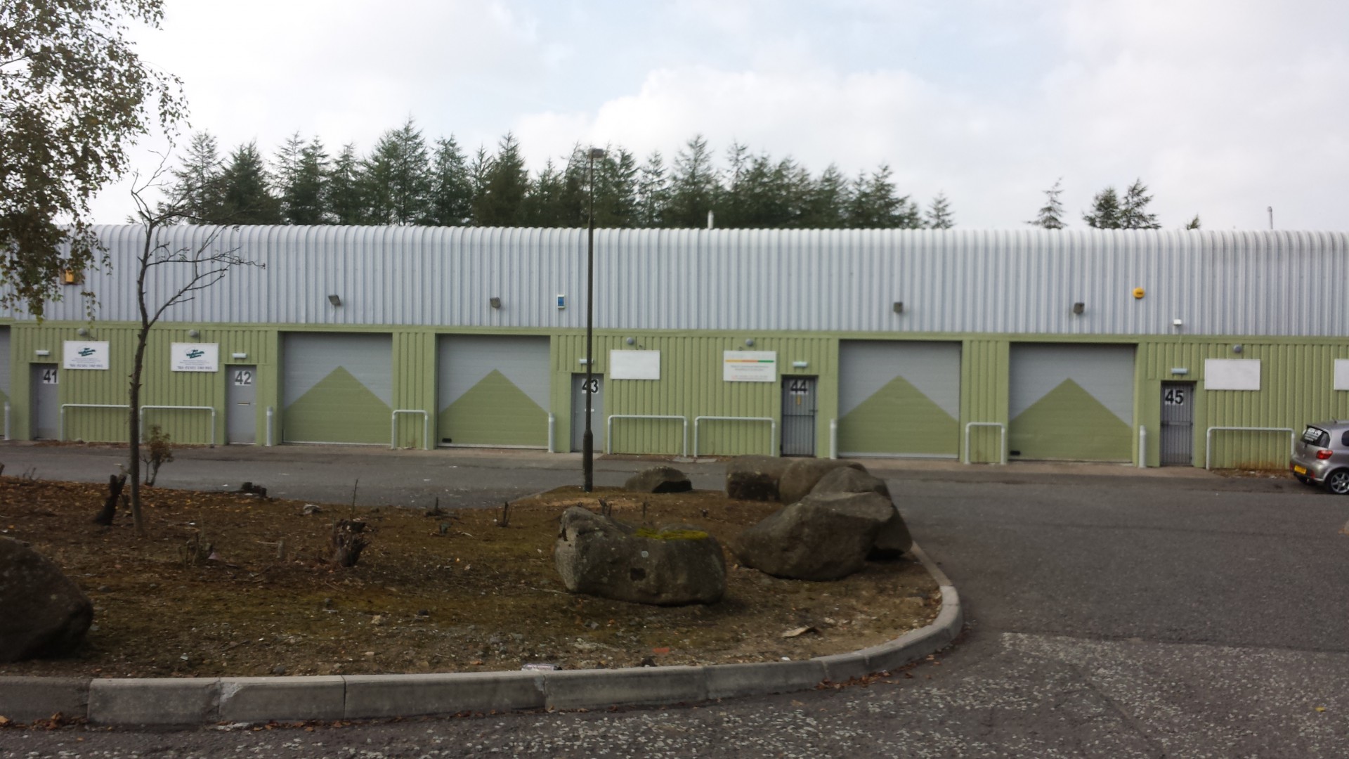

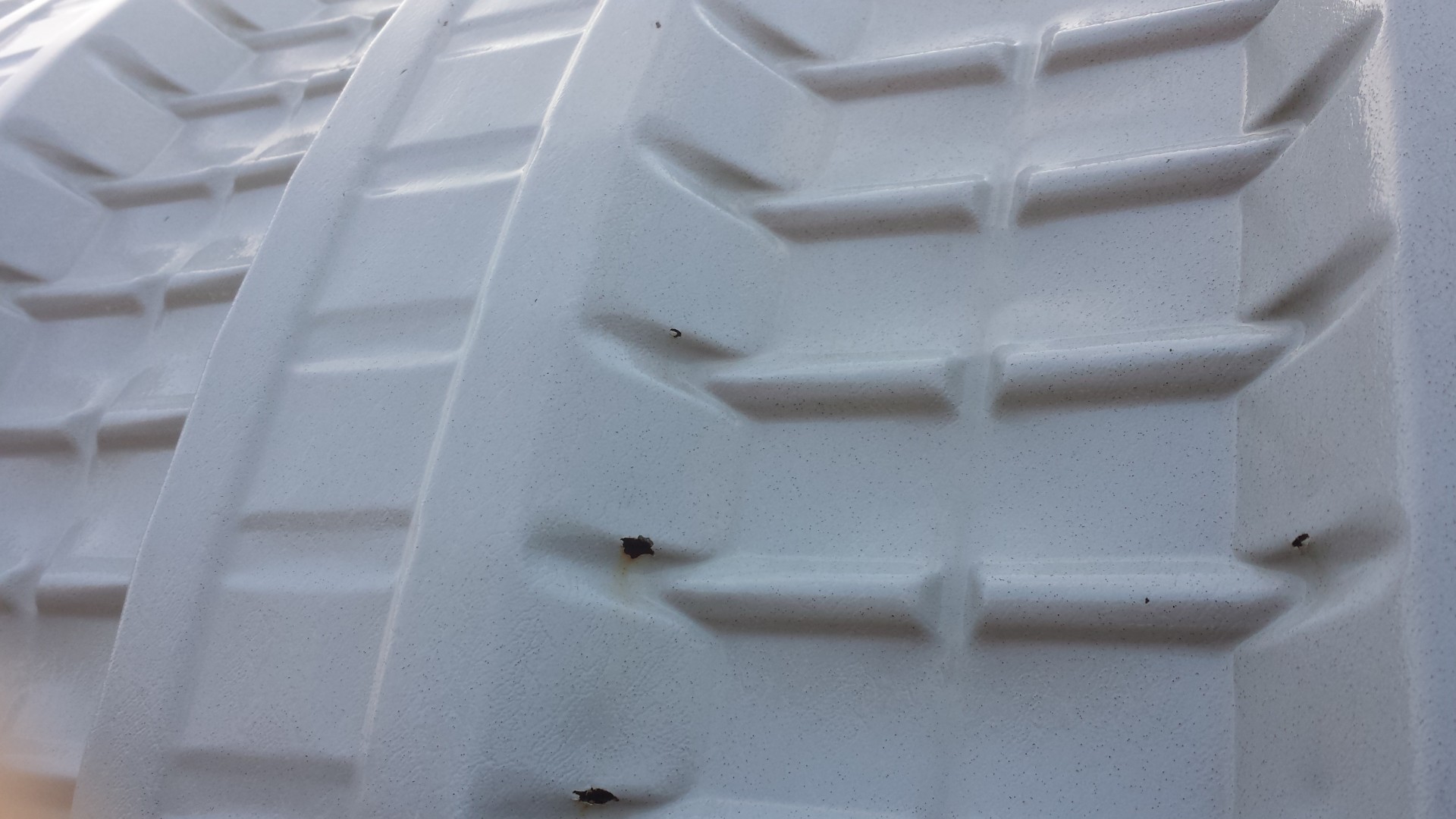

This is the job tomorrow a bakery roof and a footpath at the back, I did not take many photos just a few of the little bit. Aye softwashed and rinsed off with the hose out the bakery just to show how little pressure we need to wash metal cladding. Jim the baker was impressed aye am the same but a try to hide my wow factor now. Here is the pic aye took to show Jim the baker.
Any advice on a mix strength would be good ,all be applying it with my new pump got last week from pumpmasters livingston £346 and some zoflora sent to mask it a bit works great no real smell of SH at all just lavender or country fresh which is tomorrows choice, all they had at the local shop. l will be using a 50 gallon tank if my maths is right 200 ltrs tank to mix up in and be the rinse off buffer tank at the end also tomorrows photos may make you wow with how bad it looks at the back of the bakery unit.

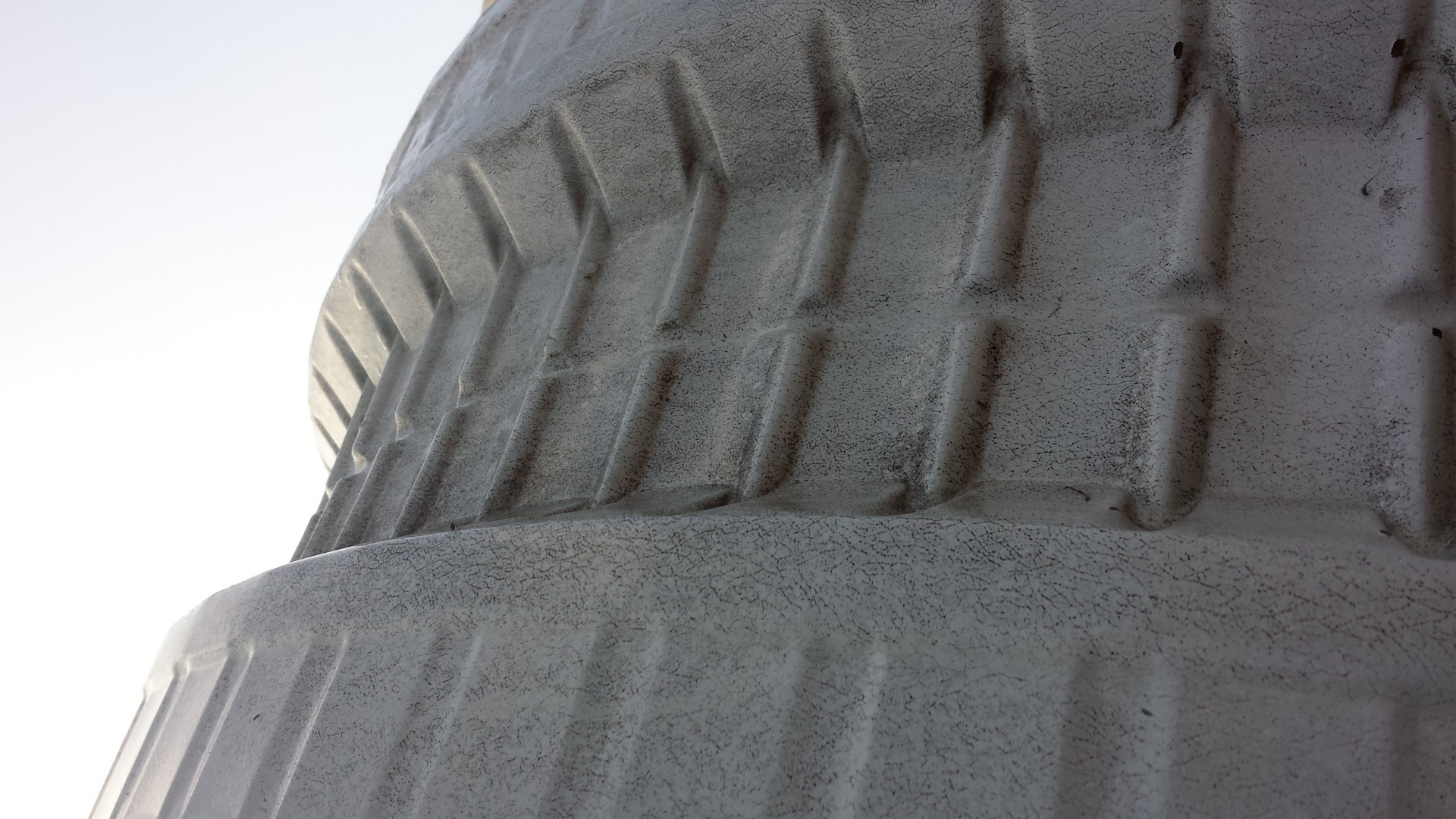

I have noticed that anywhere there is fermentation going on there is always a concentration of ?.
I'm not sure if it's GM, but it looks like it and responds just the same to the juice. On Costco's, the area above the bakery vents is always black. I did a winery awhile back, it was all black.
