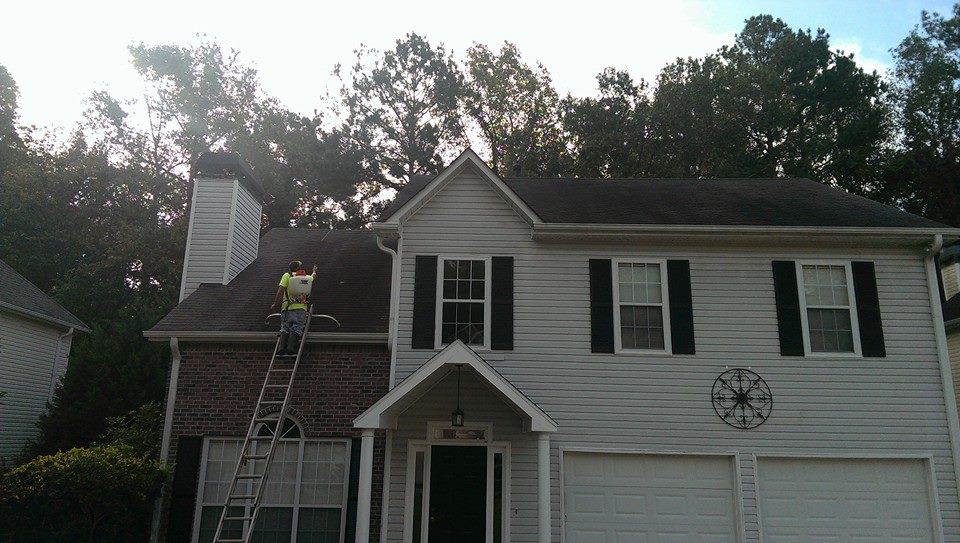

We shoot from the ground or a ladder
ladders 16’, 24’ and 32’
Too many ladders to carry. I would not personally buy a 16'. We carry a 21' on the truck and have a 32' that we bring only when needed.......
ladder stand off
The best investment in your safety by far!

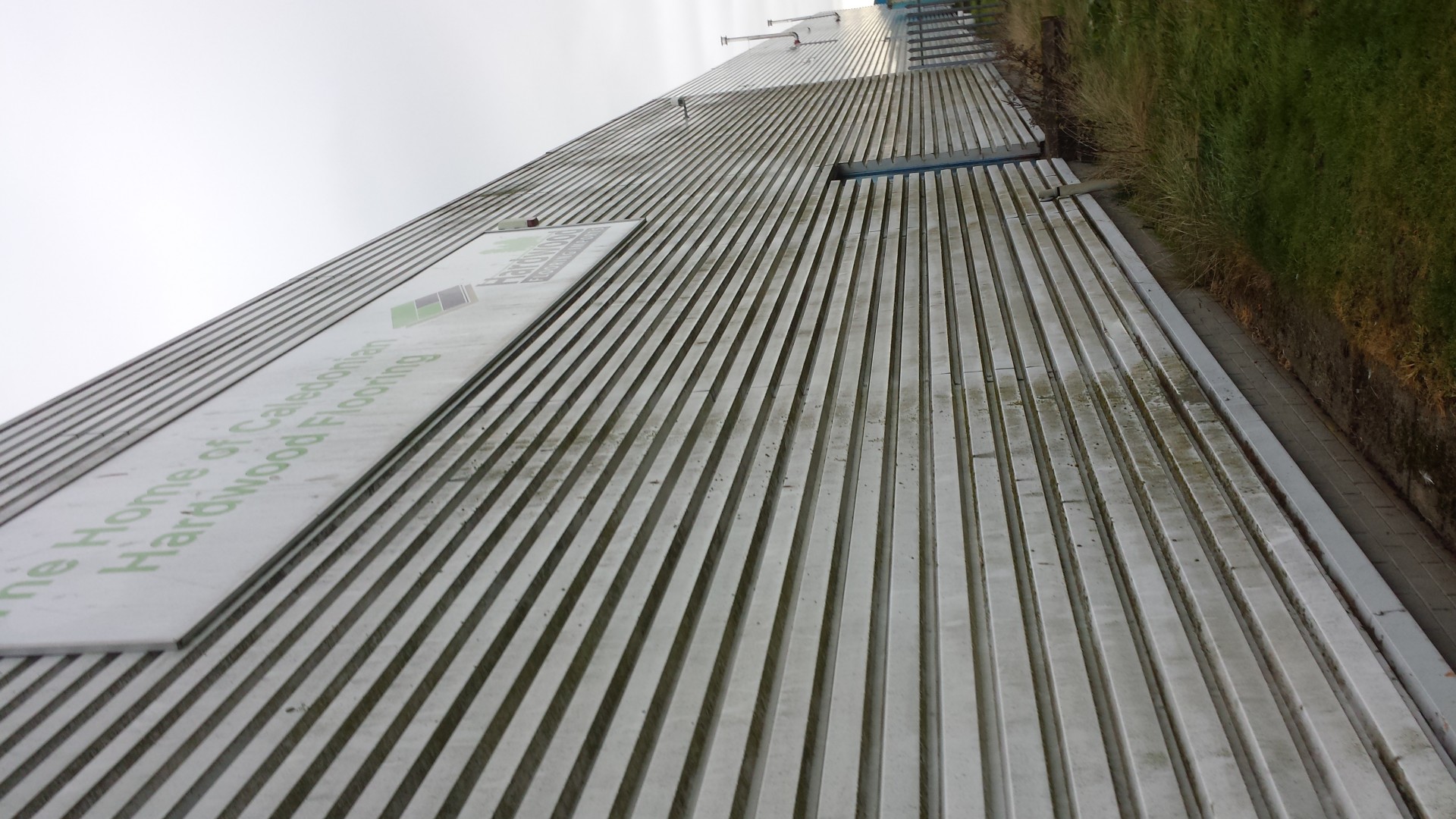

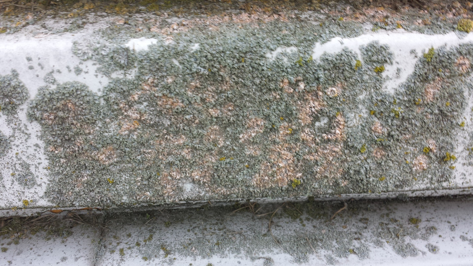

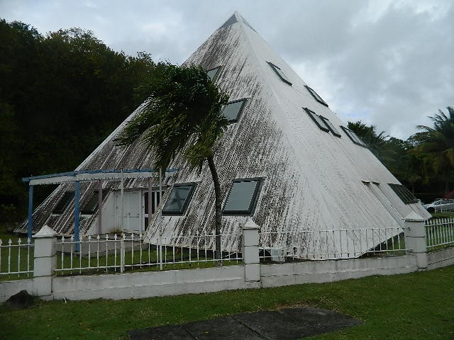

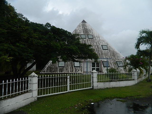

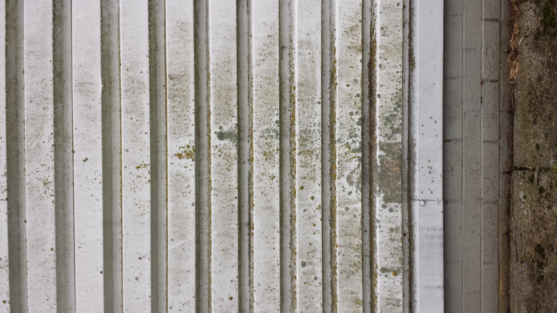

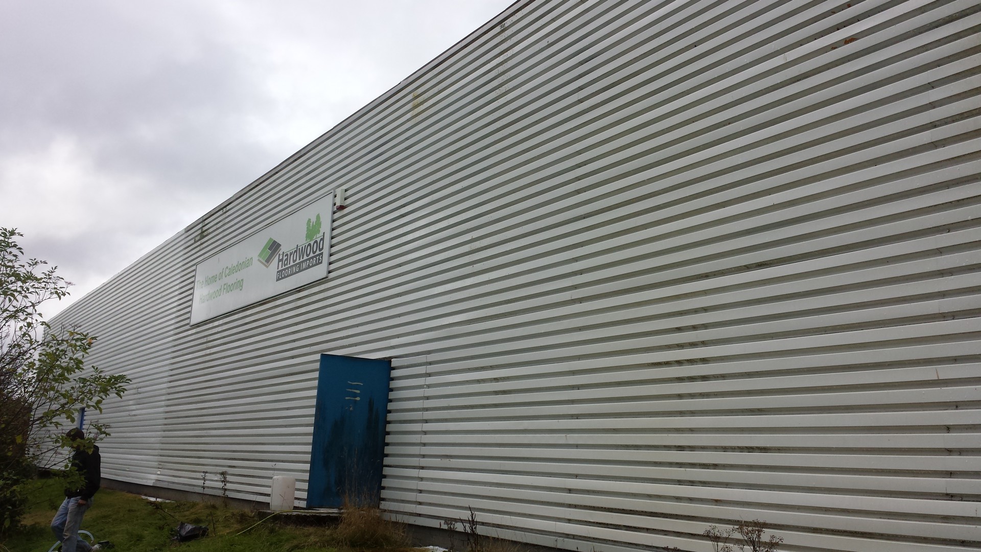

any suggestion guys... this is the entrance where visitors come in from the skips..
planning on renting a pressure washer and a ladder with a 250 gallon water tank
Enrico you need to get yourself a 5850 Delavan pump and build yourself a set up to softwash. All you need is a car battery, Garden hose,1/8th hose barb and a garbage can for a tank. Then you can soft wash that building.
-- Edited by Art O on Sunday 12th of October 2014 02:27:08 PM
Oct 12, 2014
Enrico you could also go down to the boat yard and see if they have a used bilge pump in one of the old boats.
enrico said
Oct 12, 2014
ok i'll find out from the boat guys at the marine police.
Oct 12, 2014
Soft wash all the way.....that is metal....isn't it?
enrico said
Oct 12, 2014
yes it is!! but understand, am trying to get this cleaning without the softwash system.. seeking advice on different stuff i can use to get this roof clean...they need this clean as soon as last month, if u understand..lol.
Oct 12, 2014
Enrico that building looks to be about 60" up. How are you going to get up there?
enrico said
Oct 12, 2014
lay a 32 feet ladder against the building with a footman stabilising it at the bottom..
Be cautious using backpack sprayers and chemicals.
Try a local agricultural supplier in st Lucia. you can use pesticide spraying pumps
Oct 13, 2014
Enrico you may be putting yourself at risk by climbing a ladder with a backpack sprayer. You will be more prone to fall back.
Oct 13, 2014
Enrico.....I think you can see that we all support you here. My concern is with your safety and your reputation. Sometimes it's just better to slow down. What I mean is; a backpack sprayer might set you in the wrong direction with some big players. Would you want to hire someone with no equipment?
No equipment also means no experience generally.
Contact the guys at the Power Wash Store....they can get you into a starter unit for under $2,000. I know it can be a lot of money but well worth the investment and well worth looking professional with professional equipment......then kick some tail and buy whatever skid you want!
ginty said
Oct 14, 2014
enrico sh will do the job quick just get a pump wheelie bin hose and a surfactant mix spray rinse if you want from same wheelie bin for instant results do you have a pump available or still searching , i had a little garden hose pump which is for drawing water from rain water barrels ,from local B and Q GARDEN bit £94.00 barrel £20 quid hose had that lying around ball valve or a spray gun for watering the plants ,and an extension lead to power the pump from the pyramids electricity , and yer jamming ,
