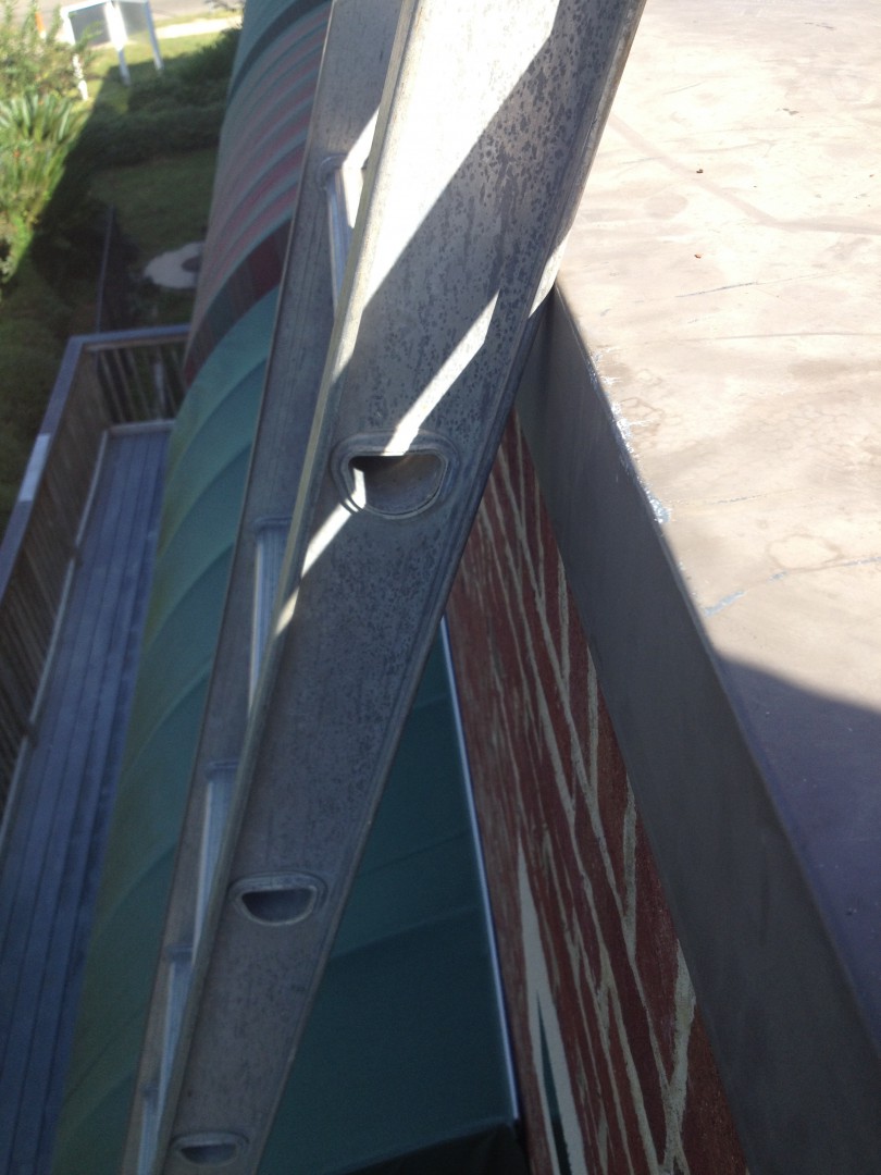

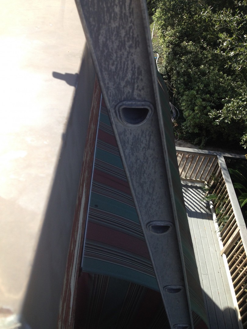

i'll take a photo in AM and upload
Oct 9, 2014
here is the specific critical point I was speaking of, its the metal ion metal rub that causes the slide...and the higher you are the more shifting occurs
Put your ladder standout down a few steps from the top and you should be fine
Oct 9, 2014
That looks like a tough spot with the rail down below not allowing you to kick your ladder out more.
I think a strip of rubber on each side of the ladder would help.
Oct 9, 2014
Ray,
As Doug has already pointed out kicking out the ladder would help. We use the 90 degree rule when setting up a ladder. Have the tech place his feet at the foot of the ladder and his or her shoulders and arms should be at 90 degrees. On decks we use a piece of wood with nails running through it to keep the legs in place.
A quick connect ladder stand off from Werner will sit right on top of the knee wall. In the past we have used this to gain access to the tops of gas station canopies.

Stabalizers all the way!!! The ladder in the vid had stabilizers.

What about magnetic strip. The same stuff as fridge magnets. You could make a simple angle bracket that stuck with a magnet that had a couple of keepers that stopped the ladder going laterally.
Just a thought.
I can draw something if you like

Could you attach a c clamp to each side of the ladder onto the edge?
