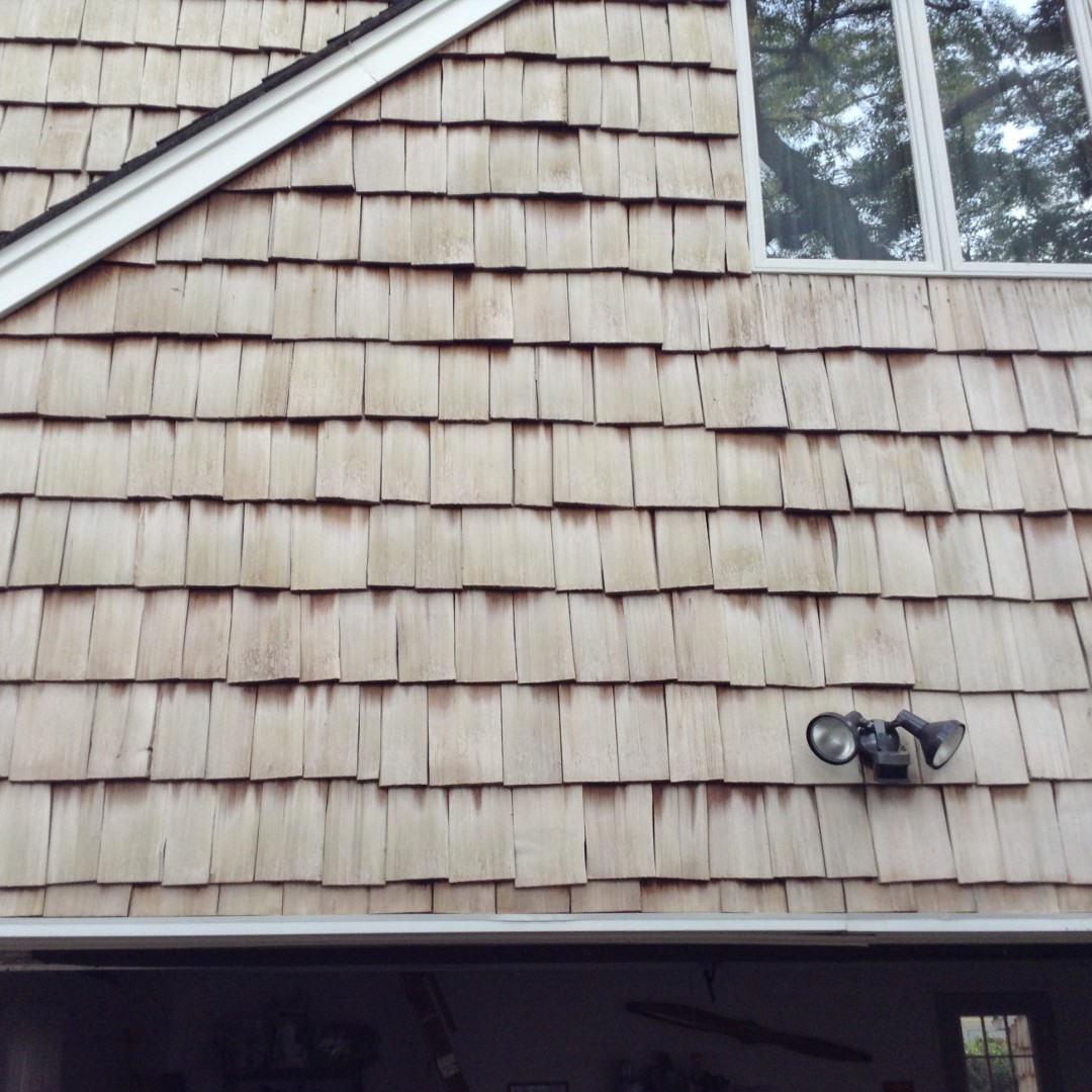

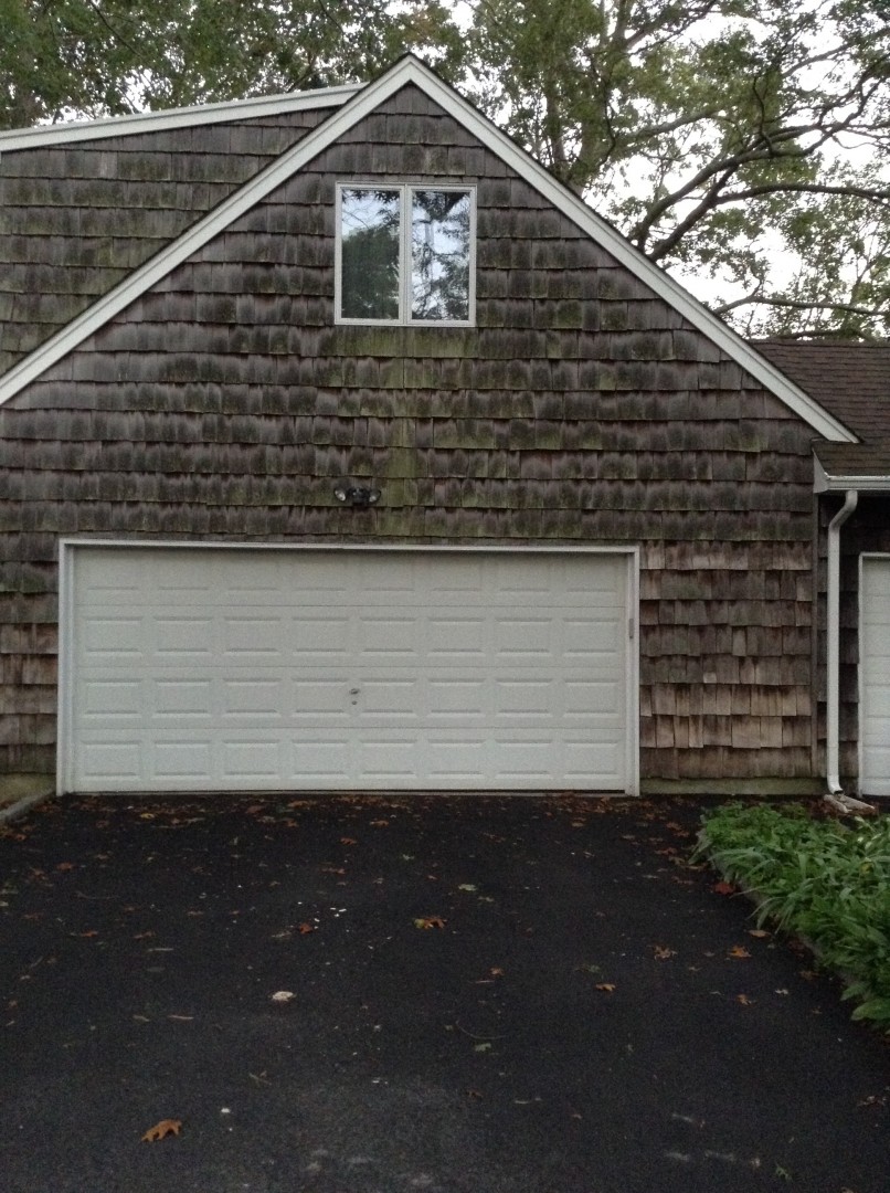

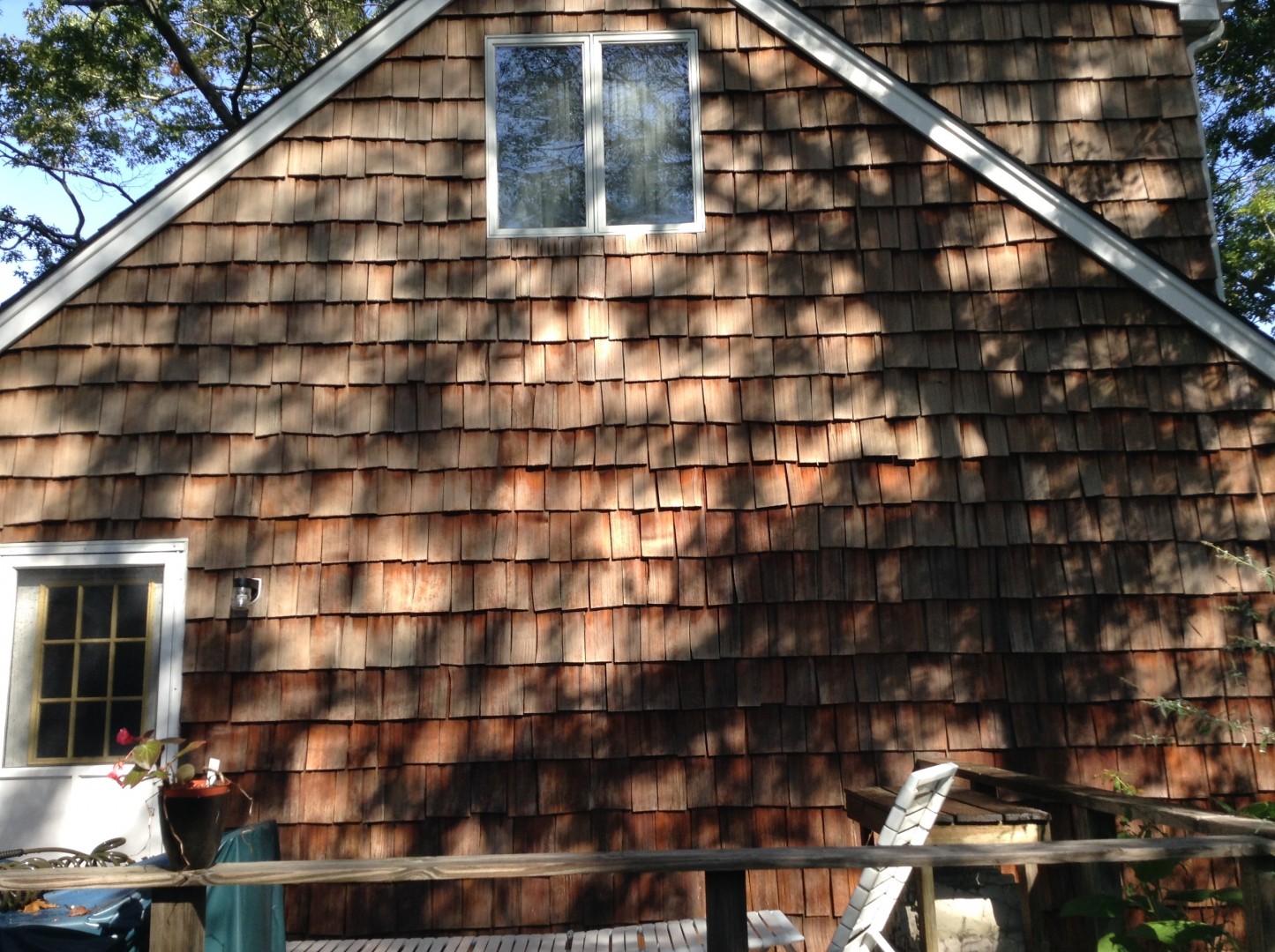

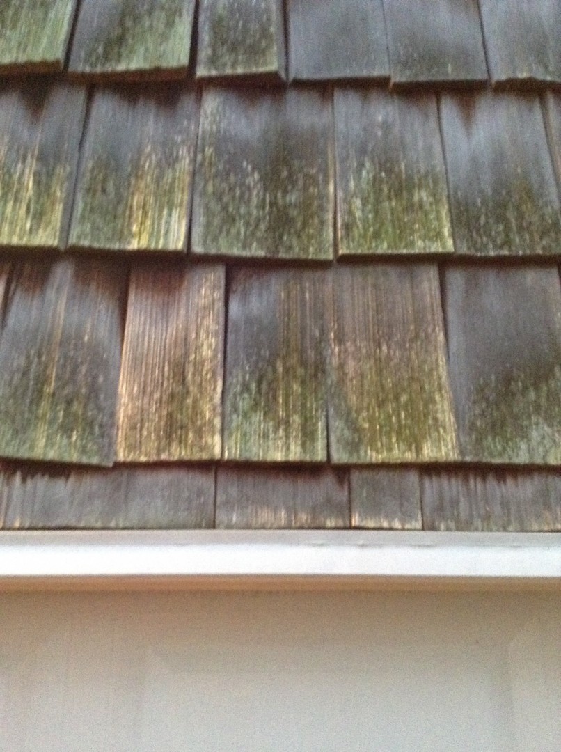

I am washing the roof of this home because his insurance company is forcing him to. They also want the algae removed from his cedar shake.....I figure I would use a weaker roof mix and I told the guy it would probably look like the bottom of photo #1. I said I don't seal it and he was fine with that...he wants it to seal naturally> Do you think a weak roof mix is all I need?
I would say around a 2% solution and maybe a little pressure to get the thick moss off.
Oct 9, 2014
I agree with Mike D.. We did a similar job back in May, which was just as bad if not worse. Plenty of rinsing was the trick for heavy moss removal and we neutralized it as well.
Oct 9, 2014
Thanks Mike and Hank. You think a lil light pressure from a power washer? Do you agree it will come out looking like the bottom shake in photo one or brighter?
Oct 10, 2014
A little pressure will go a long way. It will look better.

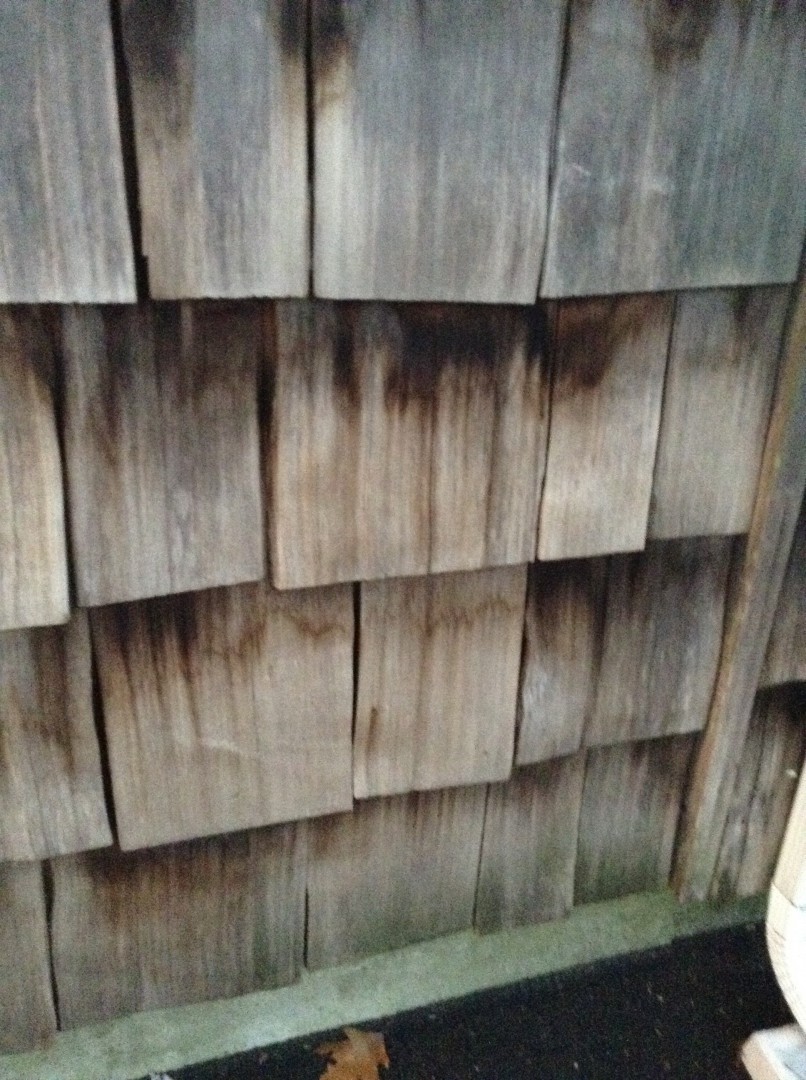

Weve done a few cedar roofs. Been a while. Wed. I did a wood deck with roof mix. Watched it change colors! There was a white film on it, i pressure washed off. Much faster than 4 stepping the wood.
gutterdog said
Oct 10, 2014
Also the wood was so covered in mildew, ya kinda couldnt see the deck. It blended in real well with the woods around it.

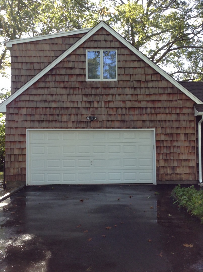

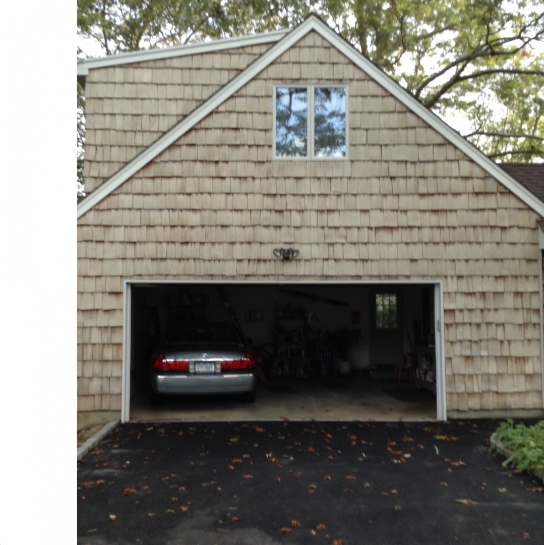

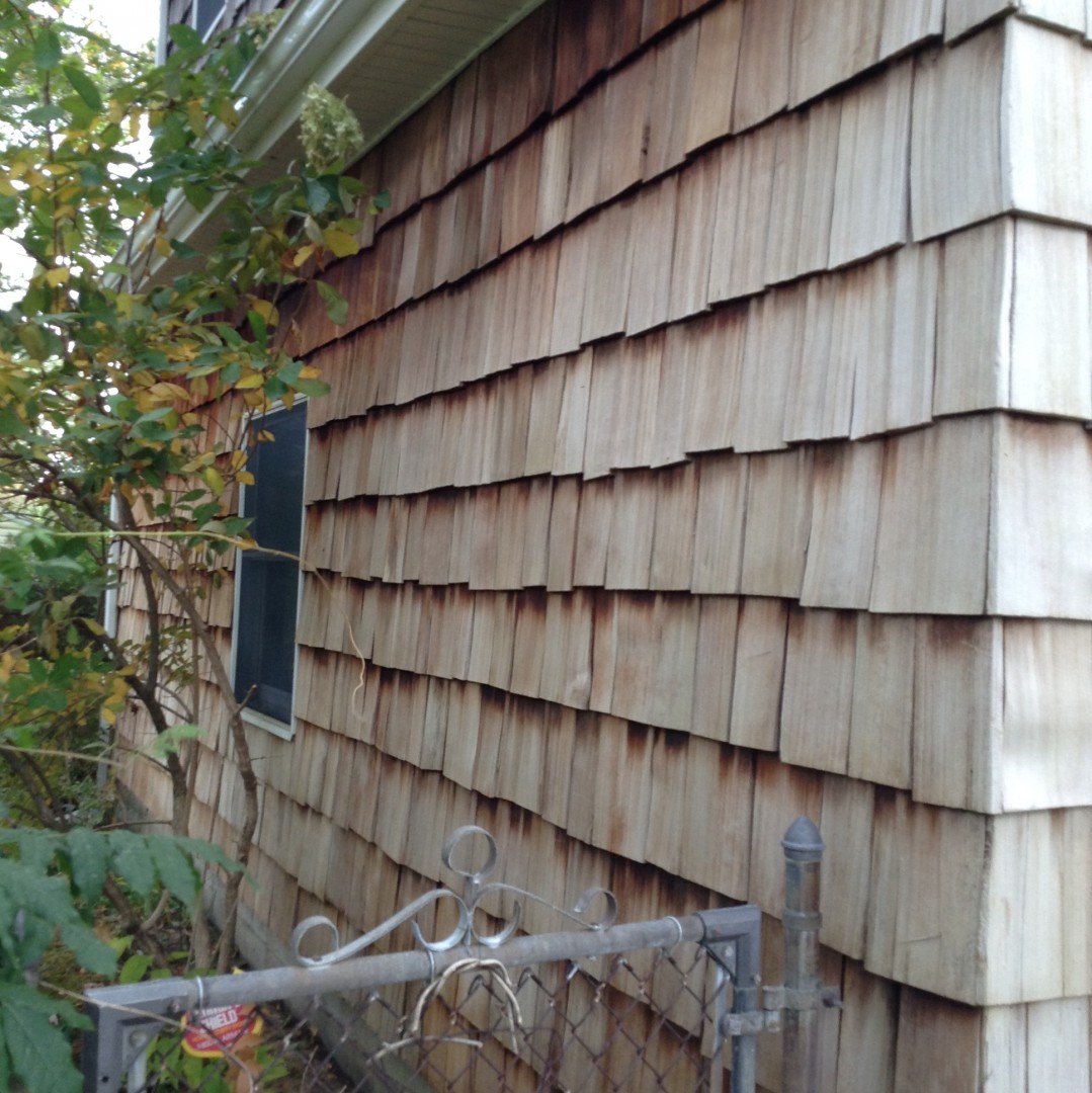

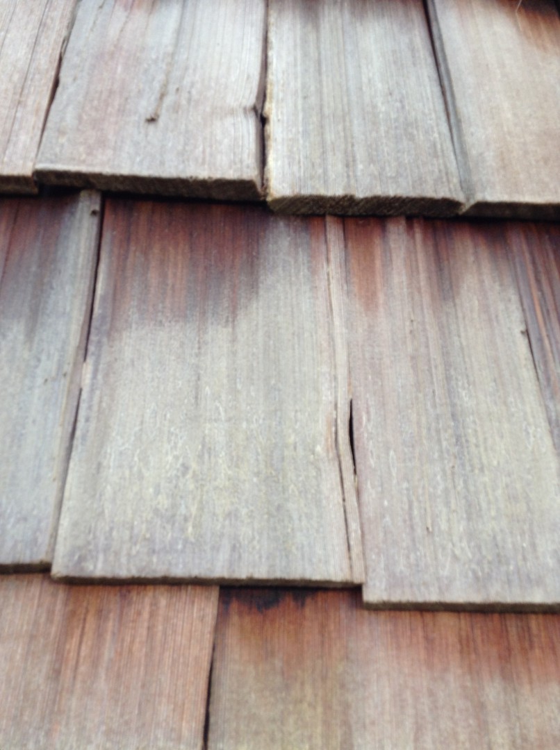

Ok a big thanks to Hank for some helpful hints on my first cedar cleaning. Another big Thanks to Art who provided me with the acid and watered down the property for me as well, and I thought I could do it alone. Now lets recap, I did this cedar for 3 Bills, he just needed the green algae gone for the Ins. Co. At the end I told him this would satisfy the Ins. Company but there was more of a process to prepare the cedar for sealing which he did not want. I rinsed down with a water hose only, I think I should have tried the PW I think it would have got rid of the stuff still on shingle in last photo? Or was my mix to weak? Any comments are welcome...Thanks....
I think if we would have made the Oxalic Acid stronger it would have turned out better. We only ha 10 lbs and added it to 30 gallons of H2o. Pat wanted to rinse, I didn't think it was needed. But it came out better then it was.
Oct 15, 2014
We use 12 to 18 ounces of ox per gallon.

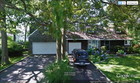

Hank that is the right house, but I only did the one car garage on the left.............
Oct 15, 2014

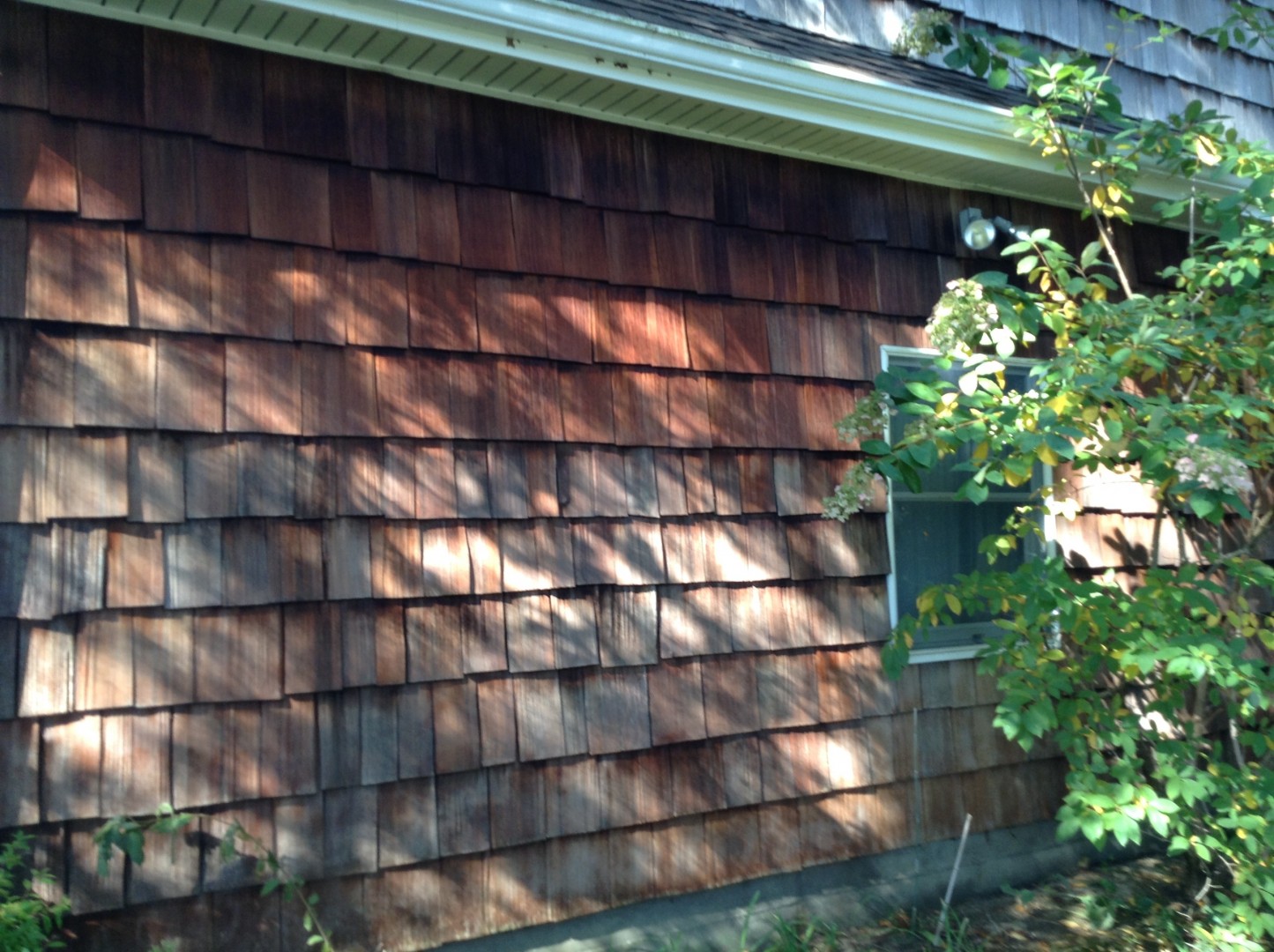

Ok so a big difference on the cedar shake from yesterday. Is this look normal or is it because I didn't use a PW for rinse and cleaning?
Thats what I said Mike! We only had 1/3 the amount that was needed.
Oct 16, 2014
Rinsing just didn't stop the bleaching effect. That's what the ox does.
Oct 16, 2014
Ok thanks Mike, I'll get it next time...if I have one. This is ok here he just needed for Insurance company. Next time the right Ox and a good amount
