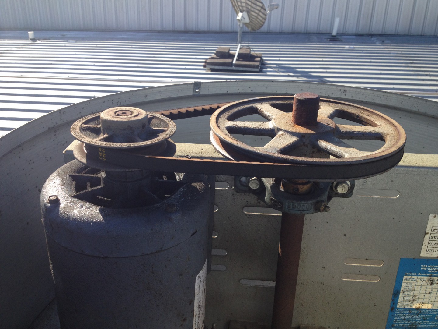

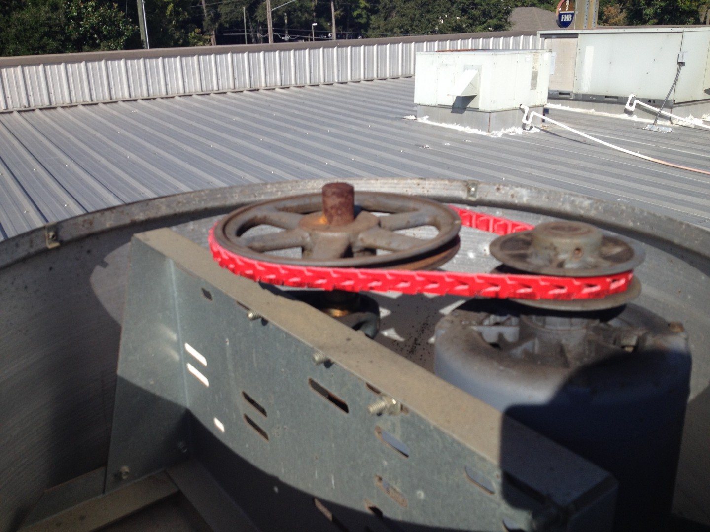

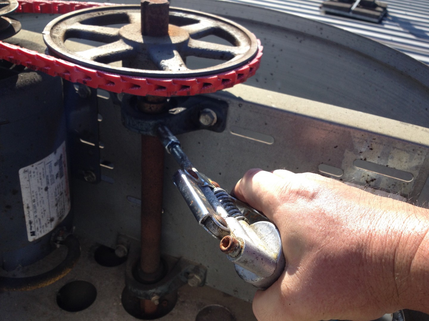

There are lots of little add on services when it comes to hood cleaning. Pictured here is a belt replacement and a bearing grease job. The belt was $125, greasing the bearings cost $75. I spent 20 minutes on the job.
I see you are using belts that you can make to size on the job. Keep an eye on them. these type of belts are meant as a emergency fix. They do not last very long. I have used them 100's of times in industrial maint. to get machines up and running until the proper belt could be installed.
Oct 11, 2014
Dave, i know what you're saying about those best, but I've seen them on Ventialtion fans that are two years old! Typically its only about a 1/2 HP motor so not putting too much stress on belt!

A re-greasing after a de greasing is good maintenance. Nice am still to give this a try. All be checking hoods as soon as aye can, see how hard and what's evolved in the job a don't see any one else here doing this service.
