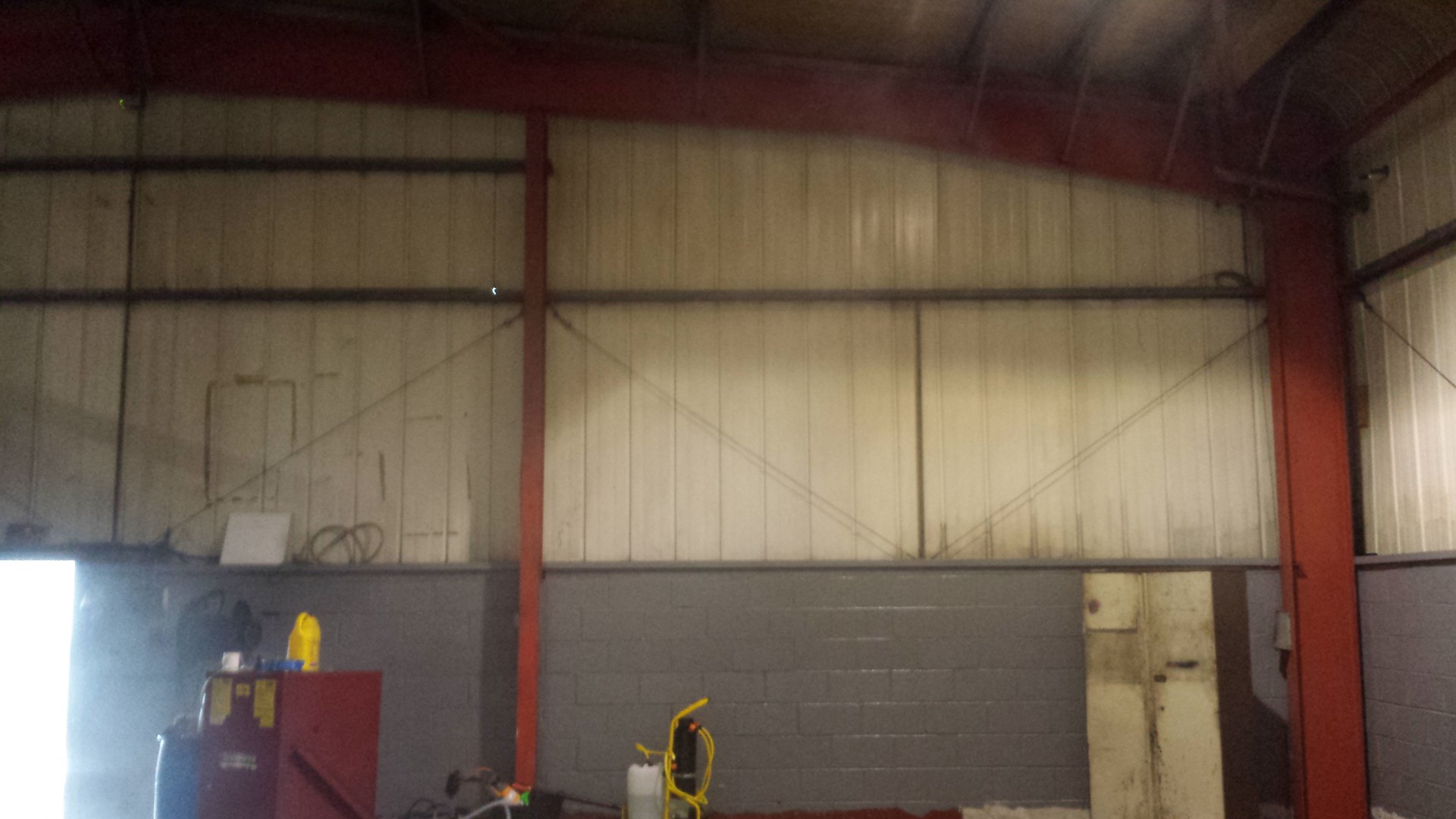

this unit is 30 years old it has been a small bus company s garage and is covered in exhaust fumes stains any advice on cleaning this carbon stain of would be helpful.thanks guys

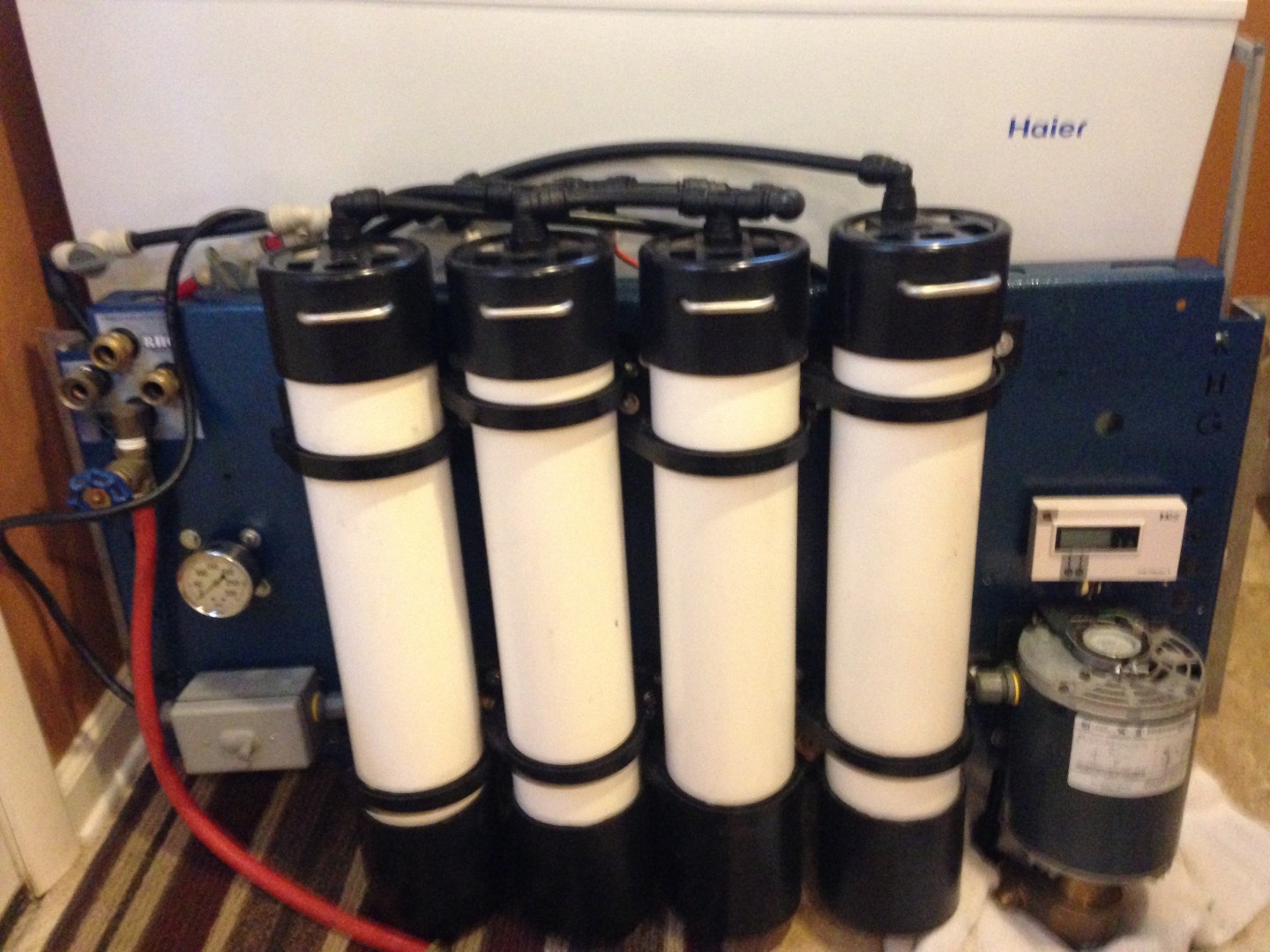

Apr 28, 2015
I have a barely used H2pro for sale if your interested Mike (or anyone else)
