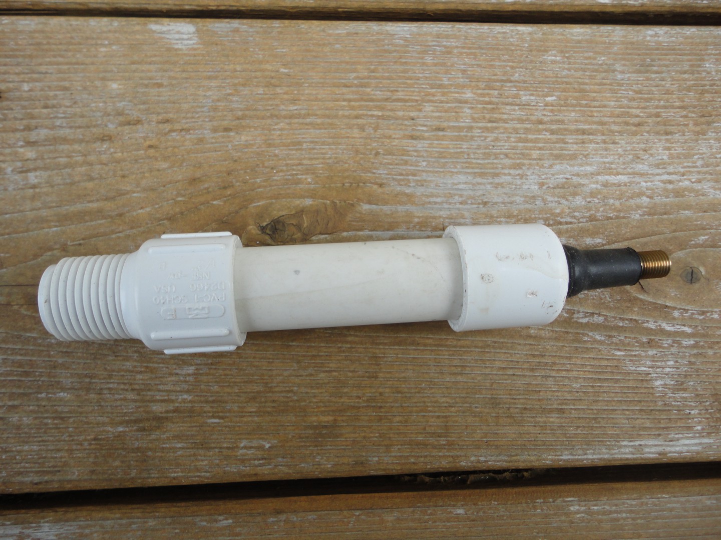

I use this for dry blow outs. I have another one, but I have to find it. This picture is without the brass fitting to go from course thread to Garden Hose thread.
Does this work through the pw pump Art? Or lines and hoses only?
Nov 19, 2014
It can go all the way threw pump and lines. I have another one that is longer with a T fitting and a cap on it. I blow out everything, then fill the tube with anti freeze and blow it threw again. I will get some pic's of it tomorrow
Nov 19, 2014
Found it, again you need the brass adapter from HD, Lowes or I think Bob at PT has it.
Art - is there a particular CFM that is needed to blow out the lines? I've been considering getting a compressor for air tools in the garage - might as well ensure it can winterize like you're doing as well. Thanks!

I like to turn the roof pump on and blow out the line. Then I fill the tube with antifreeze and blow it threw. You don't need a lot, the juice is already blown out of the pump and line. The PW I blow it out and shoot some anti freeze threw. I do it this way every year never a problem.

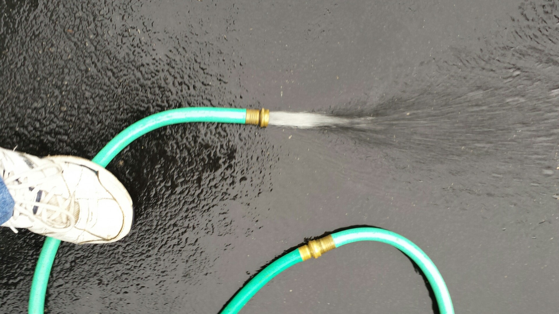

I winterize my rig this past weekend. I pumped the remaining cleaning solution out of the chemical tank and the remaining rinse water out of the rinse tank. I then dumped some antifreeze in the tank and ran the pump recirculating the antifreeze through the system. I then blew the water out of the garden hoses using the AC and the quick connect fitting shown in the attached image.

Art's setup is perfect. The only change I would make is to put an air hose quick connect on the end instead of the valve stem. My hands always got cold holding an air chuck on there. I like to connect the airline and walk away. Come back once everything is blown out.
Dec 4, 2014
That's why I included a quick-connect in my set-up. I just plug it in and let it rip.
Dec 4, 2014
Clip it on and walk away. Its all in the design of the build!
