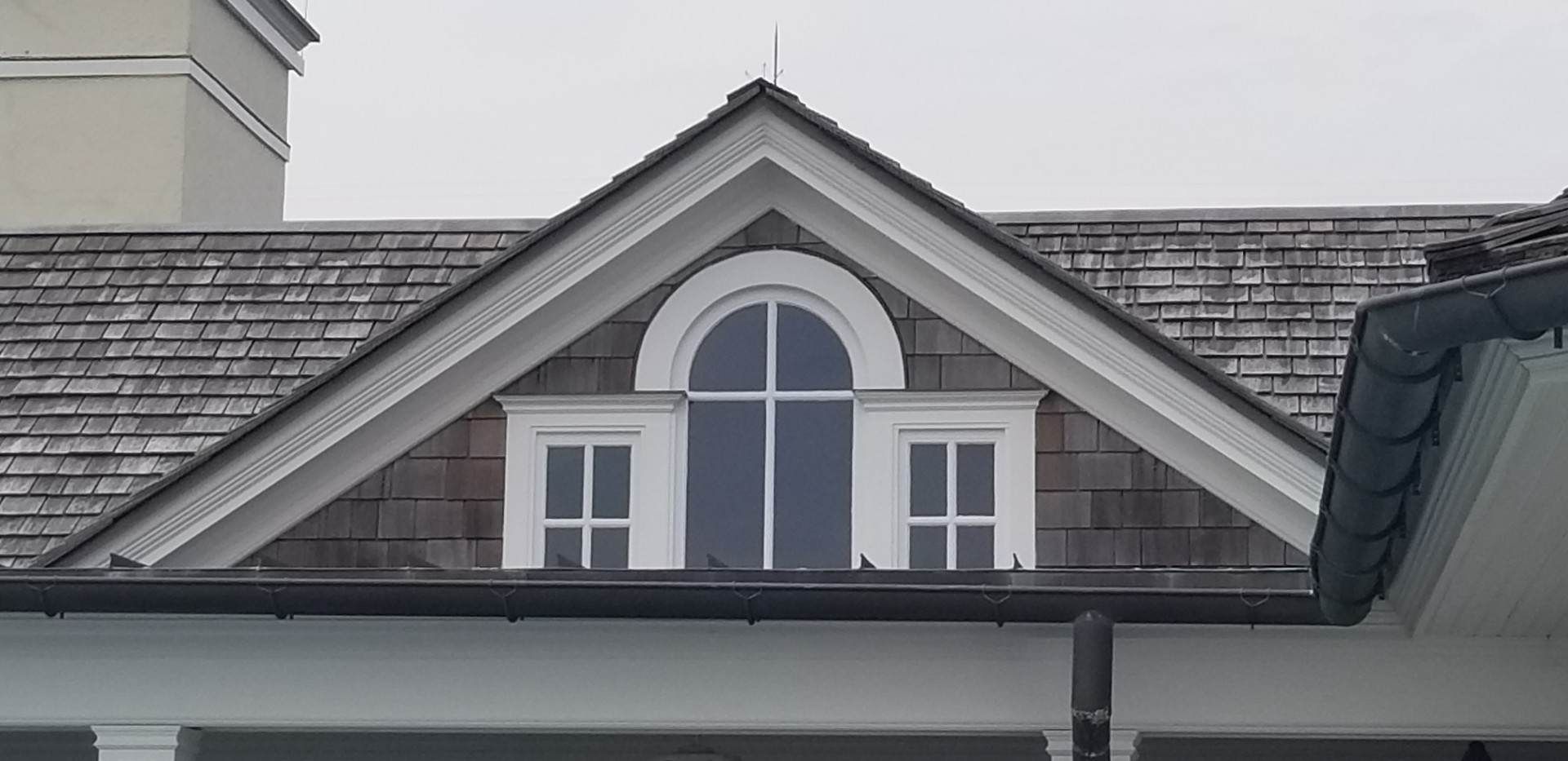

this property is only greyed out, no grime or growth.
May just percarb and then rinse w/o pressure as there are a lot of hard areas to reach.
My question is what ratio dependant on what the percentage of dry percarb?
8oz of 99% pure S.P. to a gallon or a lower % dry S.p.? and how many sq/ft that will do?

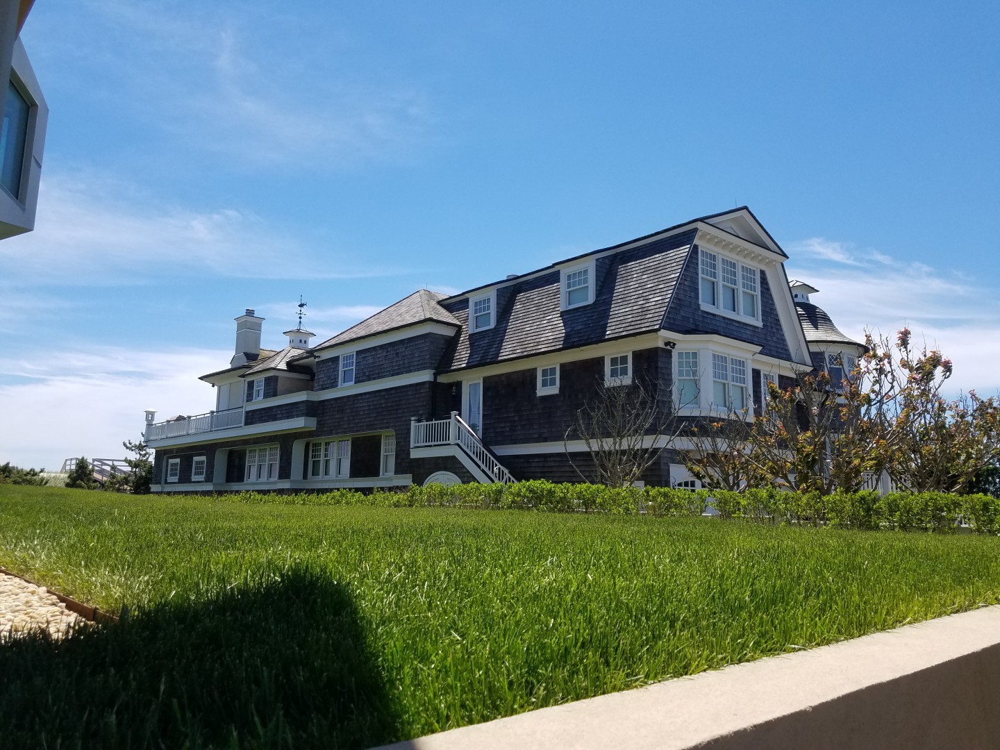

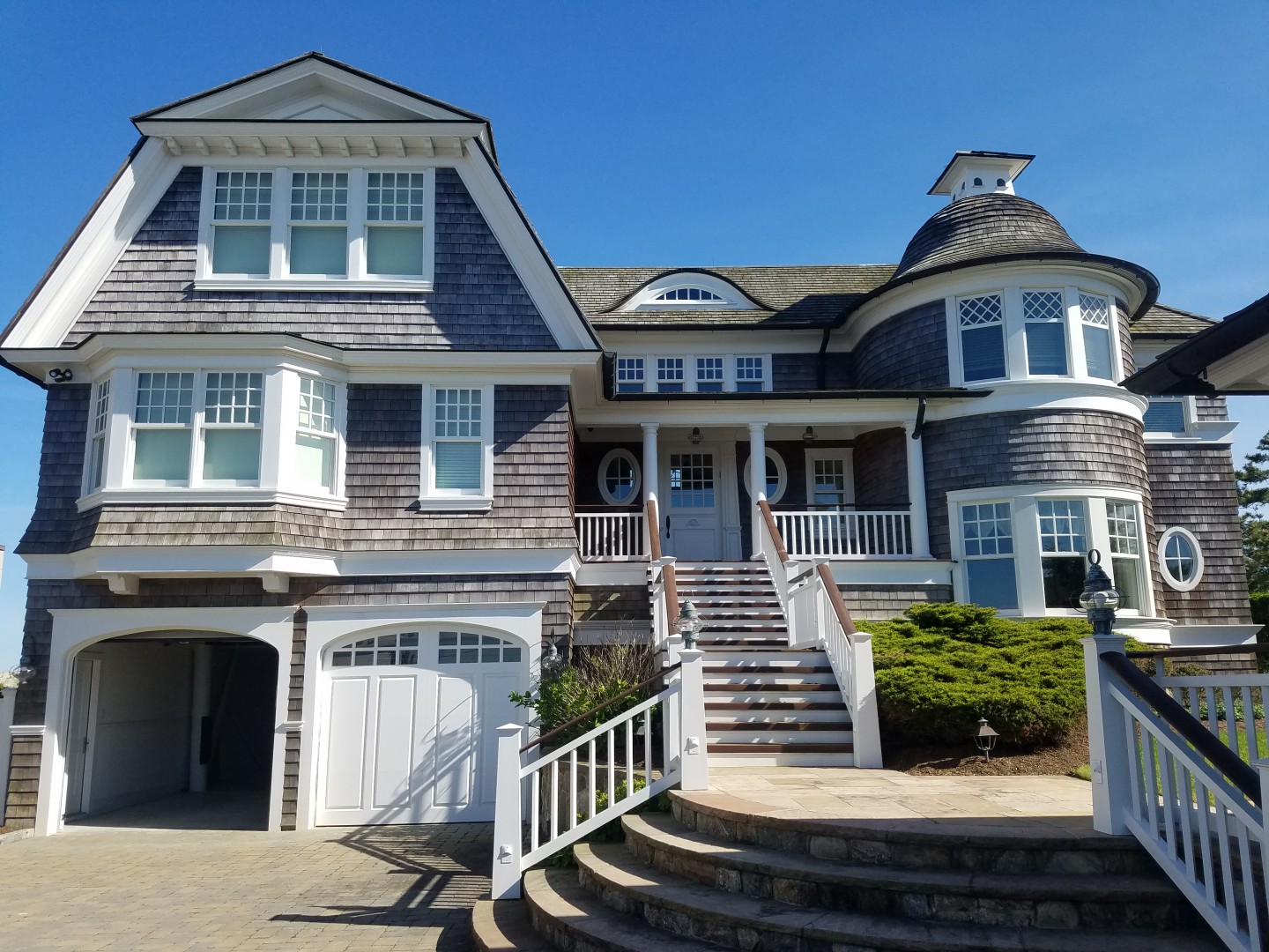

these are Hampton homes, the natural greyed weathered look is normal. Nearly every house is built like this. Its a $15 million home and that's cheap, many go way past $30 million and this guy keeps us busy 4 months a year plus another main home so if he wants something done my job is to figure out the best and most efficient way to do it.
Oh and as of last night I got the ok for an atrium lift or tracked spider lift which is another challenge finding just the right one! But will make it much easier.

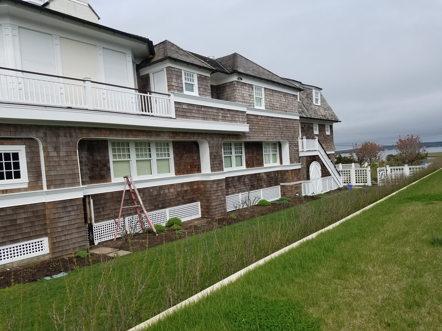

Its just weathered grey and even new shingles from window replacement 2 years ago are greyed so unless they are treated with a finish it's not gonna last.
first pic was may 2019
-- Edited by Maverick Contracting on Thursday 29th of July 2021 10:17:59 AM
