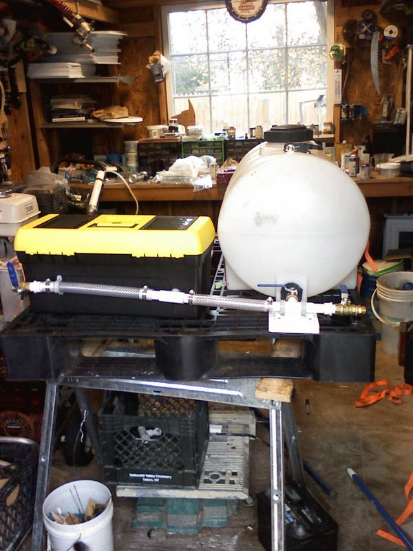

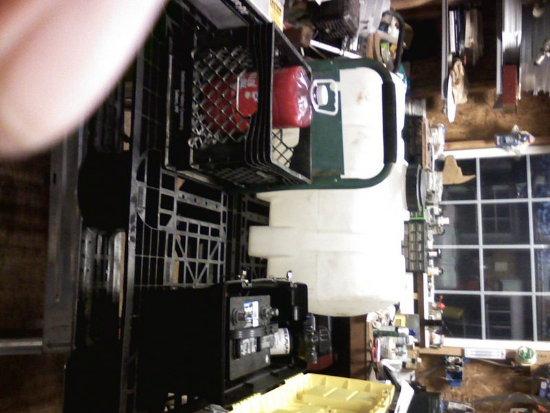

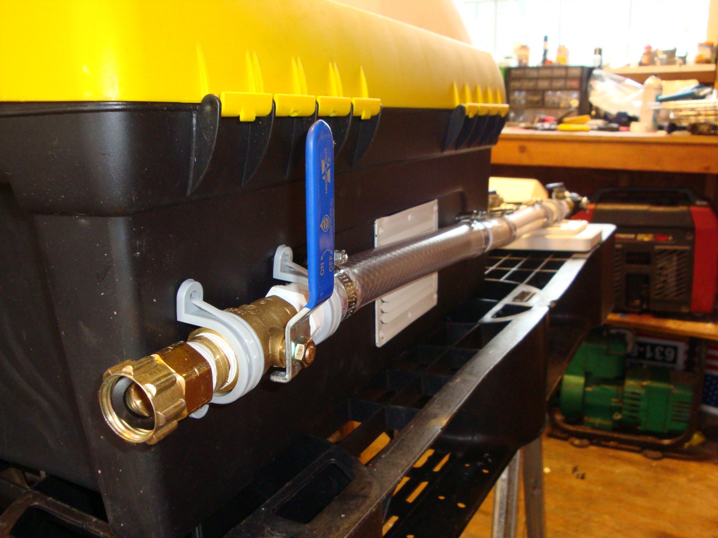

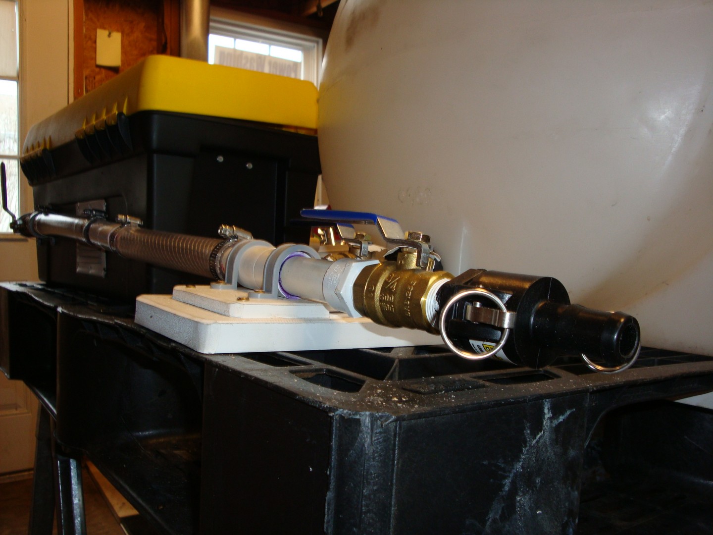

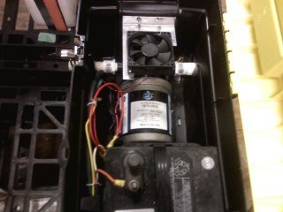

This is a skid I'm building. I had most of the part hanging around. It's portable and light weight. It's desighed to fit a Tote tank in front of it if needed. Yes it could be made better, but like I said it just stuff that I had hanging around. It's got a Fat Boy and a Batary in the tool box. The right valve goes to the Tote and the left valve is to wash out the pump or fill the tank. Dimond plate on top of the skid would be a nice add on and a double hose reel. I still have more work to do on this project.

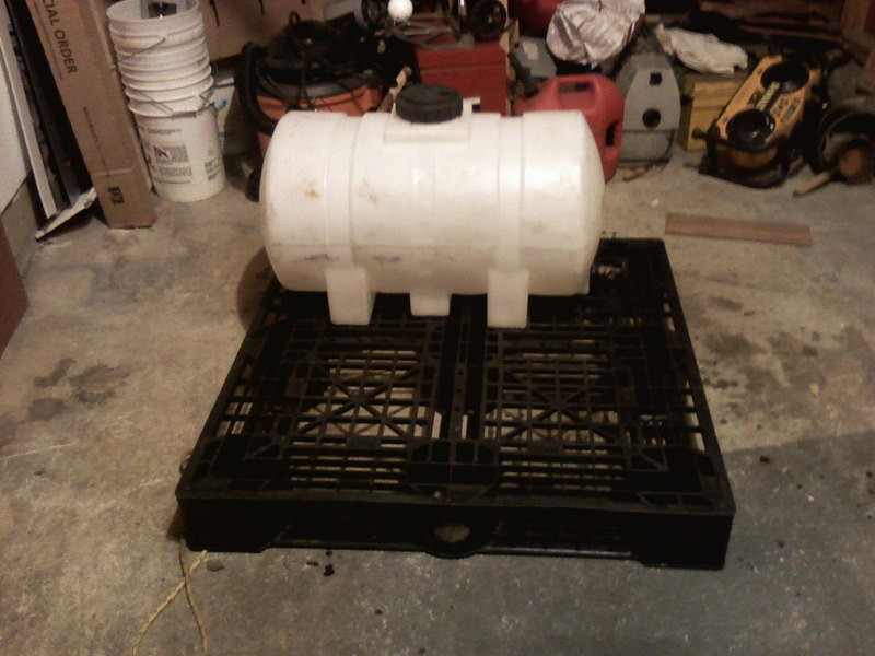

Looks good! Did you get that tank from the guy or place I rec co mended and if so how was the pricing?
I need to get a 100+gal storage tank.
Dec 3, 2014
Craigs Lists $40
Dec 3, 2014
Nice price.
How big looks like 10-15 gals.
Dec 3, 2014

Nice price. How big looks like 10-15 gals.
35 gallon

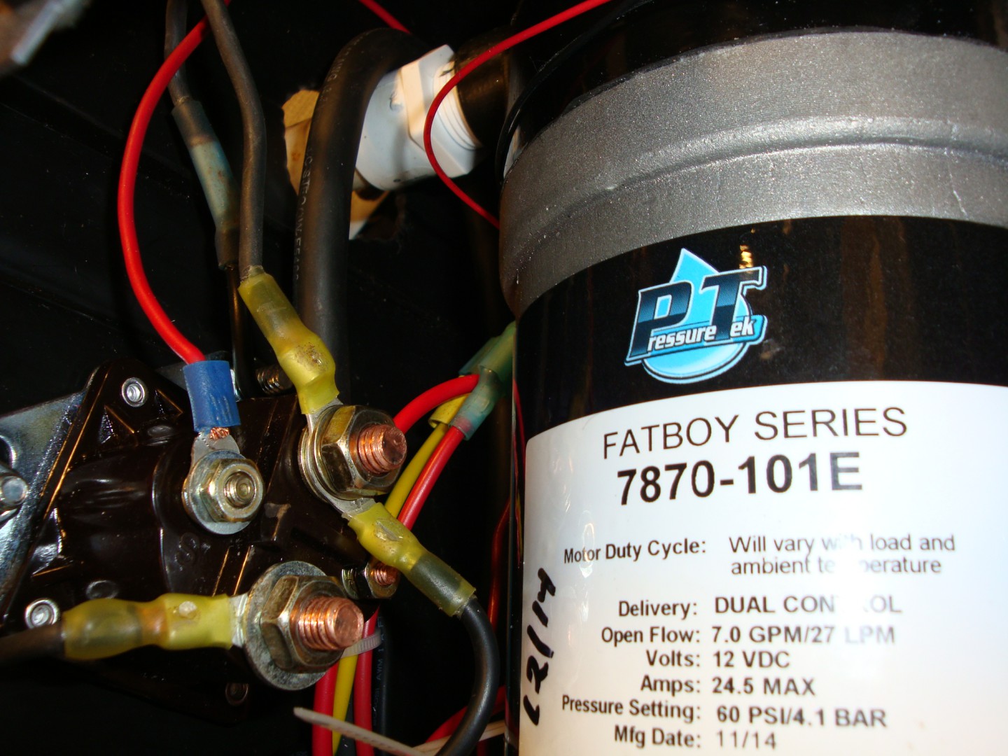

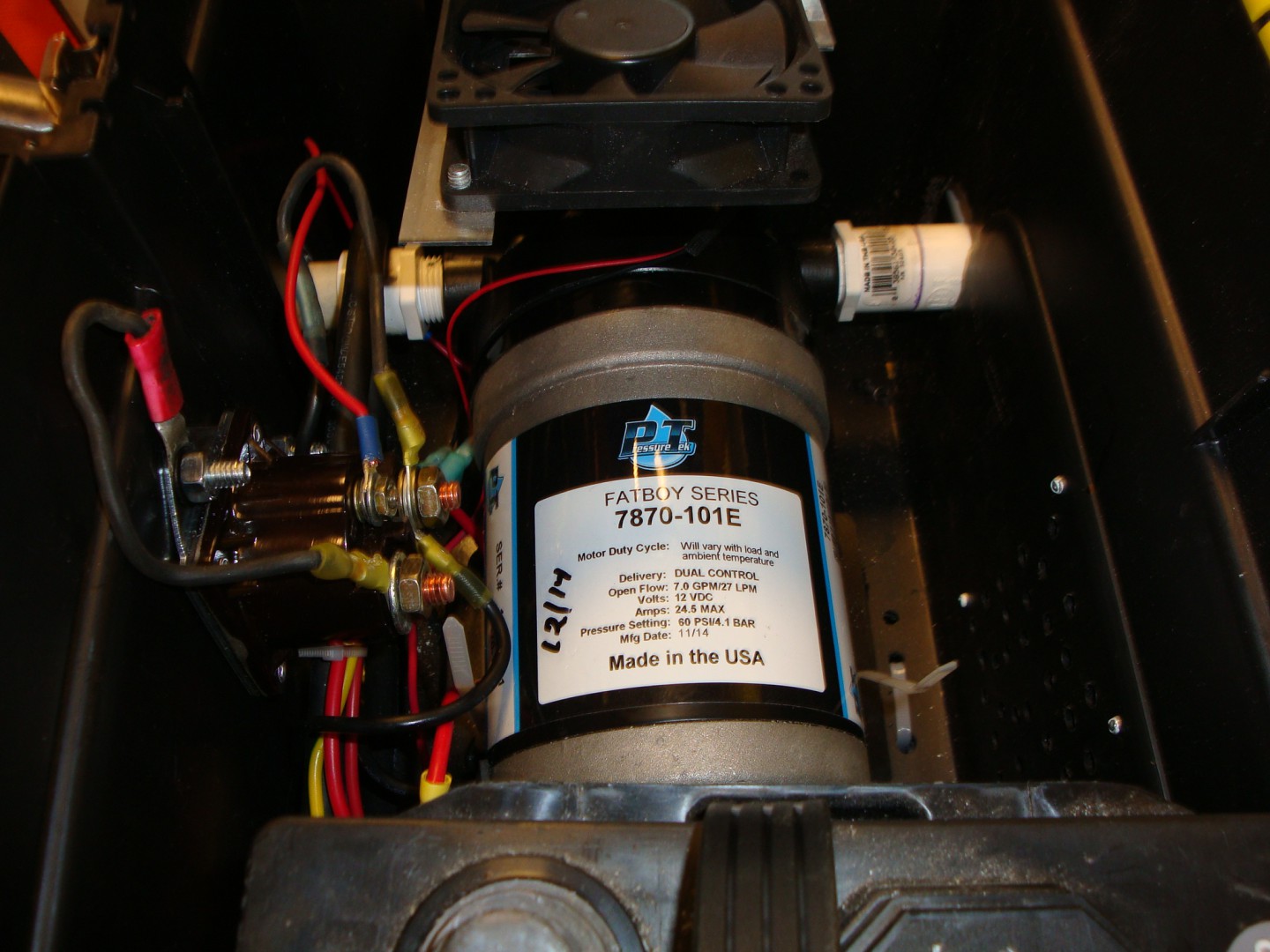

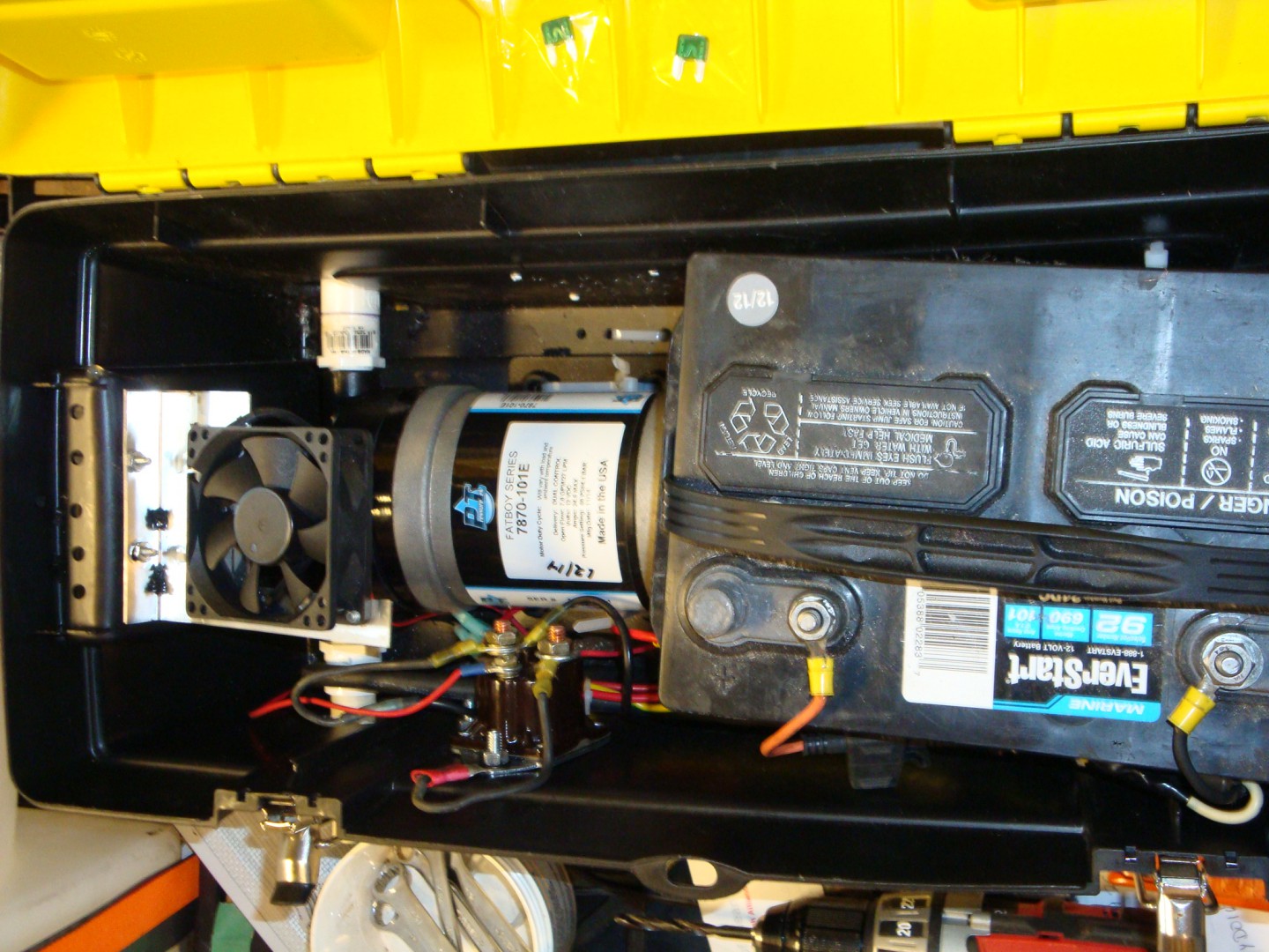

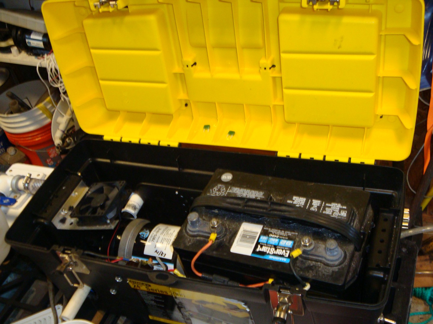

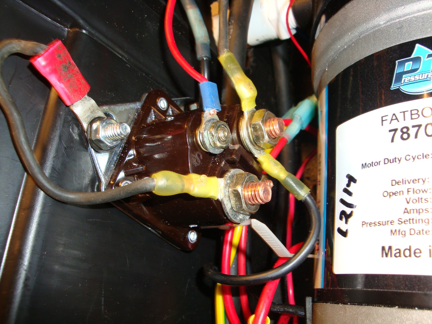

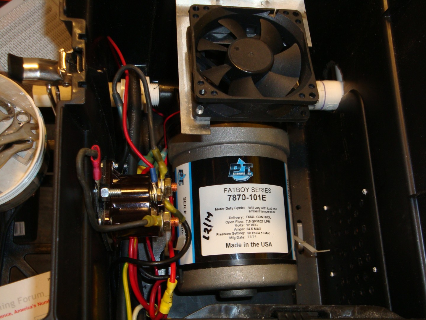

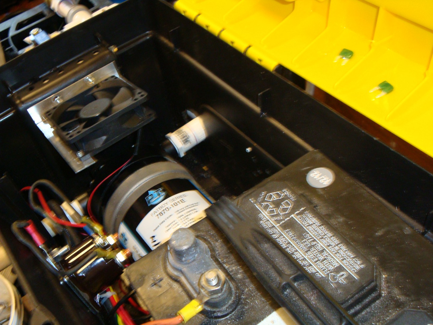

Fat Boy pump setup in a 24" tool box. Still needs a silenoid and vents. I zip tied the pump and the tool box to the frame. They aren't going anywhere. When I need to change things out I cut the zips and its out
