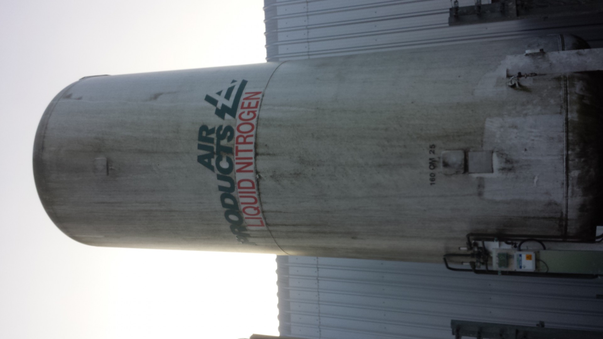

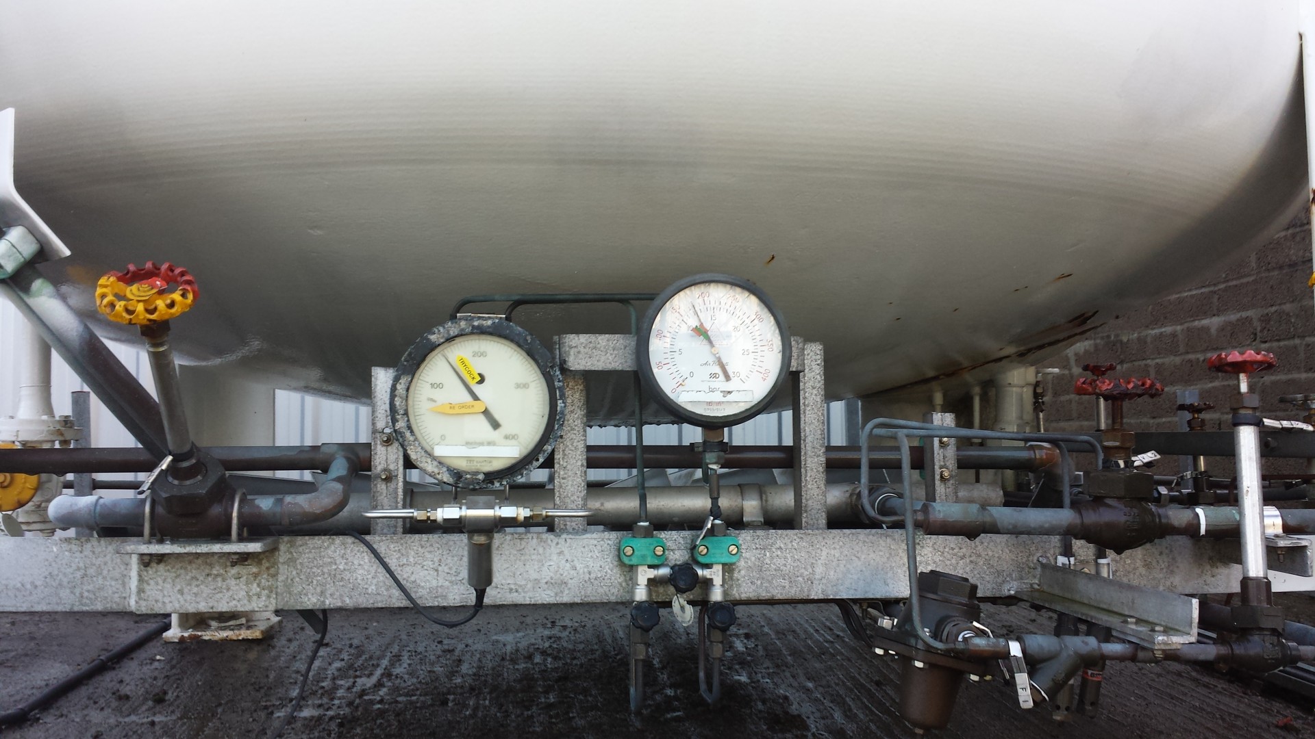

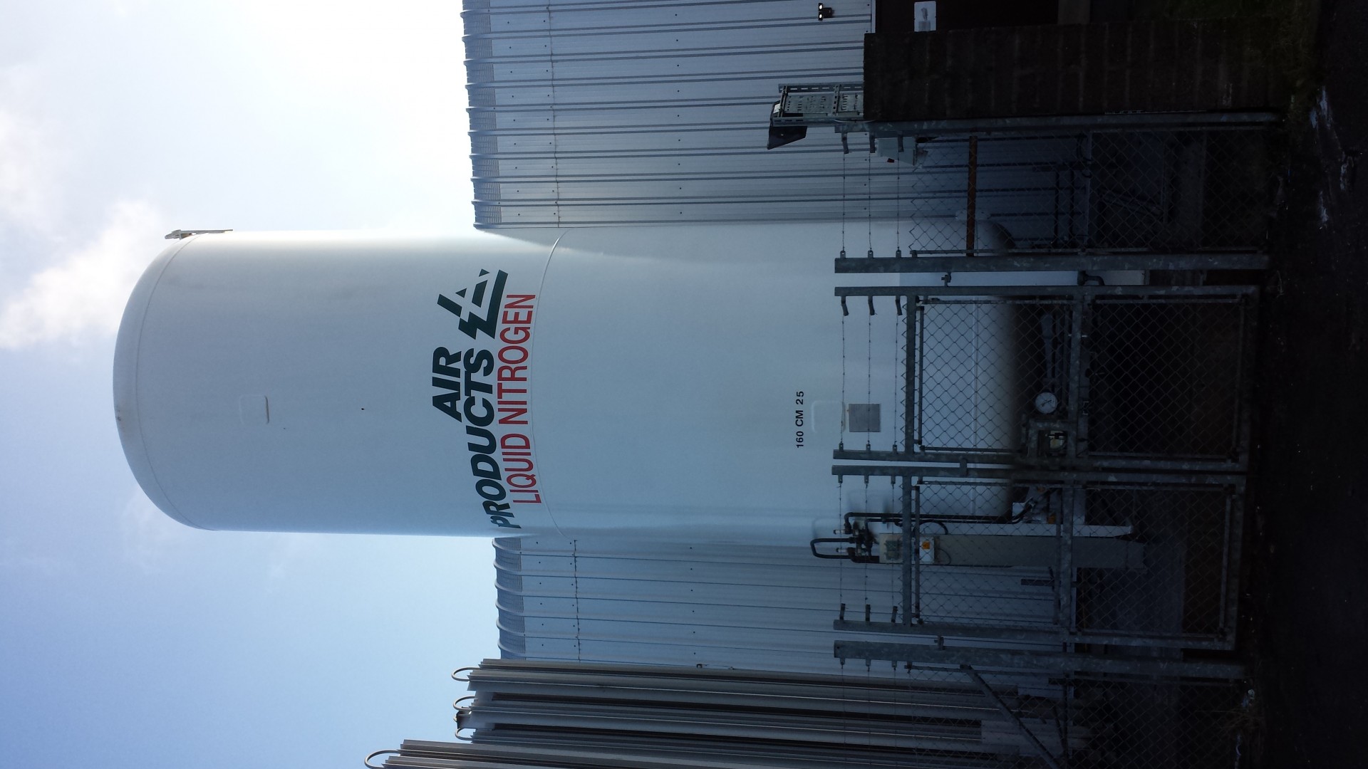

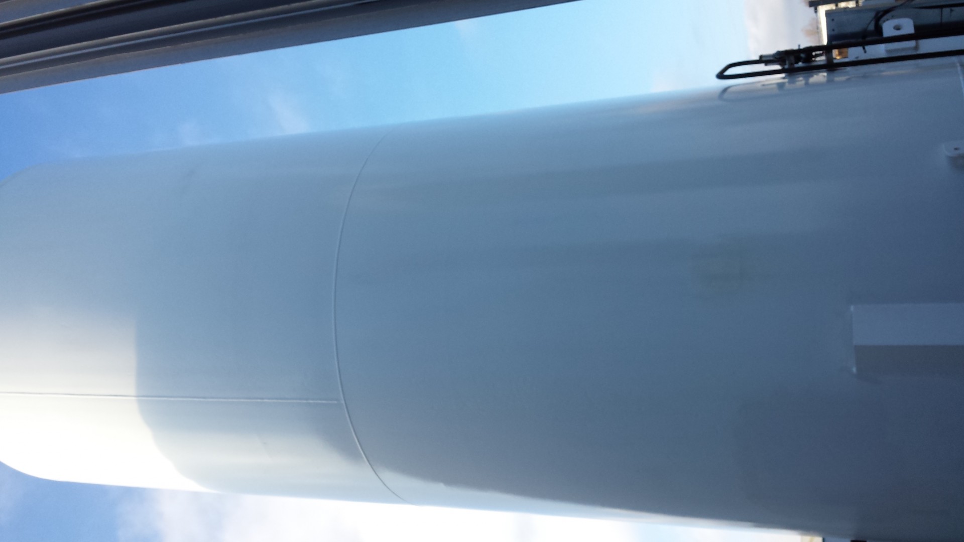

hi guys we got a liquid nitrogen storage tank to clean .it was covered in algi and some mould ,was a bit apprehensive at first to use SH as it has lots of copper pipe work at the bottom ,copper and brass and SH don't mix well lol, we soaked all pipe work plus before and after pics of all pipes ,i used the RO machine at first to remove the algi ,did half the cylinder then said naa to much rubbing and felt like a was earning my cash so stopped that set the buffer tank with a weak mix and sprayed it left it five mins max dwell time then rinsed lots just incase any issues ,but no issues at all ,the job went good ,

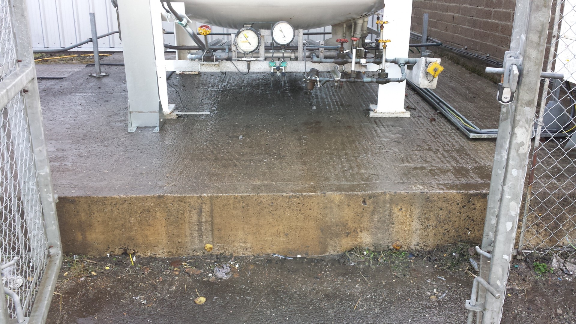

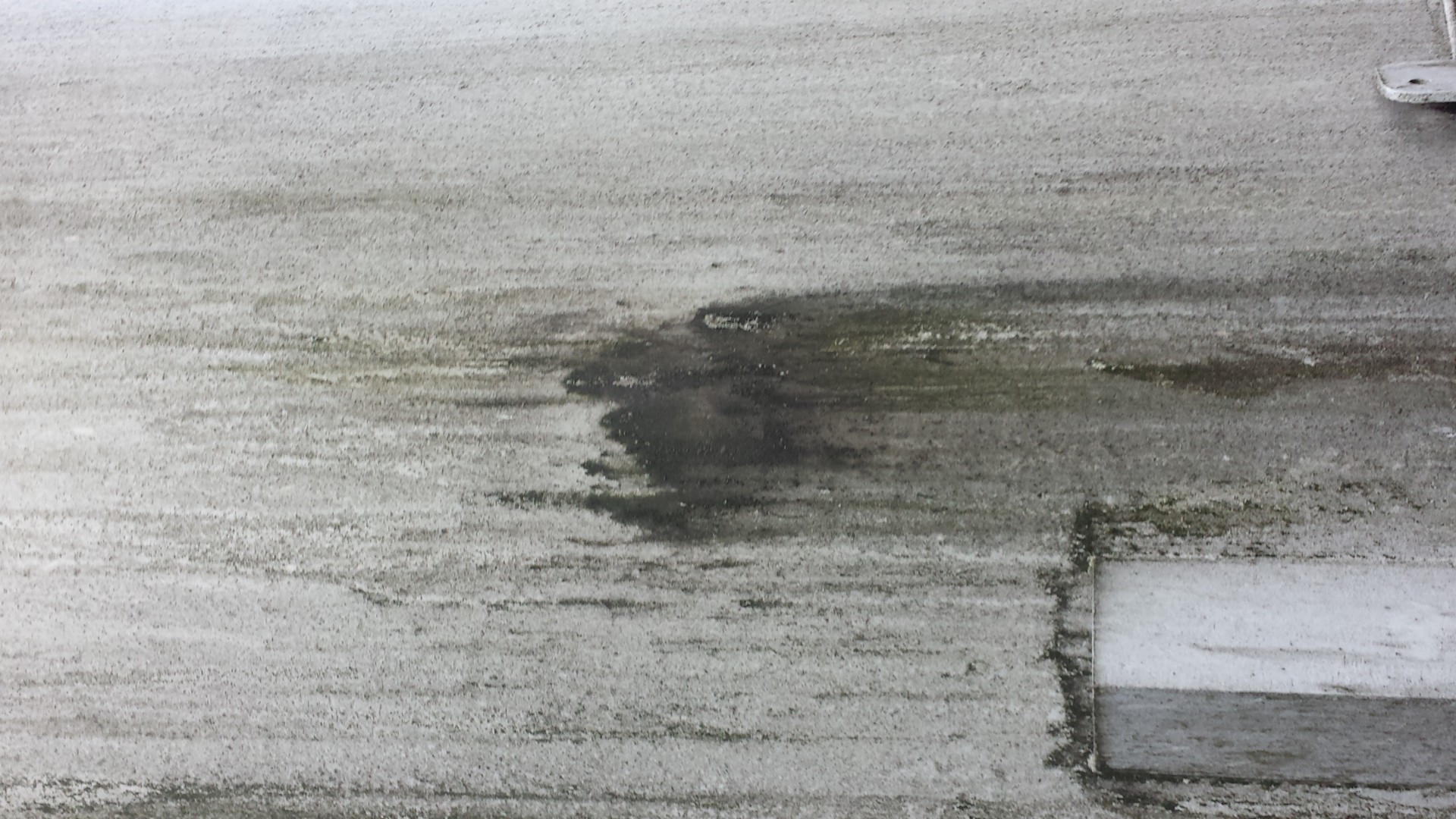

the concrete pad came up good also all the moss and slippy algi came of at low pressure .i am now trying to get in contact with air products to see if they would be interested in letting softwash scotland clean there tanks ,for them .
used 10 lts SH TO 200 ltrs water and a good bit fairy lemon ,
Great job......and yea, no real need to scrub. A light mix and a good rinse was all she needed.

When I went from photo # 1 to photo # 2 I just said WOW! Really looks great!
