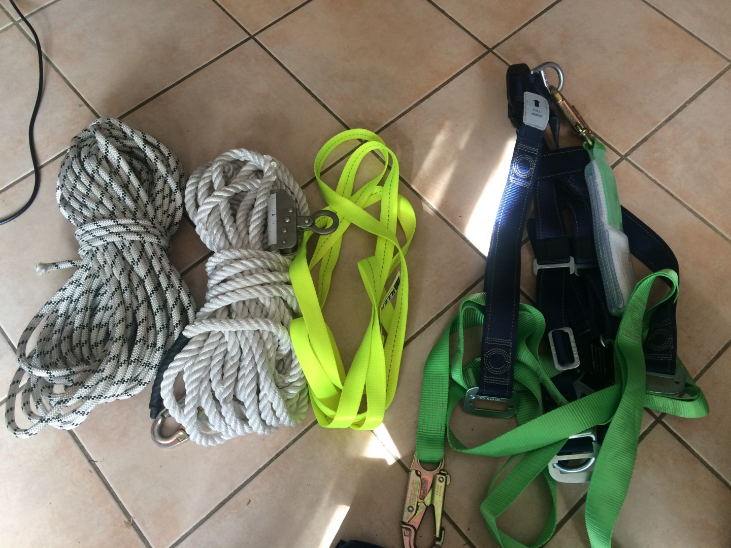

So here is a bit of what i use on the job.
The kit is a Millers Roof Access Kit made by Honeywell. They retail here at around $350.00 AUD. Should be a little cheaper in US.
I have included an additional rope if i need to create a static line. (not included in the kit). The rope that does come with the kit has a travelling stop included for setting your edge safe position etc.
Also I have included a pic of what many roofers here swear by. The good old Dunlop Volley. Every roof tiler, sheeter and solar guy I know, wears these on roofs.

Often residential property does not have a provision for an anchor at the apex of the roof. Tying off to pipework or other obstacles on the roof is fraught with danger as I believe it leads to a false sense of security and can cause damage to things I may not be capable of fixing which could be costly and leave the client with a poor opinion of my service. having anchors installed is costly and would make most jobs unreasonably expensive leaving the door open to the cowboy who will do it and risk his neck and get away with it 99/100 times
Where possible I will anchor to a verandah post or solid structure and toss the rope to the other side of the roofline. Climb up and attach to the rope working only on the positive side of the roof. Keeping that tension is the key to being safe.
When I have completed this side of the roof I will reset the rope and work the other side of the roof. (Hope that makes sense)
I heard something the other day that there is also a rule here that you can attach to your vehicle but the guy in the harness must have the keys on him so know one can drive off in the vehicle and pull the guy off the roof. I am not sure how accurate that is but it sure paints a scary picture about what could happen when you think about it.
