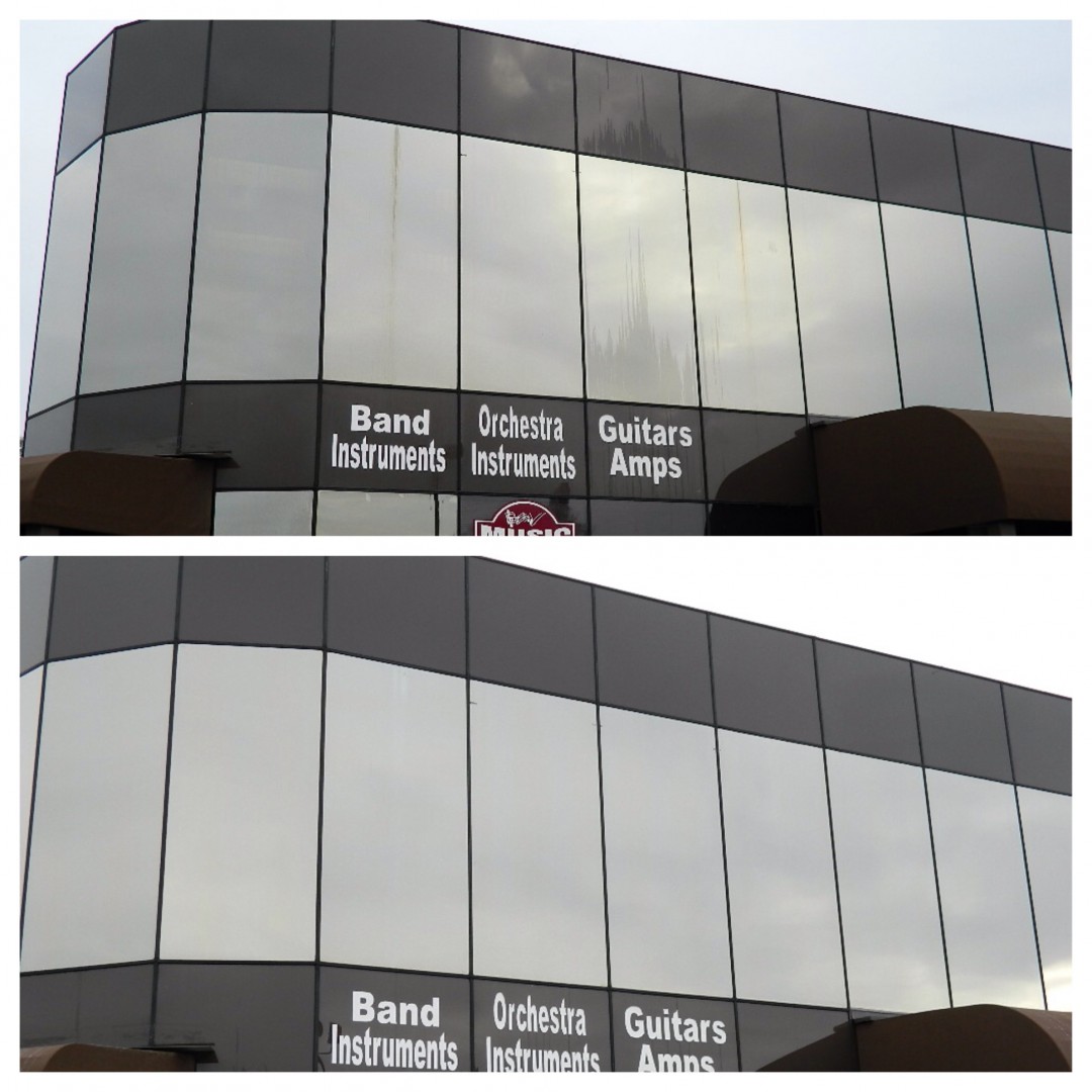

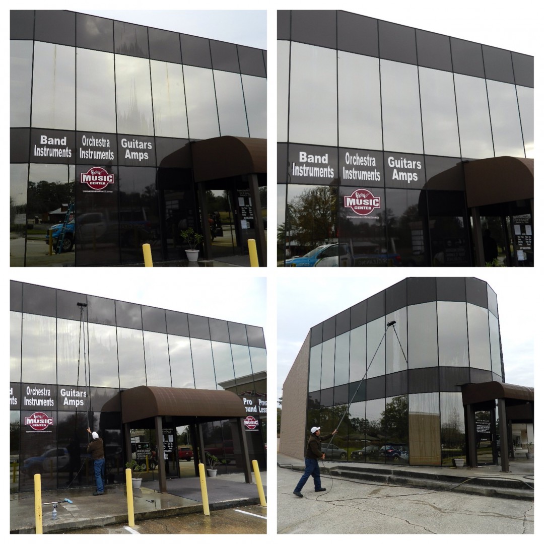

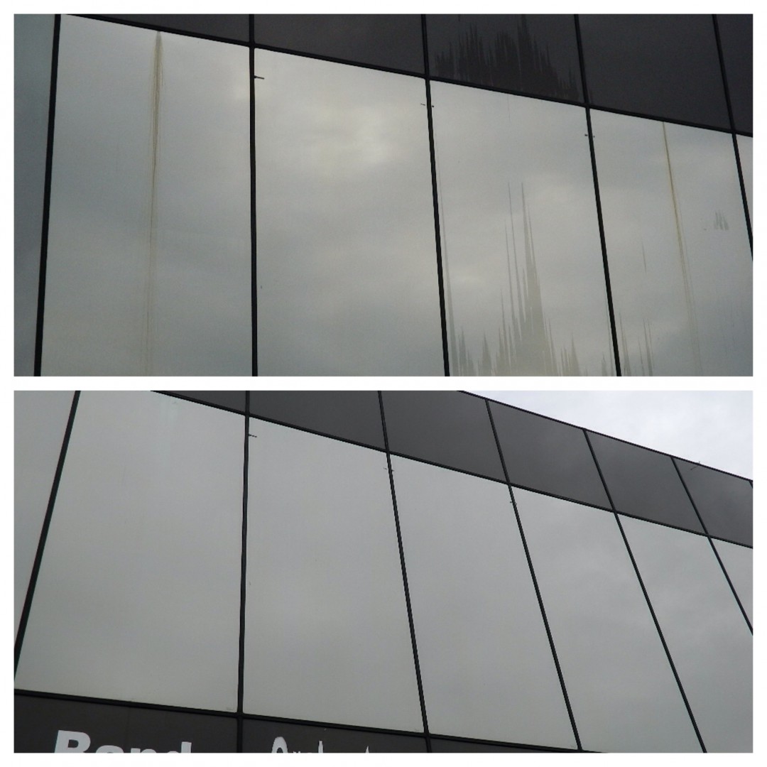

Here are some pics from our first ever WFP job. We also removed the rust stains from the windows. Big thanks to Steve Blyth at Jracenstein for his advice on removing the stains.

Used One restore on it. I talked to Steve Blyth at JRacentstein and he gave me instructions on how to do it. Cleaned the window, then applied some One restore to a t bar, and applied to the stain. Keep it wet. He said dwell about 6 minutes, but after 2 minutes I would get scared and rinse, so we did several applications like this, with each application it would lighten up.
I had covered myself in the contract that the product we used could possibly damage the glass/film and that they may have to replace either or both if it didn't work. Also that if it did work, thereby be damage revealed under the rust....as long as they were happy with those terms, and they were, I'd give it a shot.
As for pricing, I don't like to post pricing in public as it can be mis leading, but I priced it HIGH.....
