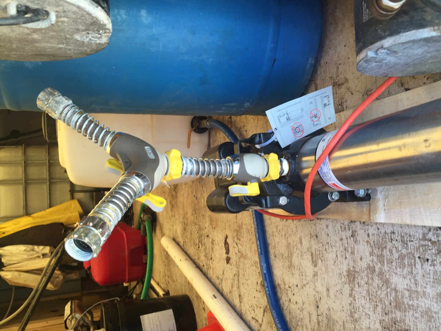

The build is actually great but we are staying booked out 6 weeks so I just don't have time to get a wrap. Also we were swamped and my garden hose reel pooped out so the truck is a mess for the pictures I took today.......
I put my RBP pump and my 12 V pump in one of the compartments with separate valves to switch from mix to water.....works awesome.
In fact I just bought another RBP pump that is sitting on the floor beside me because this one is about 6 months old and that is about when they take a dive. Everything is set up to easily swap out on the go. My battery is in another compartment along with a charger because I have not had the time to hard-wire to the truck.
I have two 55 gallon drums near the cab. One for SH and one for my mix. I will be putting in another tank because sometimes we will shoot the roof and do a house wash at the same time but can't use the same mix.

What is the black box mounted to the wall behind RBP?
Jun 11, 2015
There isn't anything black mounted behind the RBP Pump.....just the valve assembly I built. To the side there are two black things. One is my 12V pump and the other is the accumulator for the 12v pump.
It really is pretty slick and easy to operate. Allows us to do residential and commercial....roof or house wash or anything else we want.
