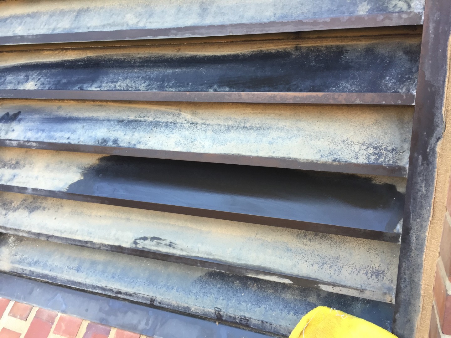

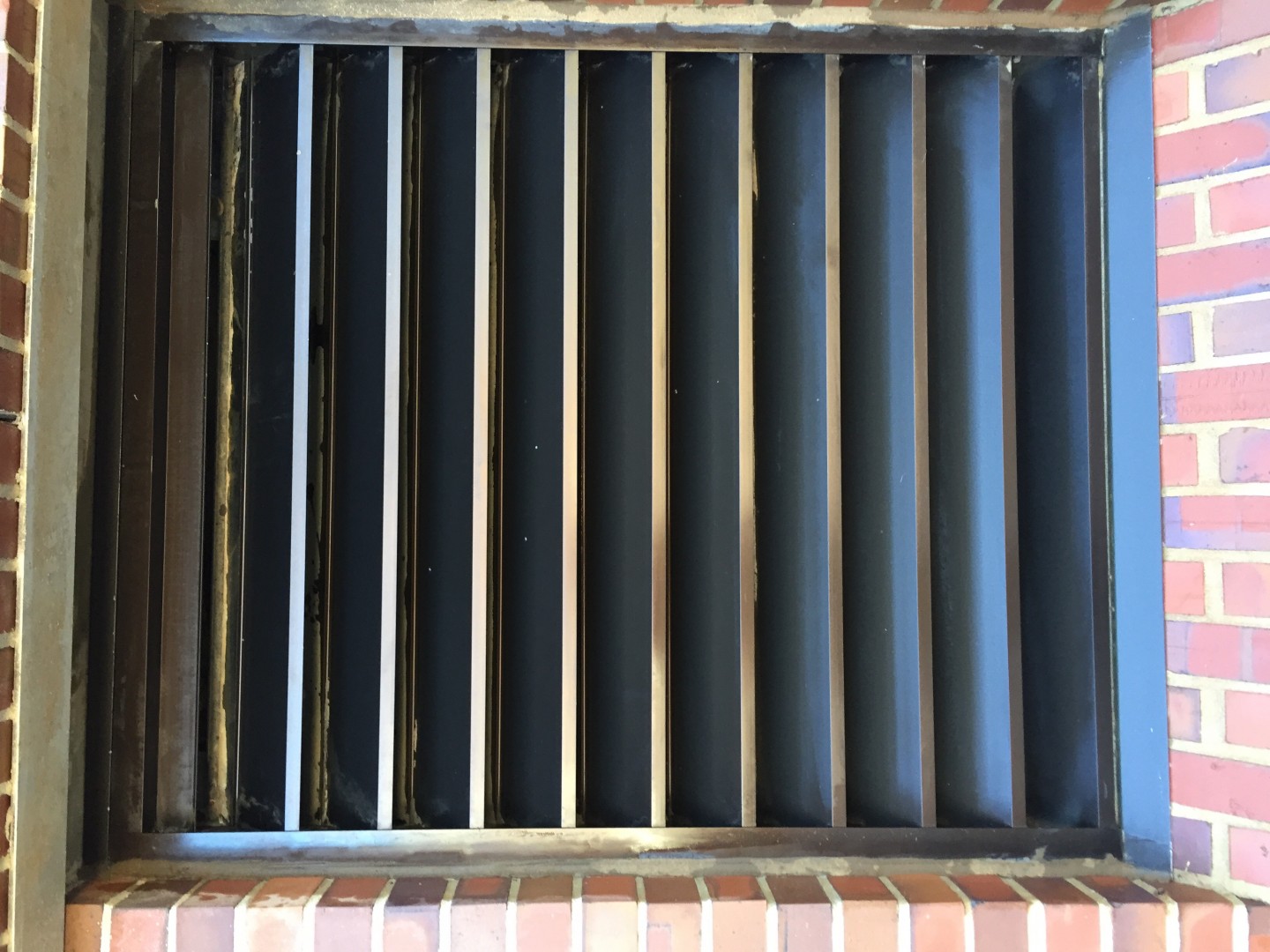

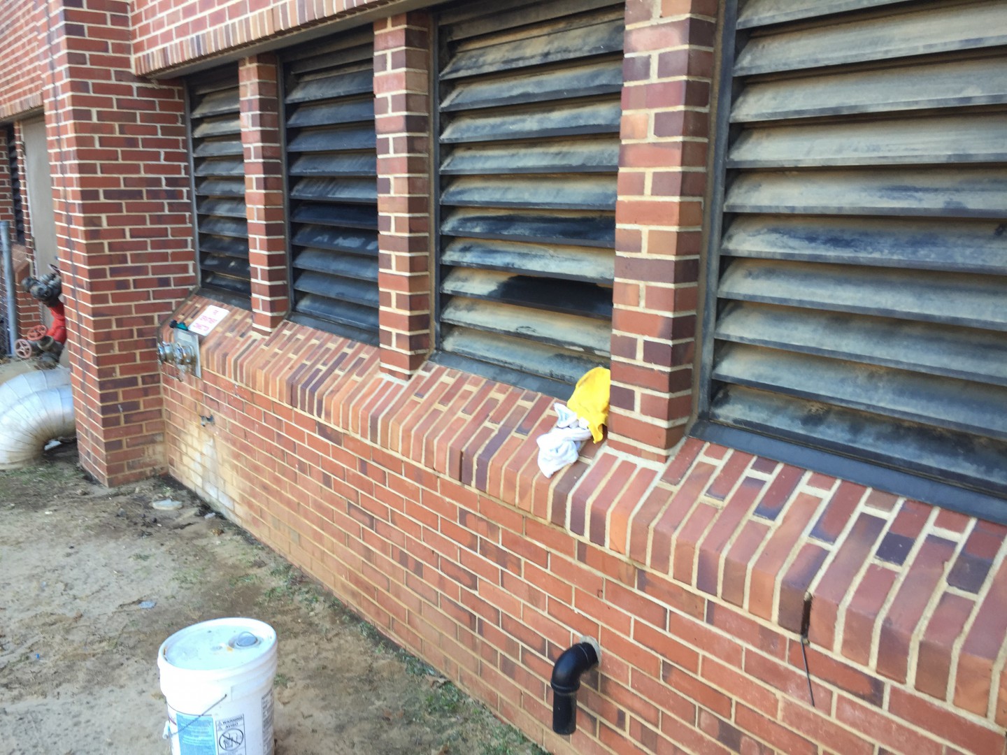

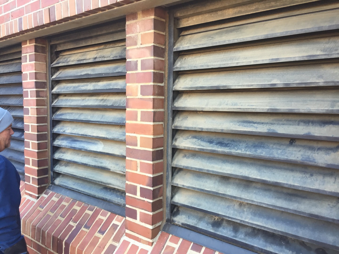

Many times on commercial jobs we encounter metal louvers like this which allow for airflow into the engineering areas.they just tend to get pretty funky due to airflow, humidity, moisture and oxidation. Sometimes they cleanup great, other times not so much. The ones that I'm showing here fell into the latter category, I'm not cleaning up so great. We soft wash them at a 15% mix, then tried soap and a scrub brush, next moved onto F 13 gutter grenade to try to help remove the oxidation, no luck there. Continuing on in my arsenal I tried some F9....no results there. Finally at my wits and I tried one restore and that has seemed to do the trick.
if you've never used one restore before make sure you wear proper PPE. It is a buffered hydrochloric acid detergent. Pretty nasty stuff, but is doing a good job of cleaning up the louvers!

Applied witha long bristled medium soft brush, agitated and wiped off
