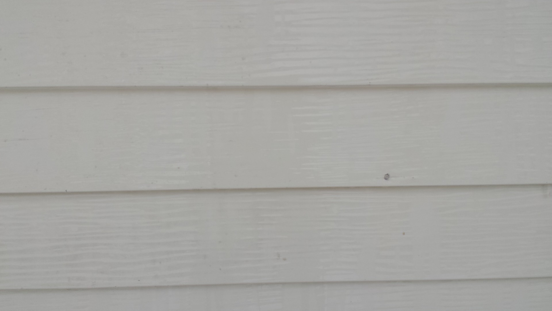

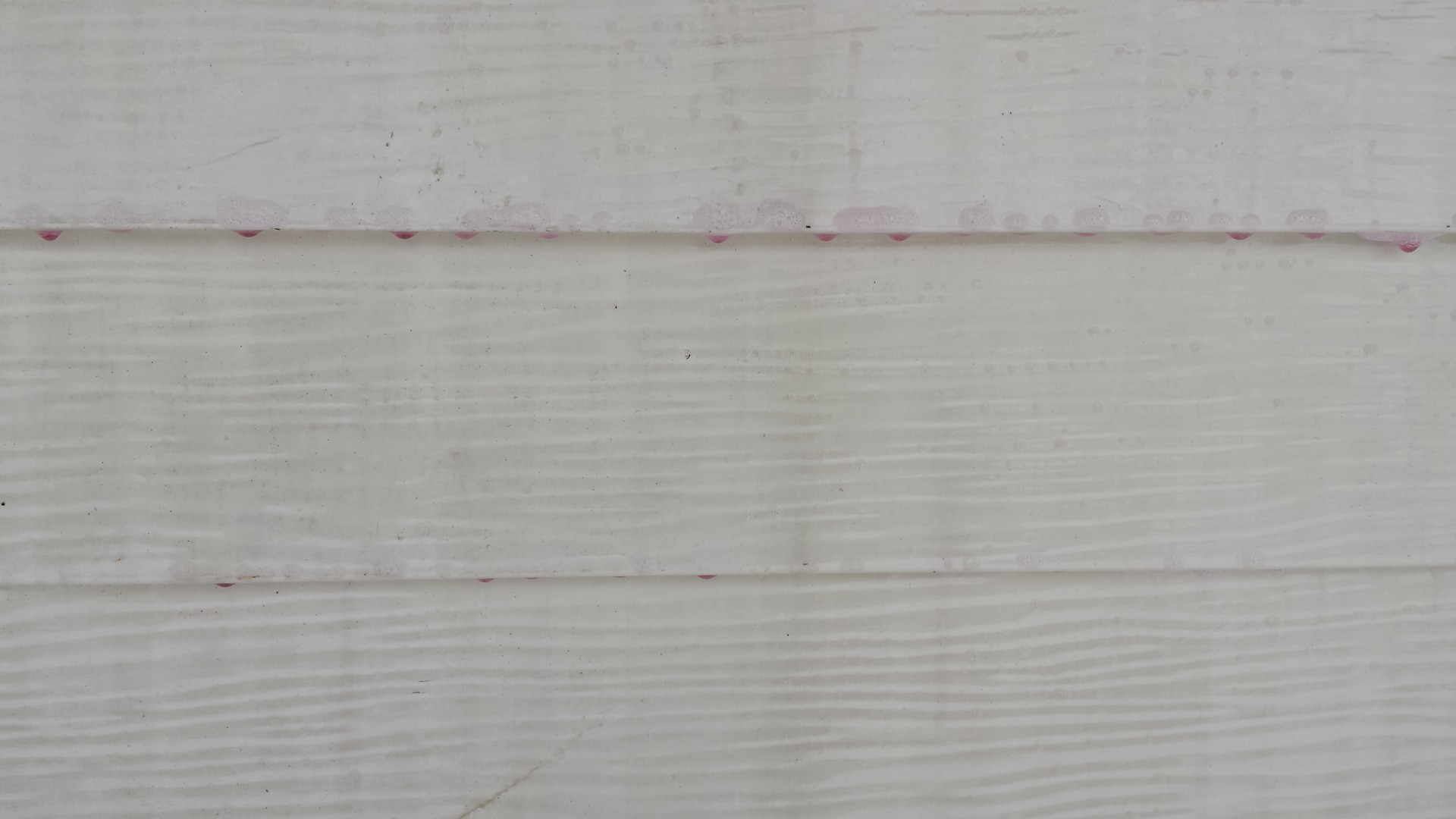

A contractor of mine was attempting to clean aluminum siding on a house. He tried several different cleaning agents with his pressure washer to no avail. It was more than dirt. I believe it was oxidation like you see on aluminum gutters. I took Art's advise and tried Purple Power from Walmart. I sprayed it on, let it dwell for a few minutes and then wiped it off. The oxidation came right out. And mind you it was only 40 degrees out. I was a bit apprehensive as the directions warned it could damage painted and aluminum surfaces. I first did a small test spot before cleaning the entire surface. I went back the next day as well and it still looked great with no apparent damage to the paint. Another nice cleaner to have in your arsenal.
