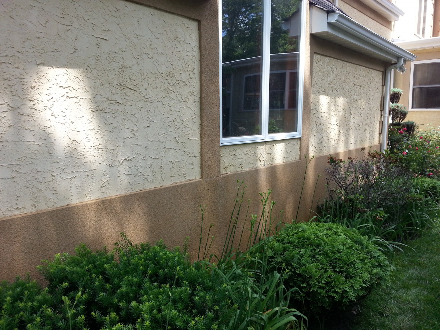

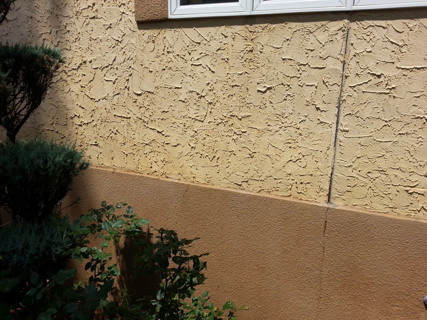

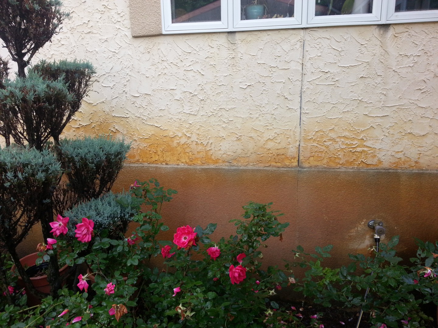

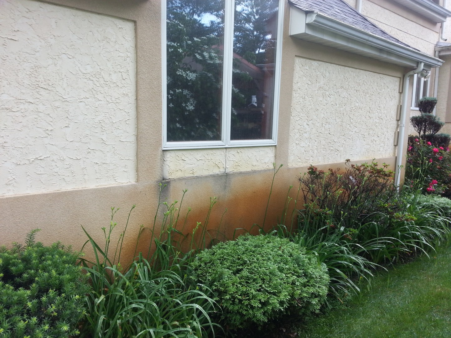

Chris,
I know everyone already jumped in, but I wanted to share a few photos of a job we did last summer, that was very similar to what you are looking at. We used F-9 and had great results. I also made a post here when we did it, this is the link
Im pretty sure the F9 will work for that job, but do not confuse the irrigation stains in that picture to our red dirt stains that are very familiar in appearance. We have a dirt that is very similar to Georgia clay and is extremely difficult to remove. I have some F9 if you would like to try it. Give me a call.
Mar 2, 2015
Mike I'll take you up on that offer. Thanks I'll call you tomorrow.
Mar 6, 2015
Did demo f9 worked. Thanks will be ordering a few cases. Thanks Mike for your help.

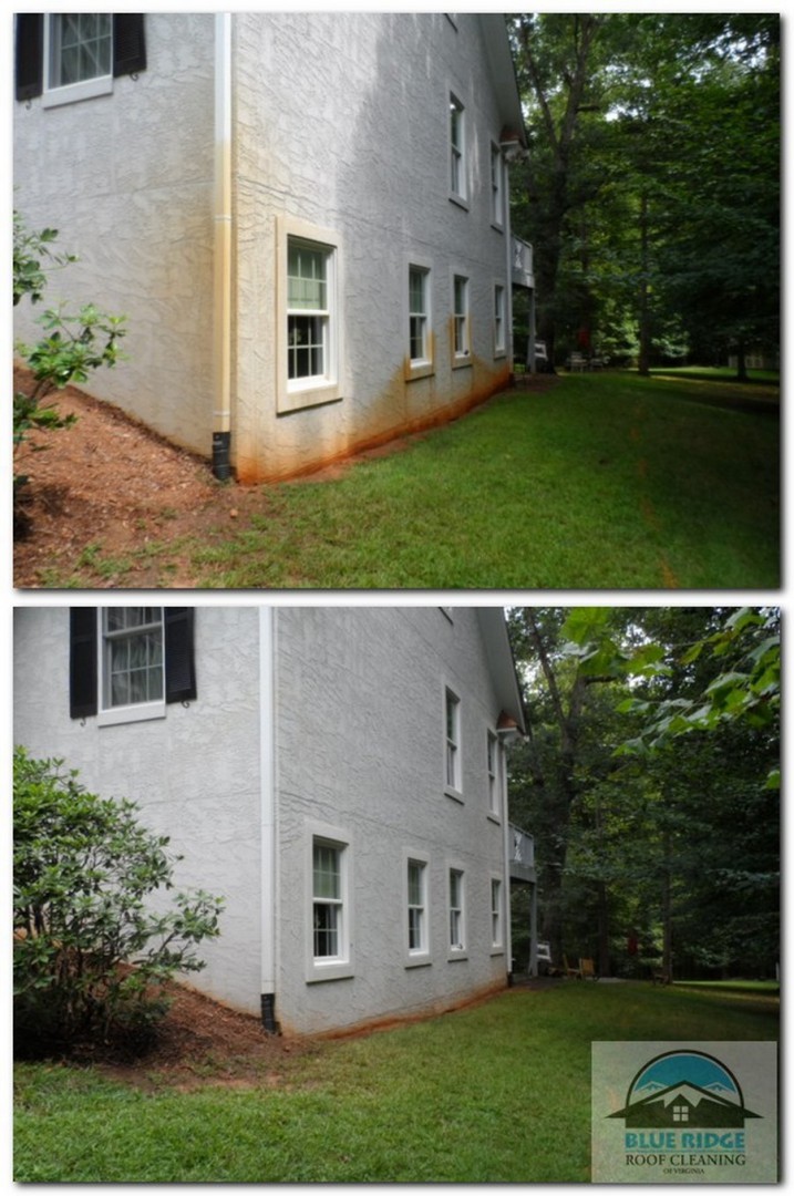

F-9 The picture speaks for itself. And yes, it goes a long way.
www.front9restoration.com
◦Semi Porous Substrates:
Stucco, Plastic, Vinyl, Asphalt, Stone and others. Dilute F9 1:1 to 2:1.
Spray at a rate of 400-800’ per gallon.
Do not let product dry and rinse immediately following disappearance of stain.
