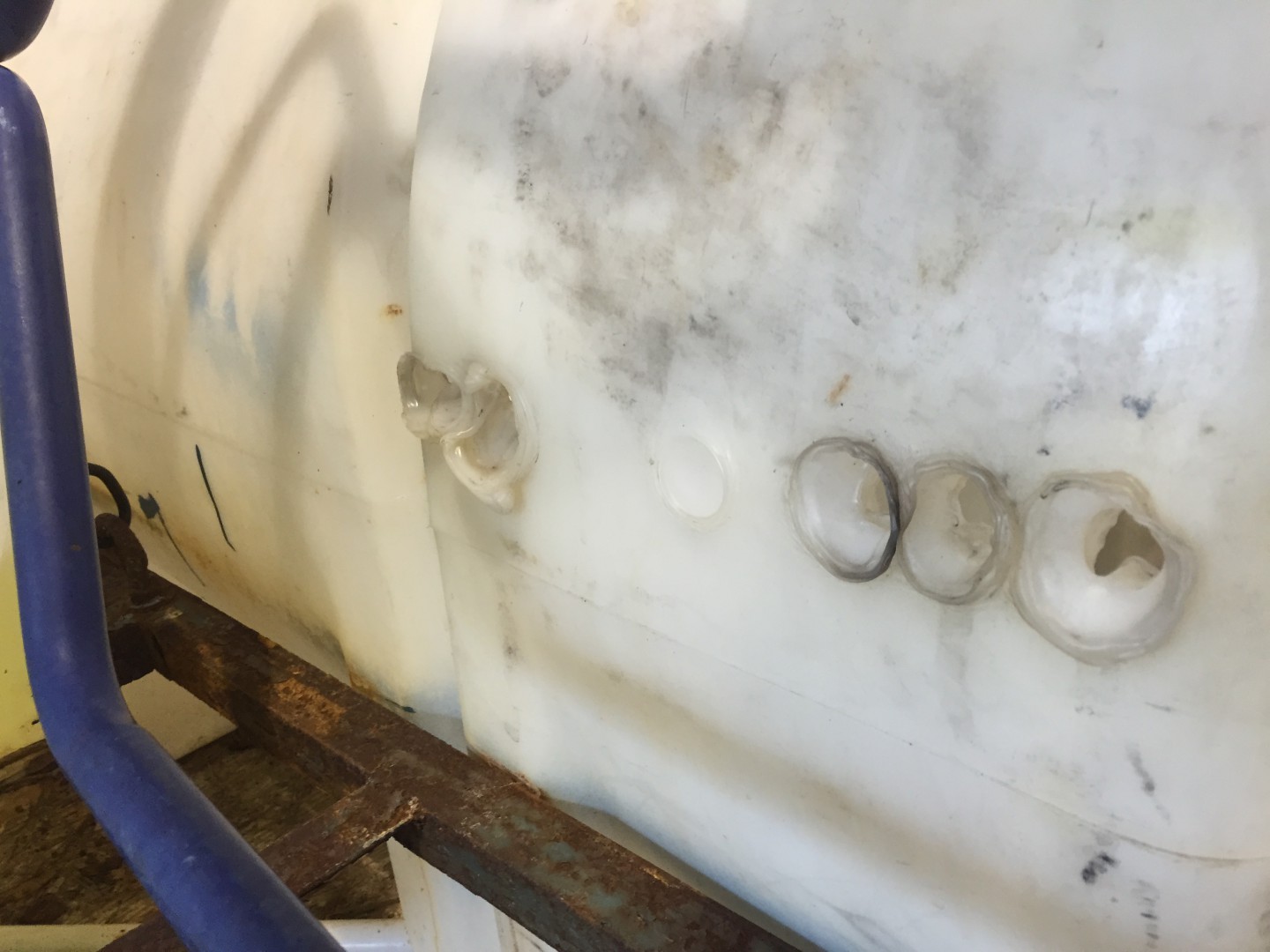

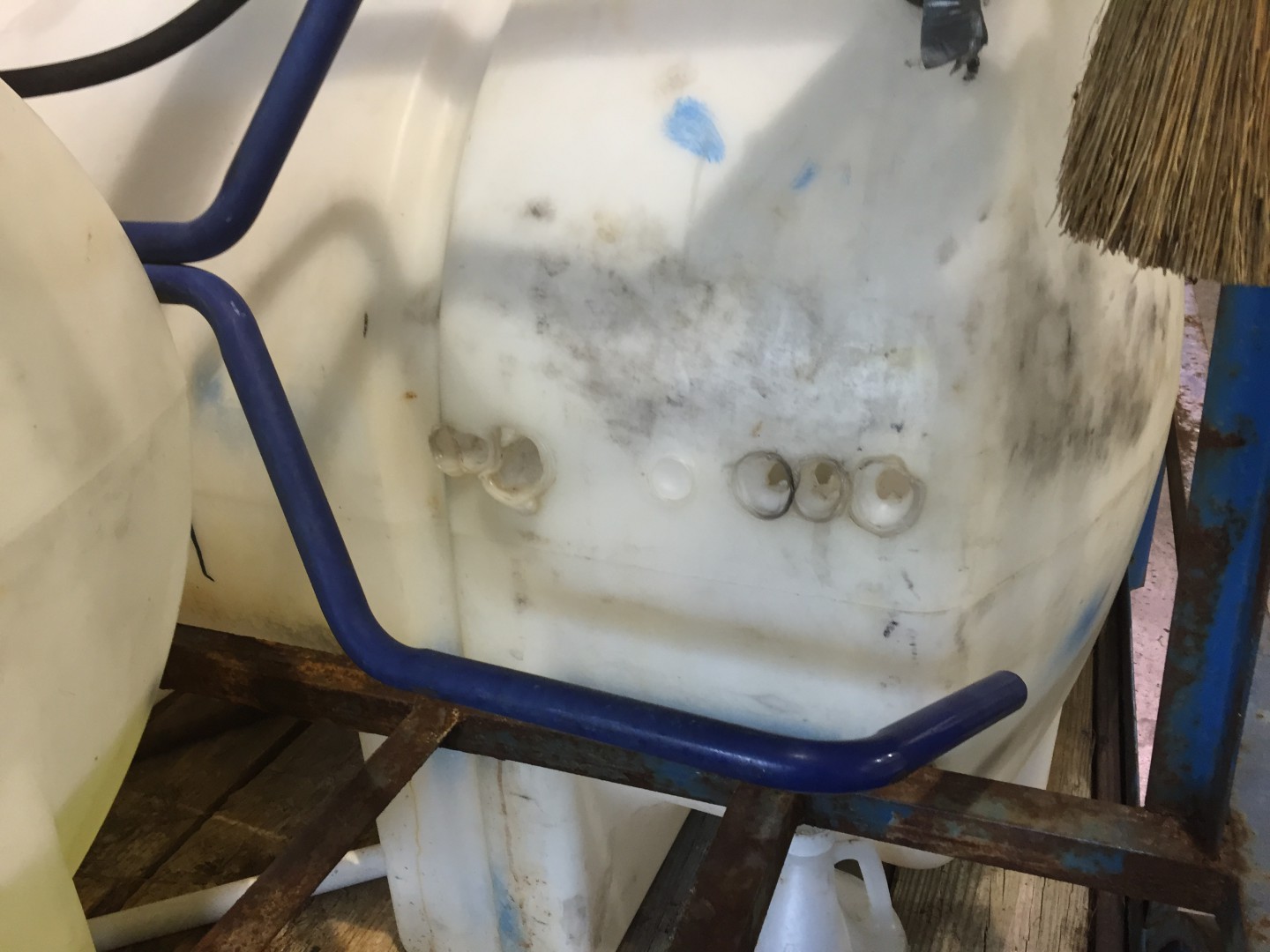

Ray, I had a muffler fall against one of my tanks about 3 years ago. I used a piece of shower curtain and put it over the hole. The used Marine tex and applied it all over like putty. Still holding and only took me about 5 minutes.
Generator got a little took close to my 325 tank and got some holes in it. Any idea for repair?
Ray,
Check out this video.
https://www.youtube.com/watch?v=k_Fkhz2G9Is
