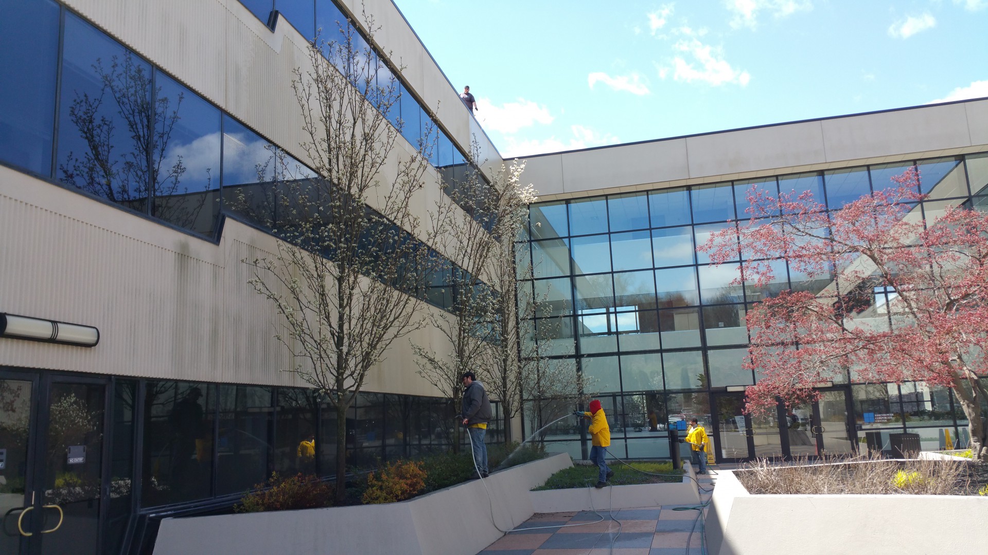

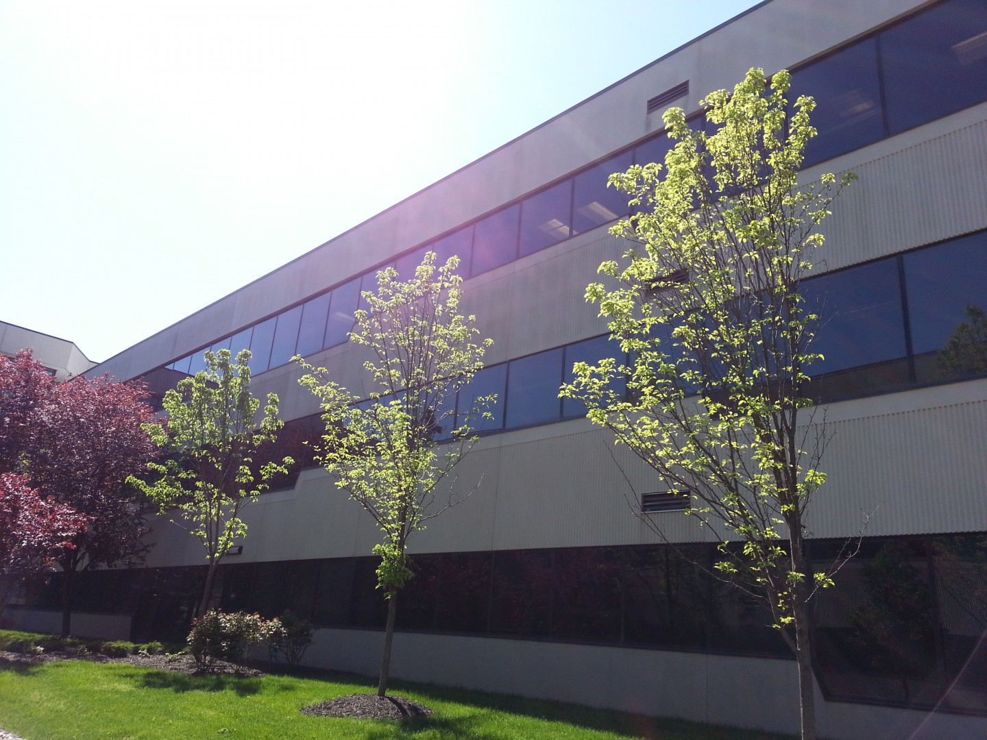

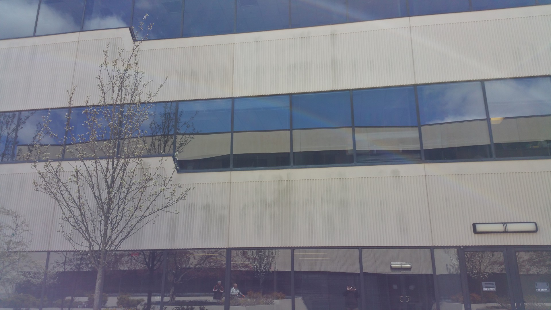

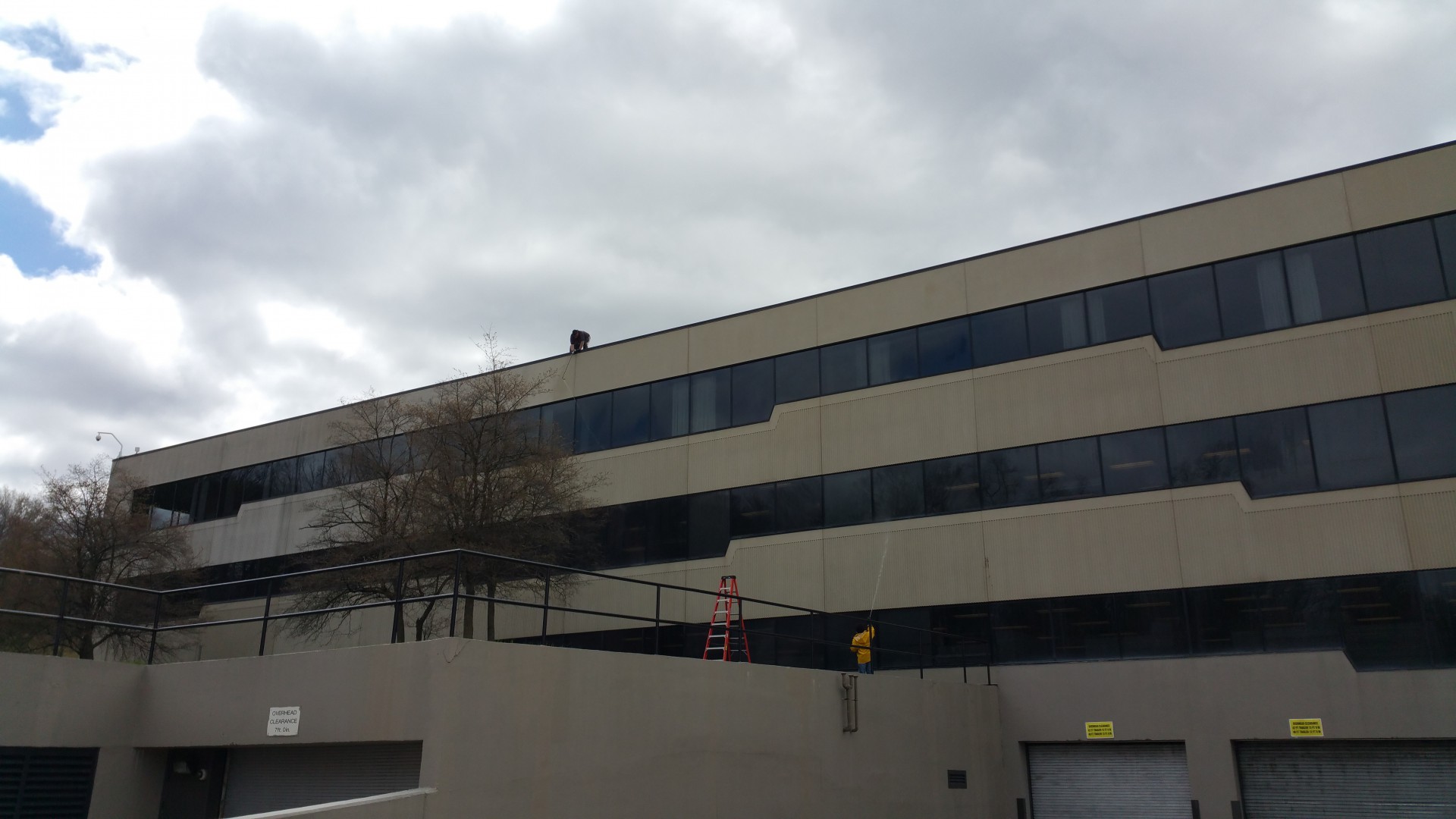

This week the Roof Wizard's Crews softwashed a corporate office HQ, for Verizon. It was cold, and extremely windy, but we were able to get the project scope of work done in one day. The building was fully functioning and had approximately 1500 people in and out all day, including deliveries to the loading dock and an entire army of Verizon Corporate Officer's in for meetings. It was probably our most difficult job to date, with respect to pedestrian and auto traffic, and dealing with a constant 25 MPH wind. They are having a Corporate party for all the Verizon big wigs here next week, in the courtyards, and wanted the building to shine. We used a 2.5-3% mix with Green Wash and the results were terrific.
Very nice John. Looks like you managed without a lift. That's awesome!

You are correct...no lift.

Hey John....3% and no issues with grass burns.....awesome.

Great job! Did you use a booster pump on that?

No issues with grass burn, because of the amount of rinsing. In mid August.....different story.

Thanks Chris. We used two booster pumps and still had to put a guy on the roof to rinse also. The wind was ridiculous.
