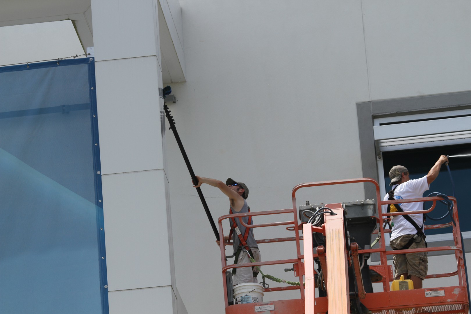

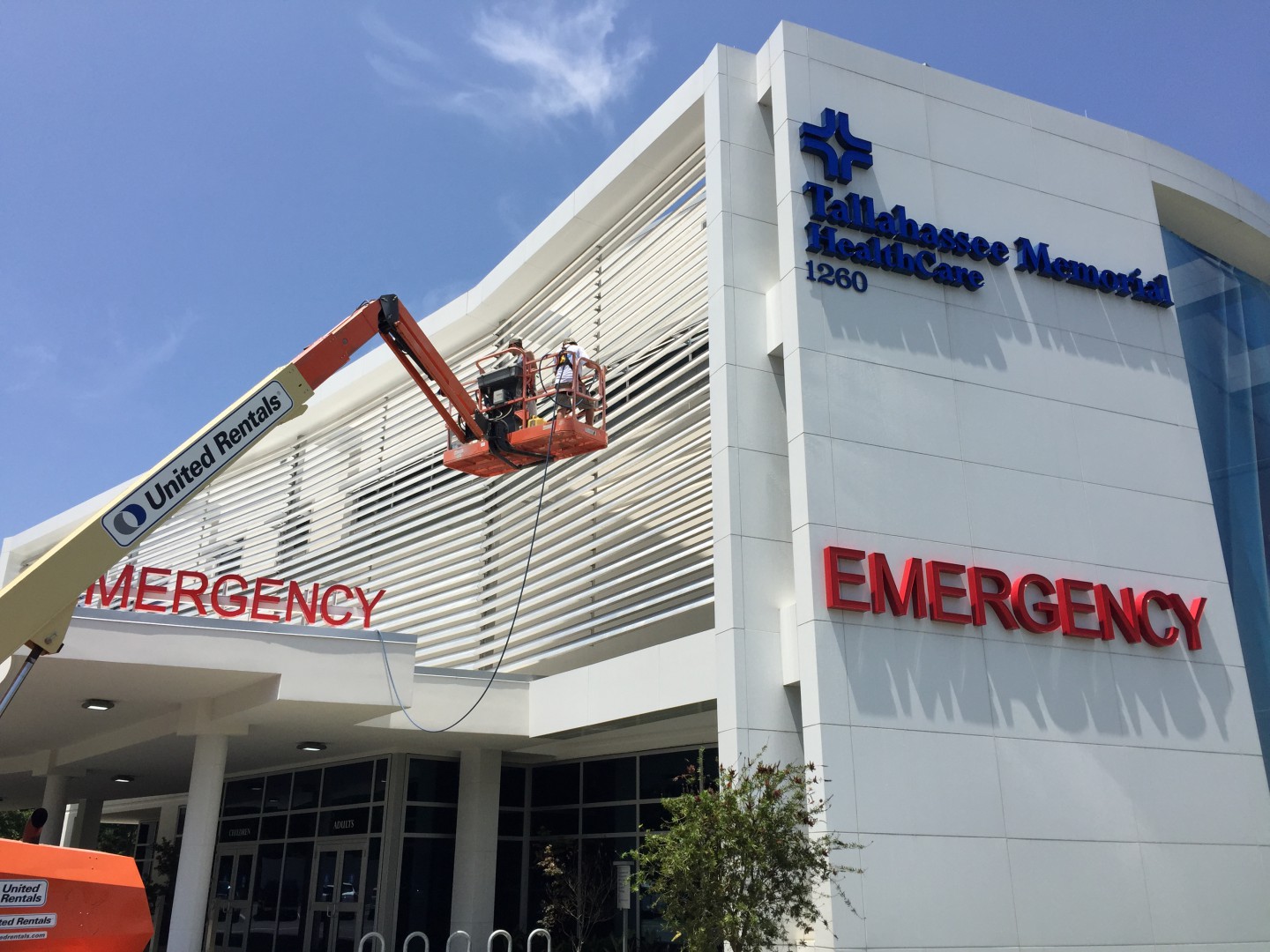

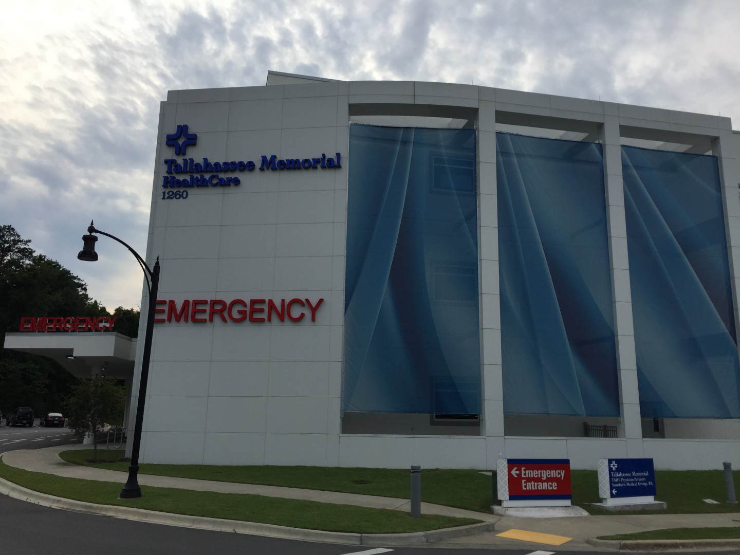

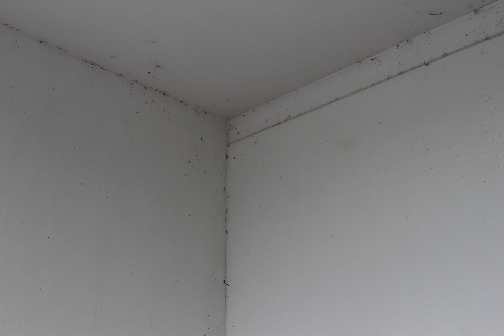

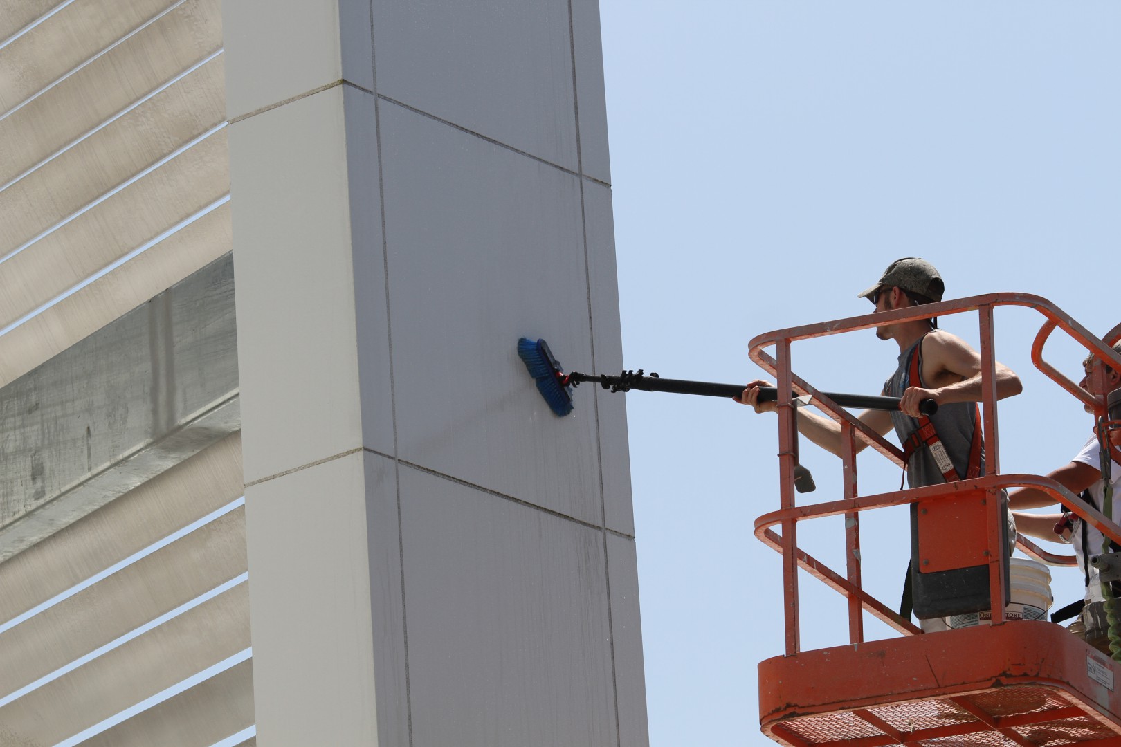

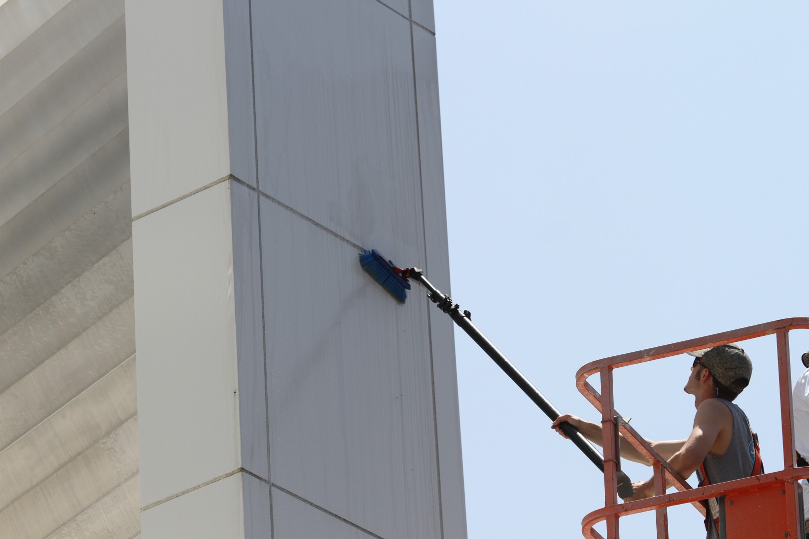

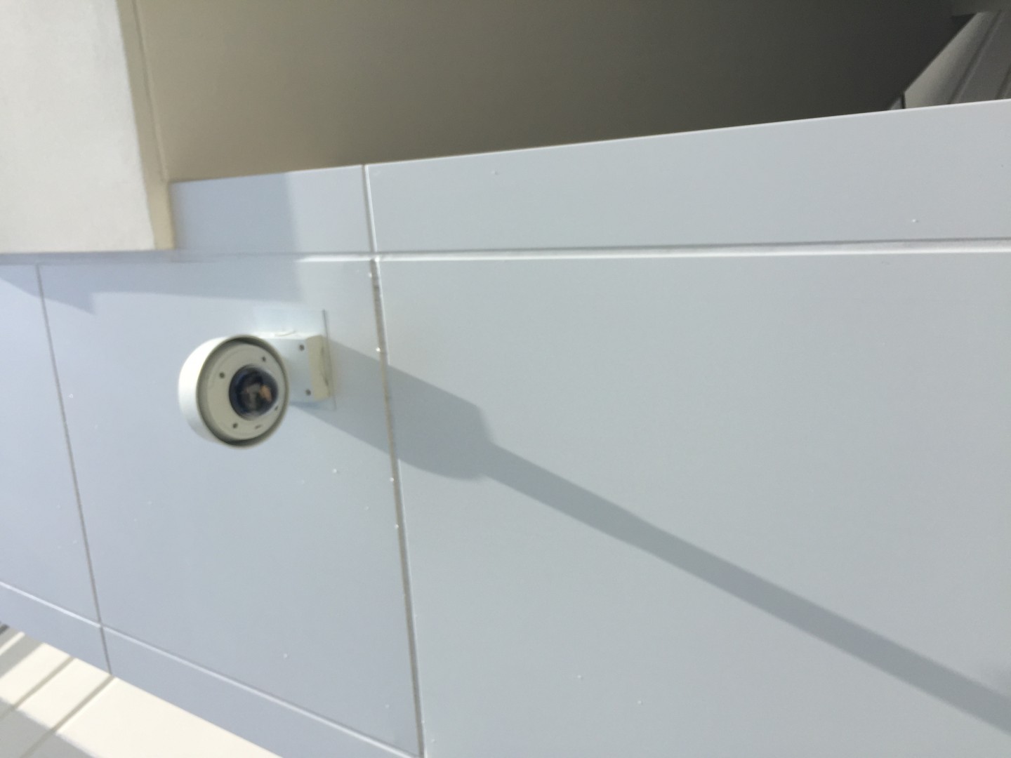

Very nice Ray. Did you use anything special on the Alucobond panels?? Like a two step truck soap or just regular mix??
Apr 28, 2015
John, those things were a freaking nightmare!!!! I threw every thing at them, house wash, F 13, one restore, butyl, , finally the magic bullet was simply scrubbing them with plain water. The dirt was held in place with a surface tension and unless it was manually scrubbed, it was not coming off.

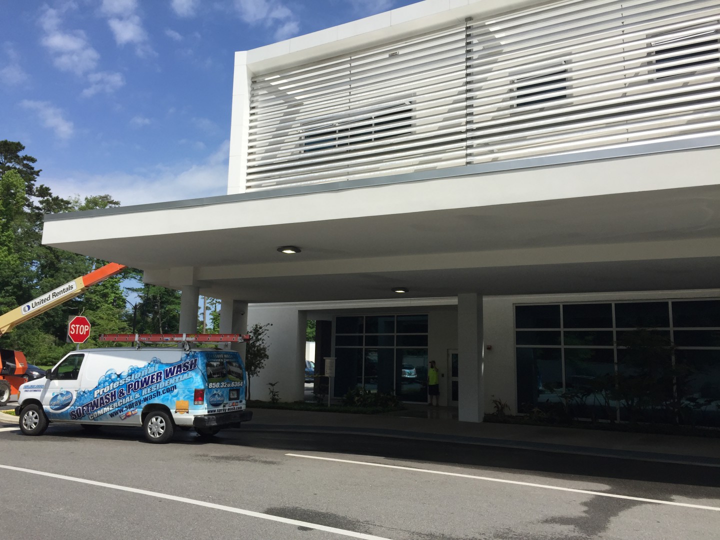

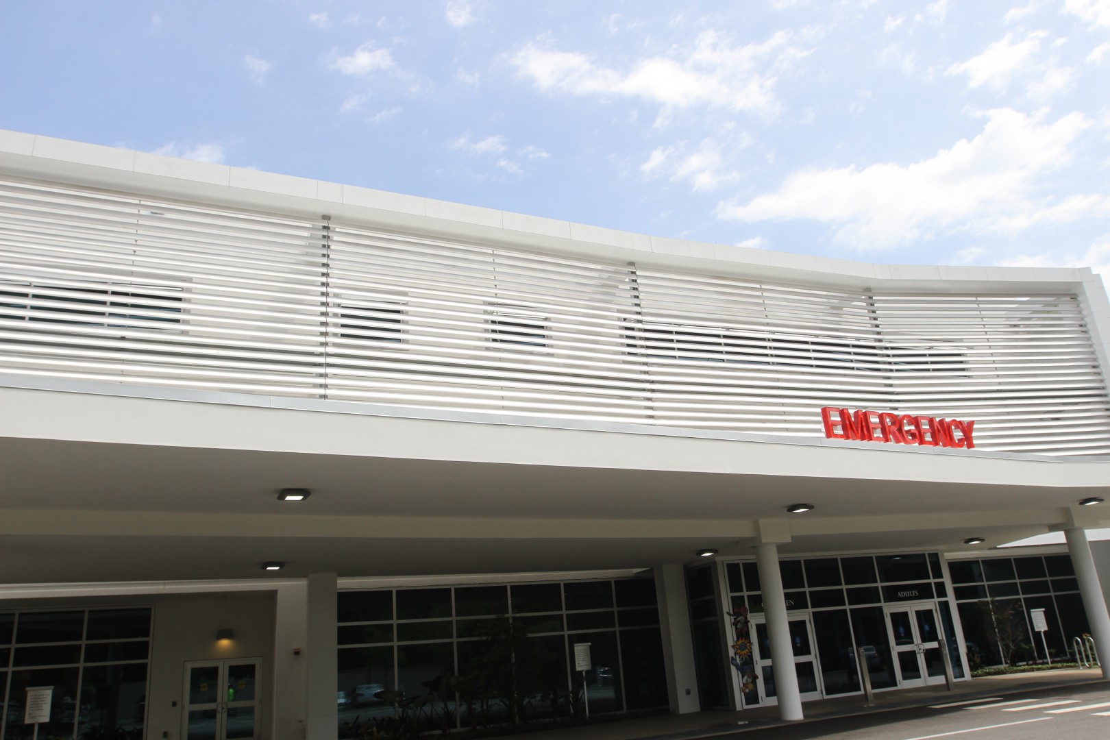

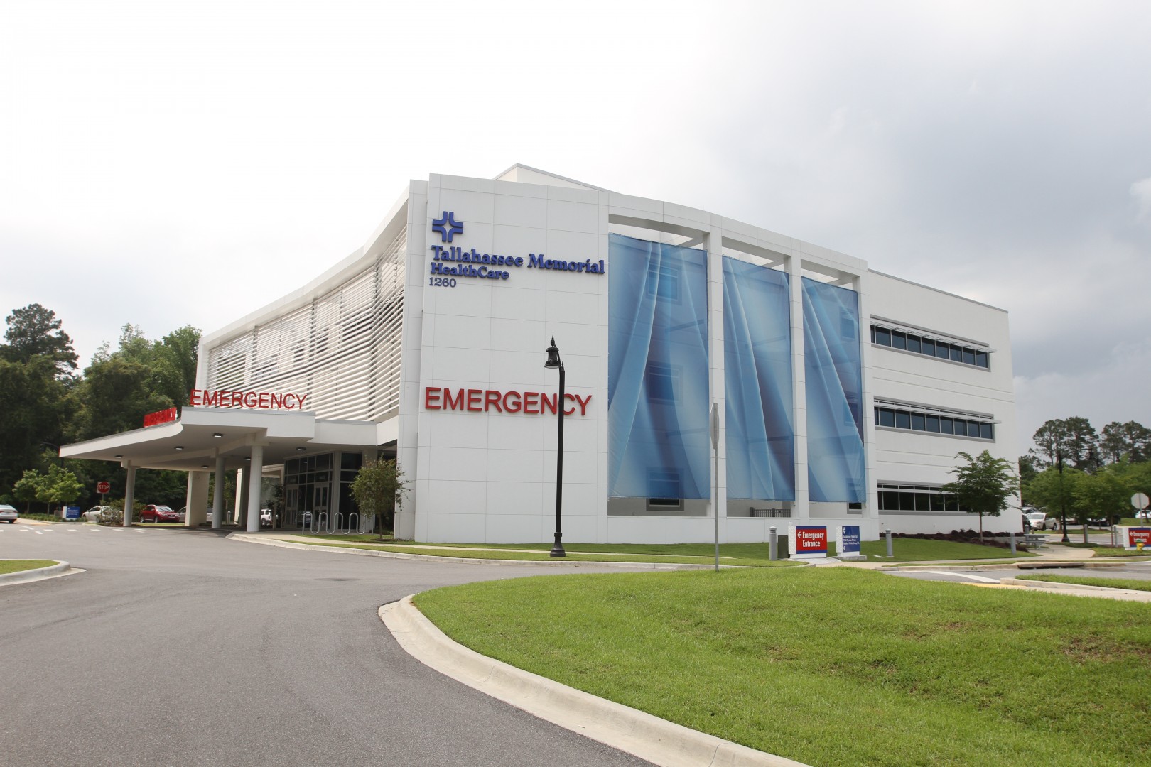

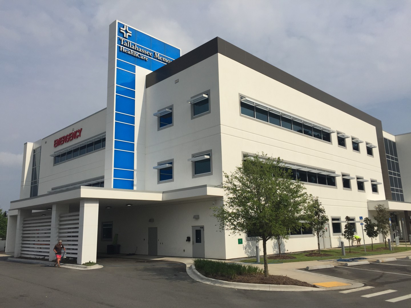

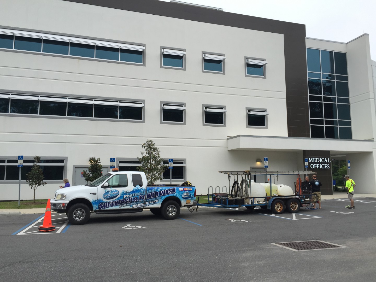

Photos form this weekend's cleaning of a hospital. Will write more about job a little later.
here's the video of the job.
