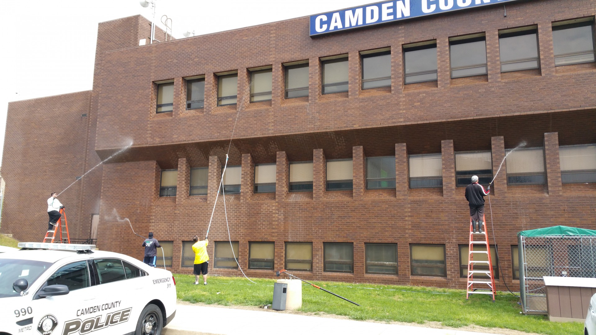

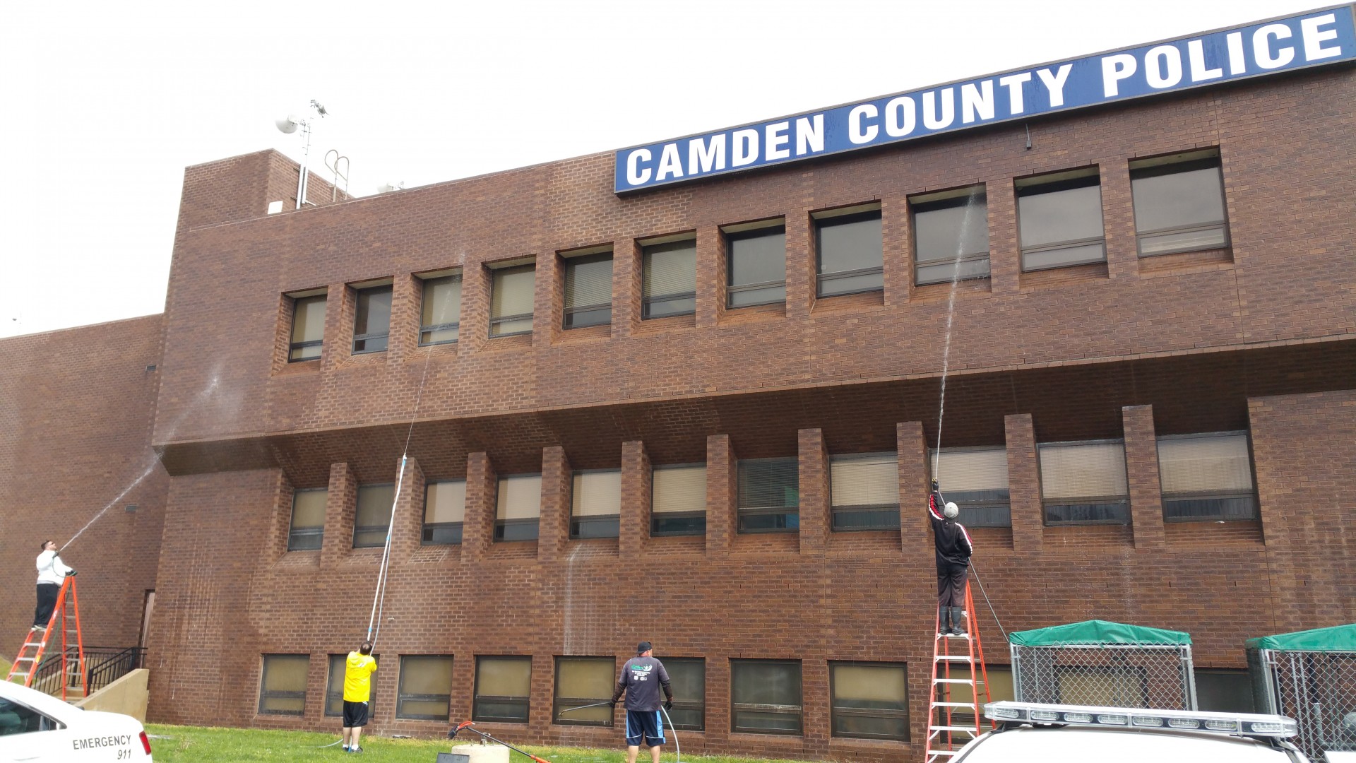

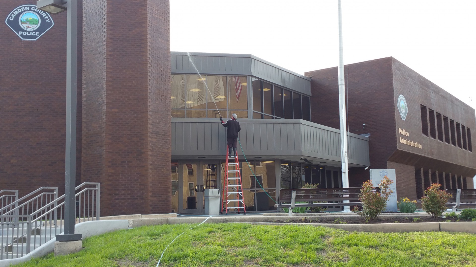

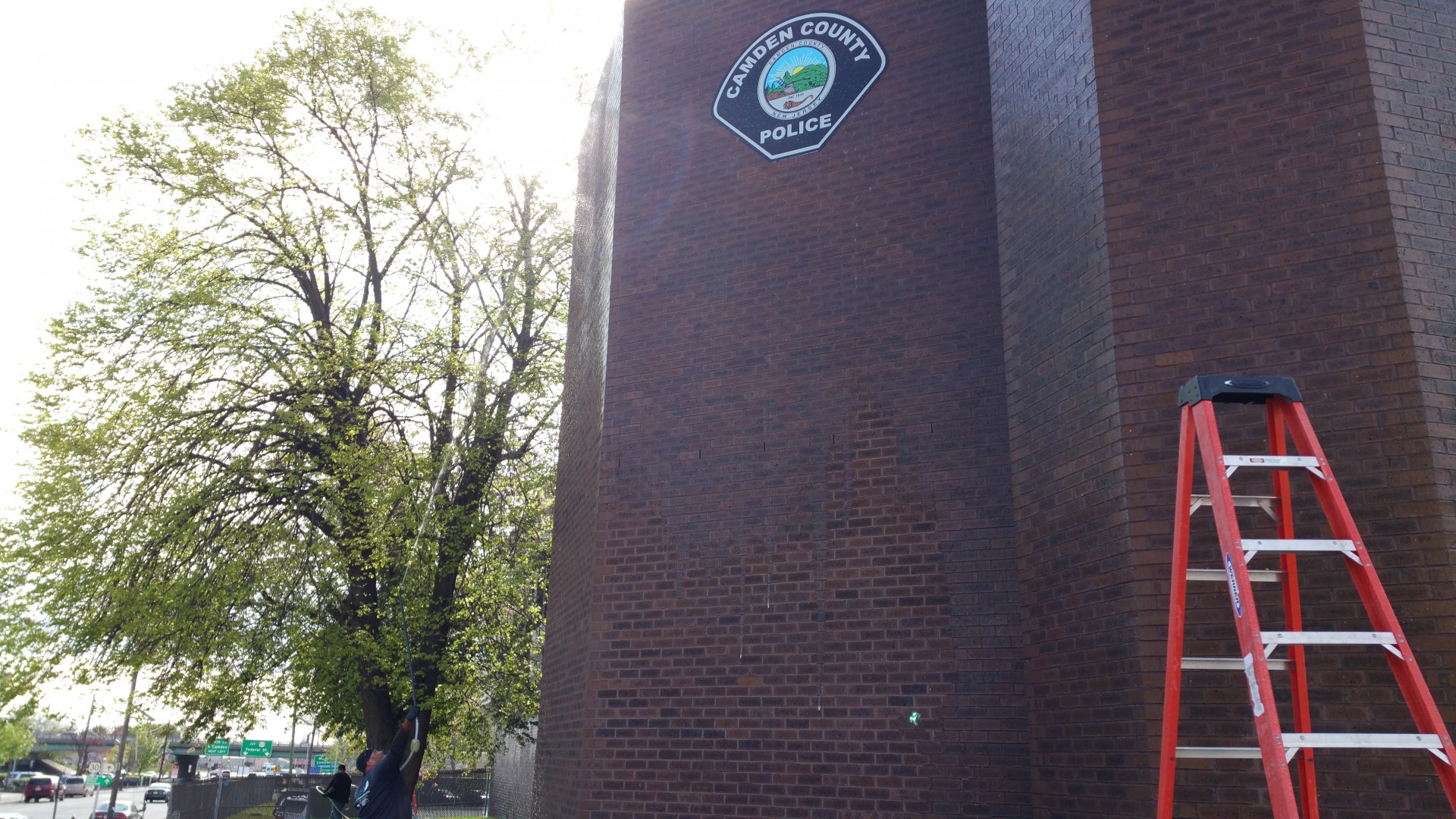

Yesterday The Roof Wizard's Crews softwashed the Camden County Police Station building in downtown Camden, NJ. It is a fully functioning police station with over 200 employees in side and the cities Central Booking inside. We started early and only disrupted one door at a time, to allow for flow of constant pedestrian traffic. We softwashed the whole building and cleaned all the windows. We used a 2% mix on three sides and a 3% on one side. One of the biggest challenges was keeping all the windows closed, as the employees inside wanted them open, with nice Spring weather. We were in and out in 6 hours flat and had time for a company lunch outing. It was nice to bond with the guys on a Friday afternoon and talk about things other than work.

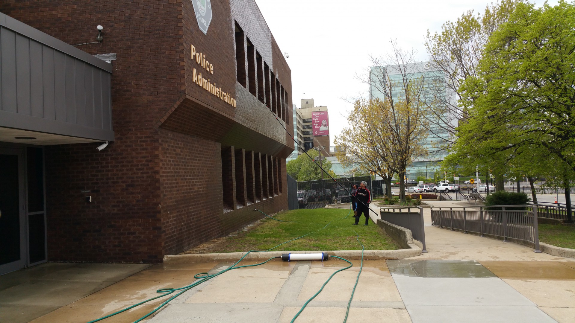

Nice job John. I like how they can spray parts of the building from the ground. What type of pump and size of hose are you using?
May 4, 2015
It's 1/2 inch line with a versa jet and or flow jet.

Thanks Dave. mike is spot on, one rig has a Versa Jet on it, which is a Flo jet pump. And the other has my last Pentaflex by Flo jet. After that one goes, that rig will get a Versa Jet. the hose is half inch.
just an FYI, he Versa Jets have always cost around $250 from PW Store, but I just ordered 3 more at the new price of just over $150 buck. You can't beat that deal.

John how many GPM is the pump?
$150 a pump is a heck of a deal.
6 GPM
