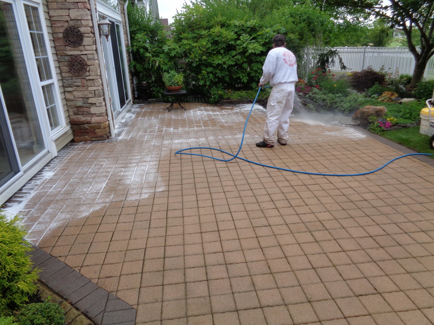

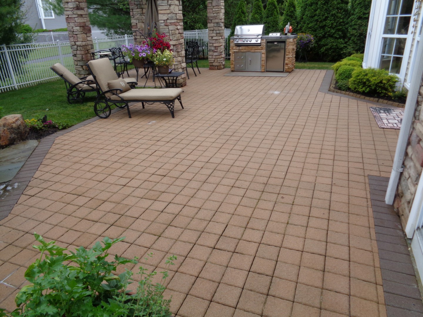

Heres a paver and House wash we did last week. Ted Sanders recomended us to a contractor in Huntington NY and he recomended us to this Doctors house. Networking works! One referal turned into $3900 in work.
Jun 15, 2015
When I got done with this job the Doc started raving that he had 2 good exterior cleaners Me and some guy Charlie that did his roof wash. He said we were keepers.
Jun 15, 2015
Lol! I just said I washed that guys roof a couple of years ago. Nice people, no bother you and paid right away.
Jun 16, 2015

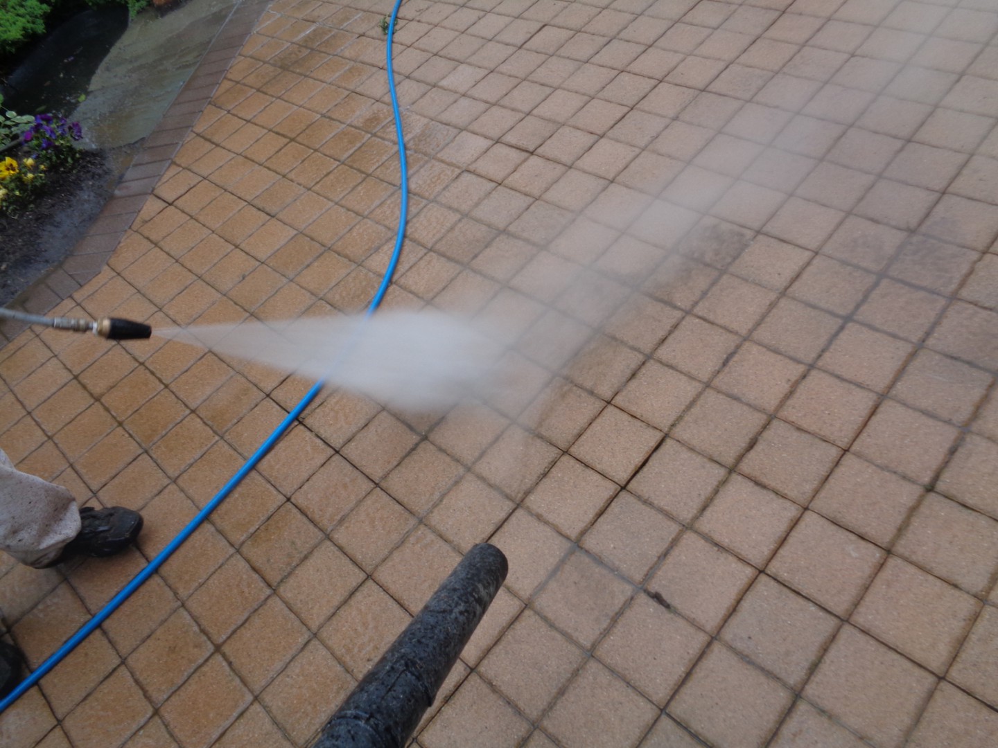

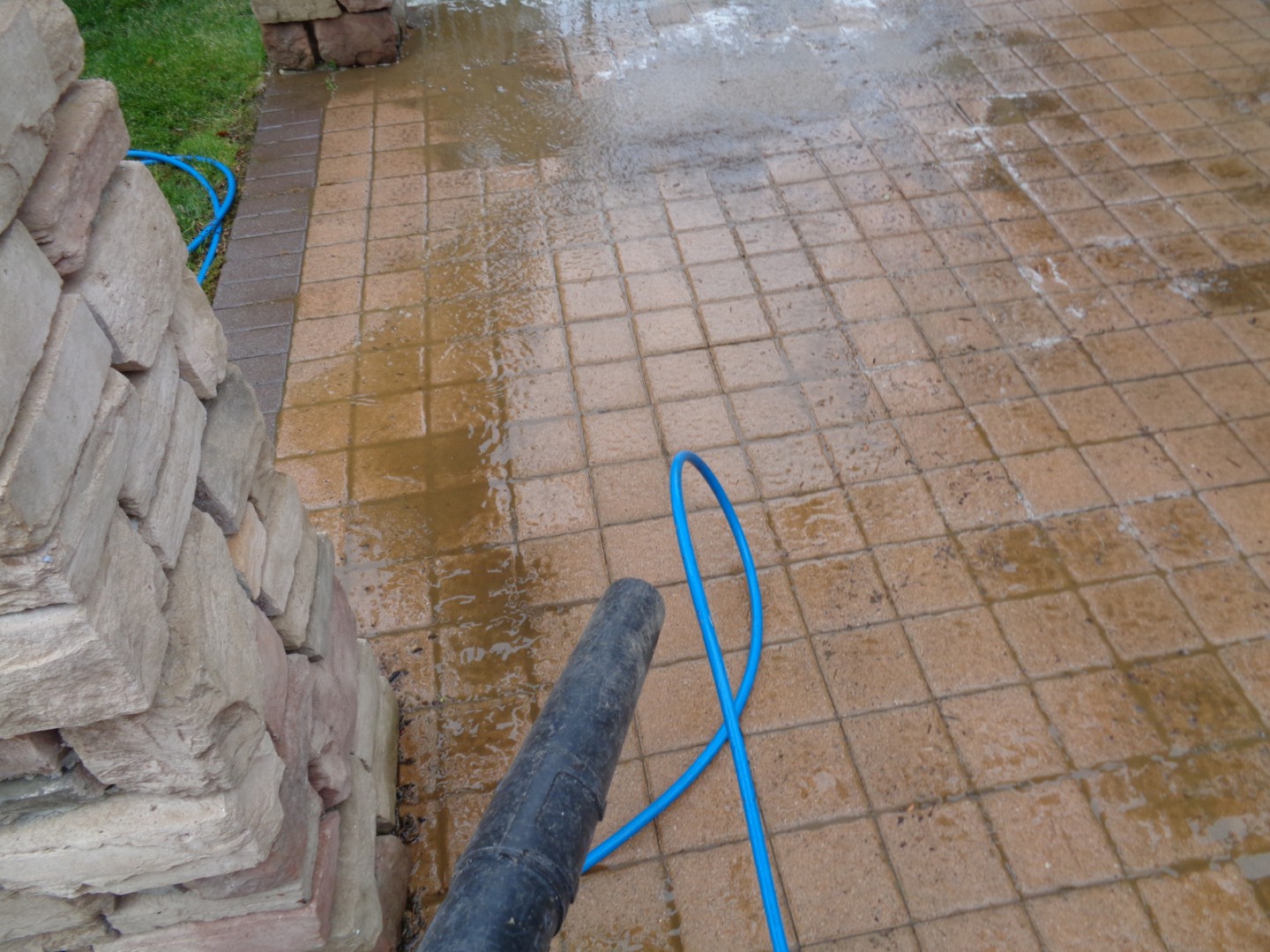

I learned a trick with paver. When we rinse we use a leaf blower also. Blows the muck and sand back into the joints and leaves the surface clean and dry.
Jun 16, 2015

Nice job Art! I was wondering why you were using the leaf blower lol
Jun 17, 2015
Try it you will be surprised by the results

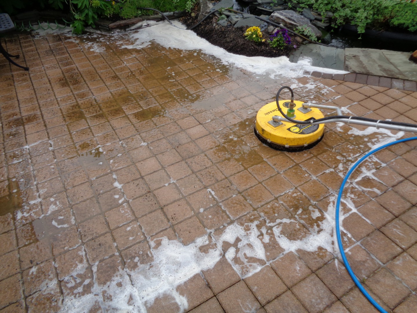

Art,
You used a pressure washer, surface cleaner and SH?
Didn't the surface cleaner pull out the sand?
Jun 17, 2015
Not really, I only us 3500, psi. Two guys rinse, 1 with a turbo and the other with the blower. The blower pushes the muck around real nice and I tell the homeowner I don't do sand!!!
