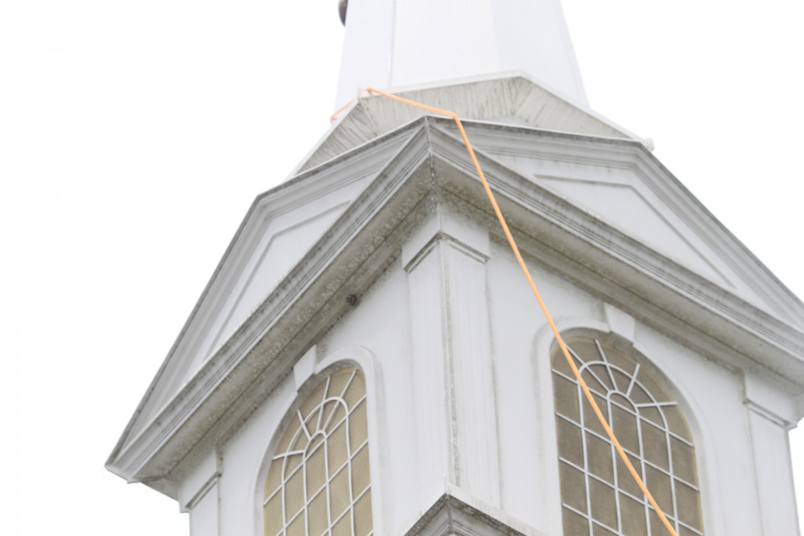

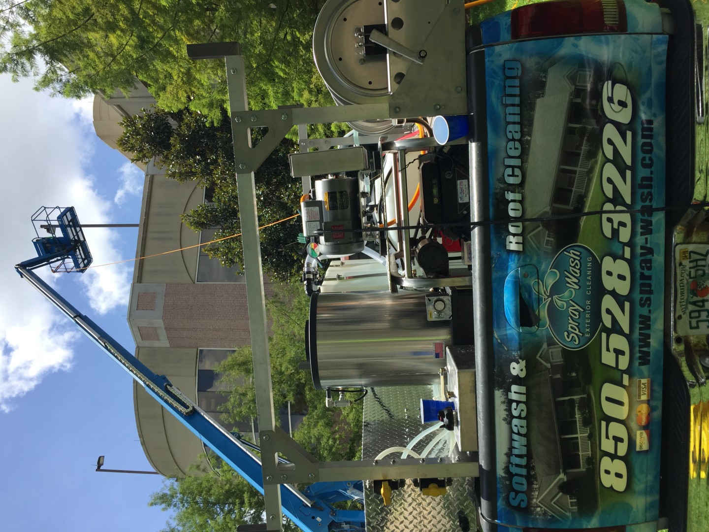

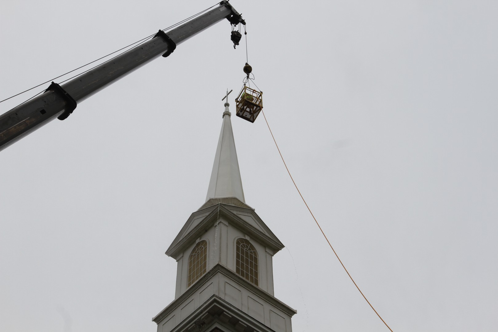

Not making this a promotional post until I have the whole job completed. Just wanted to update the forum on this job. I cleaned this steeple 3-4 years ago, and now its time to do it again. This time I'm using my Water Dragon with the electric Udor pump. The steeple cross is over 100 Feet. Crane had 130 feet of boom run out for us. Had plenty of knockdown pressure at that height. First time I did this job it took me 3 hours of basket time, this time it took only 1.5 hours, so very impressed with the speed difference. There was much less lichen to remove, so that did count for some of the time difference.
Udor performed flawlessly. Its going to get a work-out, as this time we are washing the whole campus of this property
Also, using a new product from JRC on this project. Its a Chelated surfactant/detergent. Seems to be working pretty well. I had one crew on one side of the Church using our usual mix and one crew doing the other side using this mix "Pro-Tool Stick".

Hey Ray how do your guys like the Udor compared to the Booster Pump? And I see your using a garden nozzle on the odor like you do on the Booster??? Is that working out too??

Doug, hands-down they love it better than the booster pump. Garden as it works perfect for long-range jetting!

Andrew it is for both application and wash down. adjustable pressure from 50 PSI up to about 250PSI. flows up to 10-12 GPM
