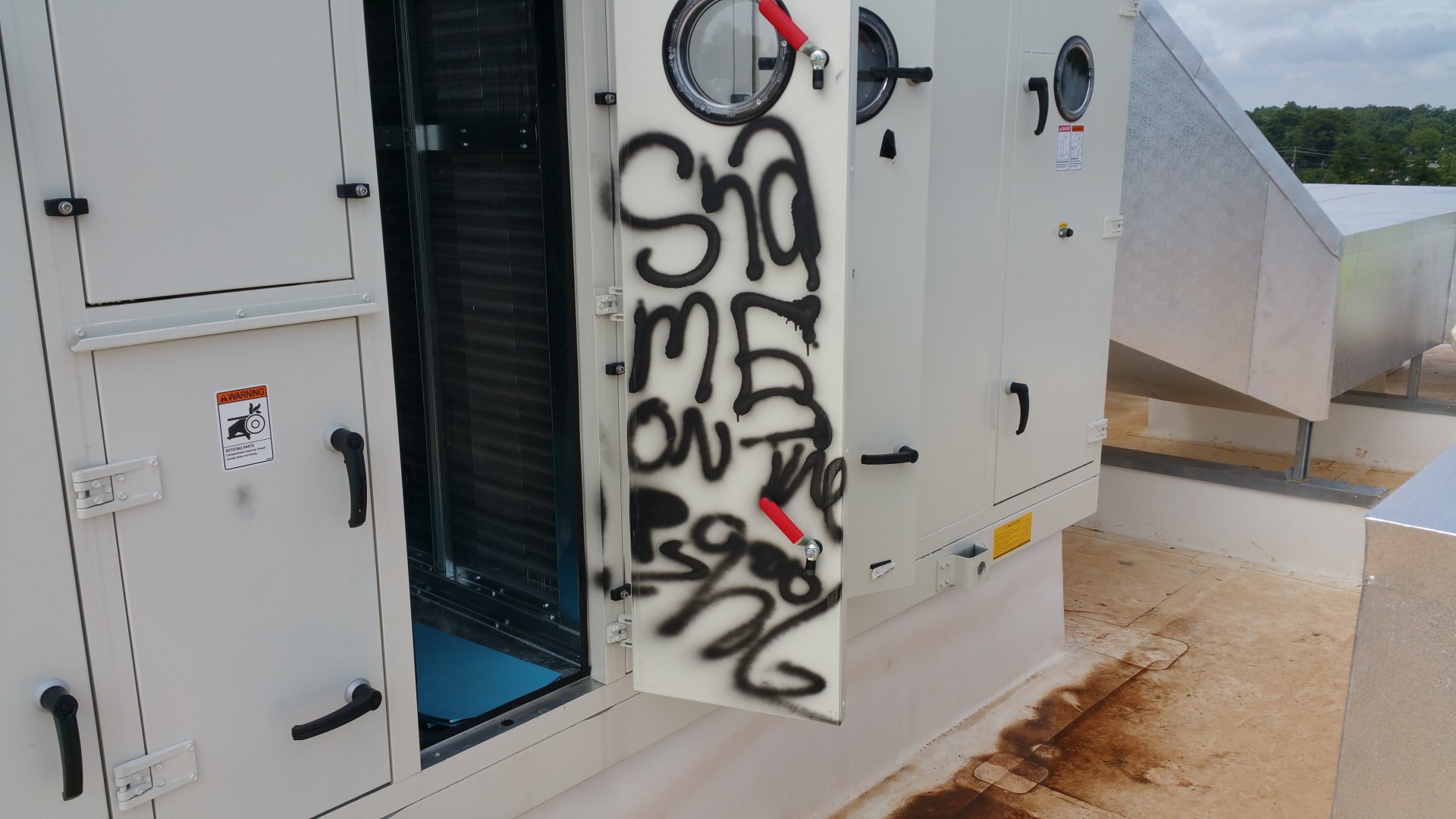

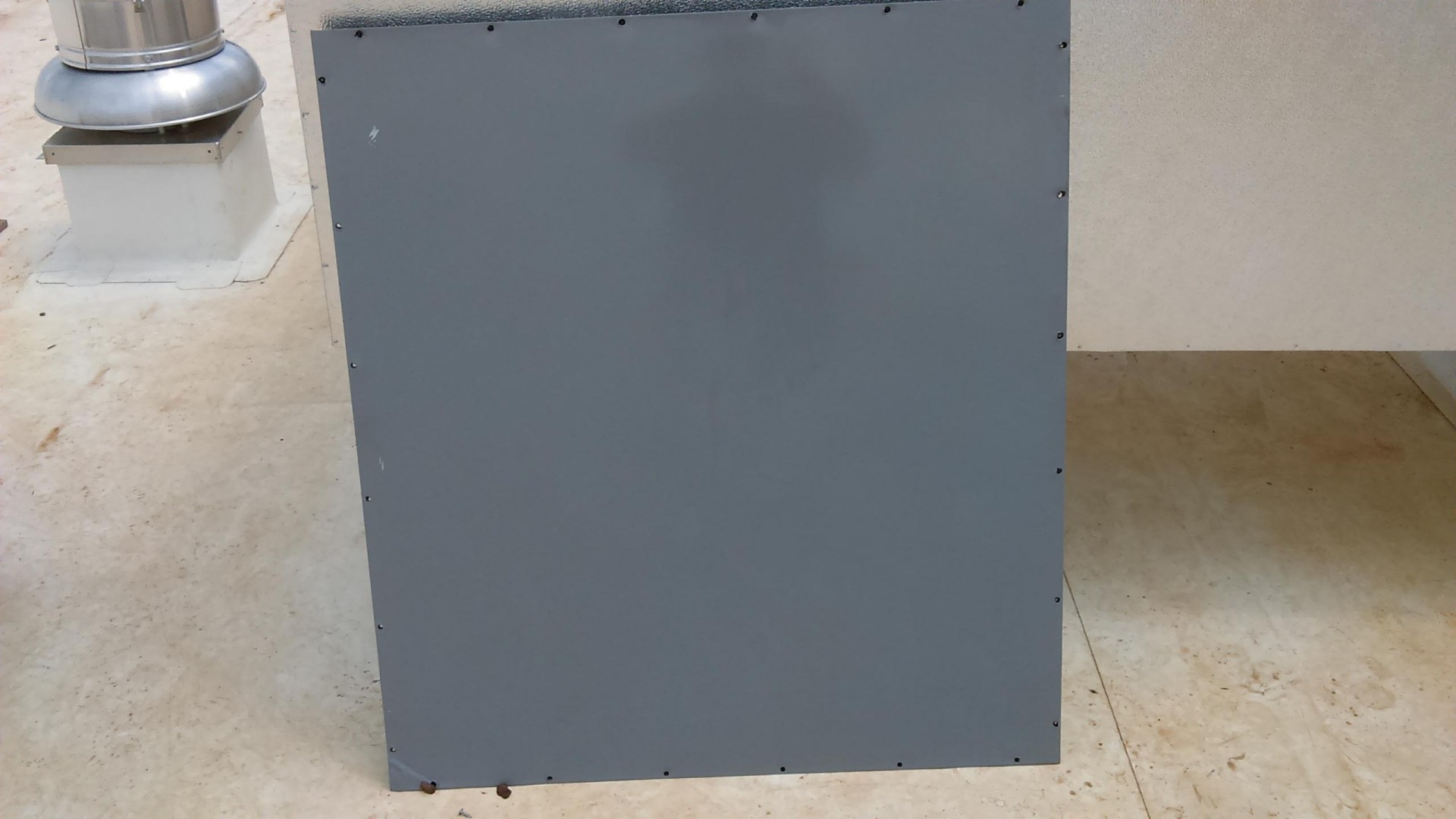

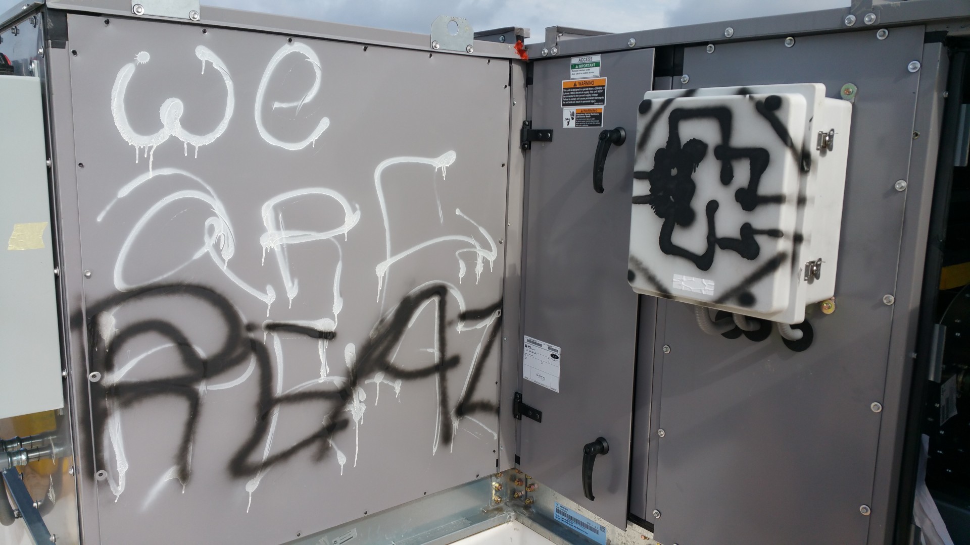

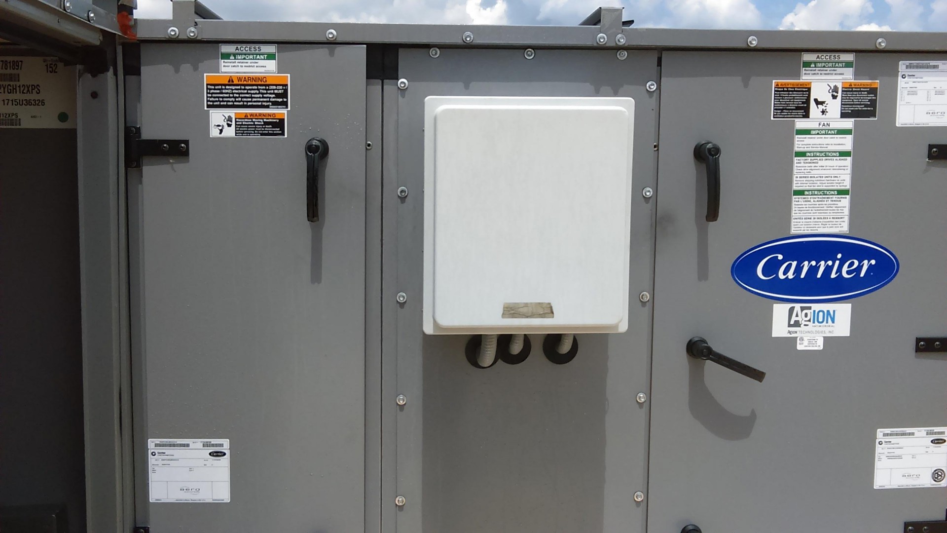

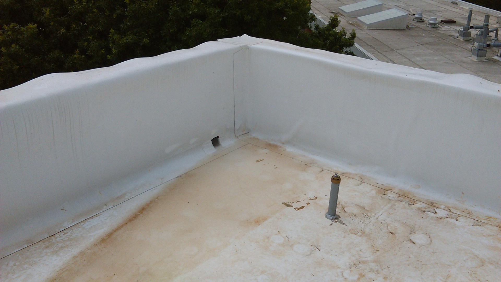

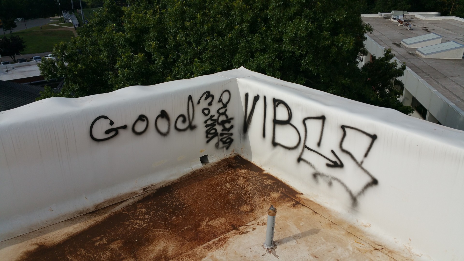

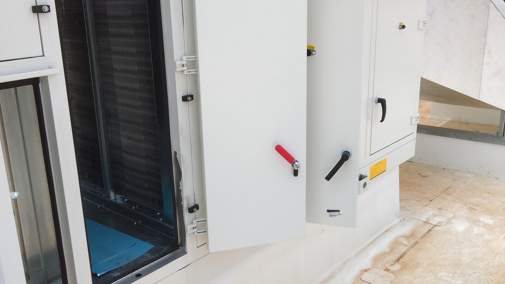

Here are some pics of a small graffiti removal job we did recently at the Pennington School, just outside of Princeton, NJ. Most calls we get for graffiti are on masonry surfaces, but this was a little different. This is a new construction building on the site and the areas tagged were some of the parapet walls, on the TPO roof system. The inside and outside of the AC Units, on the metal and plastic surfaces. And also the interior of one AC Units duct work. We use Taginator on masonry, so we used their product or smooth surfaces, Tagaway. It worked like a charm and we applied it with spray bottles and wiped with rags. Some areas took a little more elbow grease than others, but we cleaned it up like new.
I have been using Taginator for the last year or so. We used Tagaway, which is made by the same company for smooth painted surfaces. I like it because I can pick it up at a local paint store without any shipping costs, plus it works great.

Great job . Looks like roof could be cleaned too ;) just little upsell thought lol, but I'm sure you're working on that.
Jul 31, 2015
I have the PO to go back when the construction is done and clean the red clay dirt off the TPO.....funny because they actually had that in the specs as well. This GC is pretty proactive and knows about softwashing.
