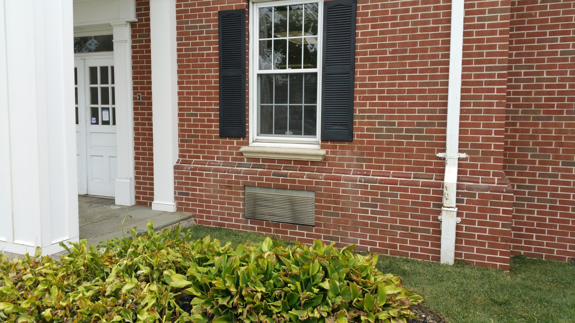

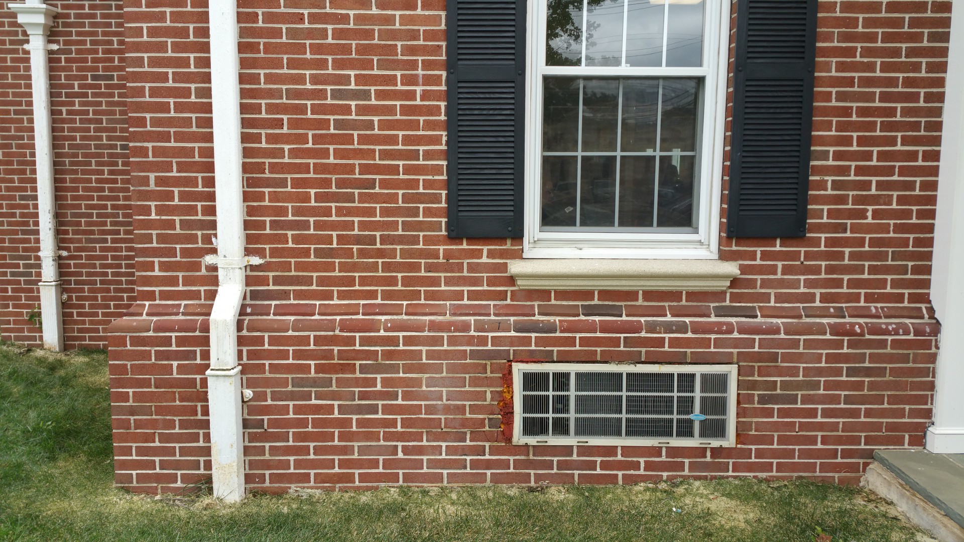

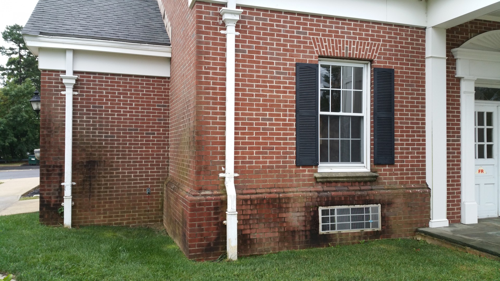

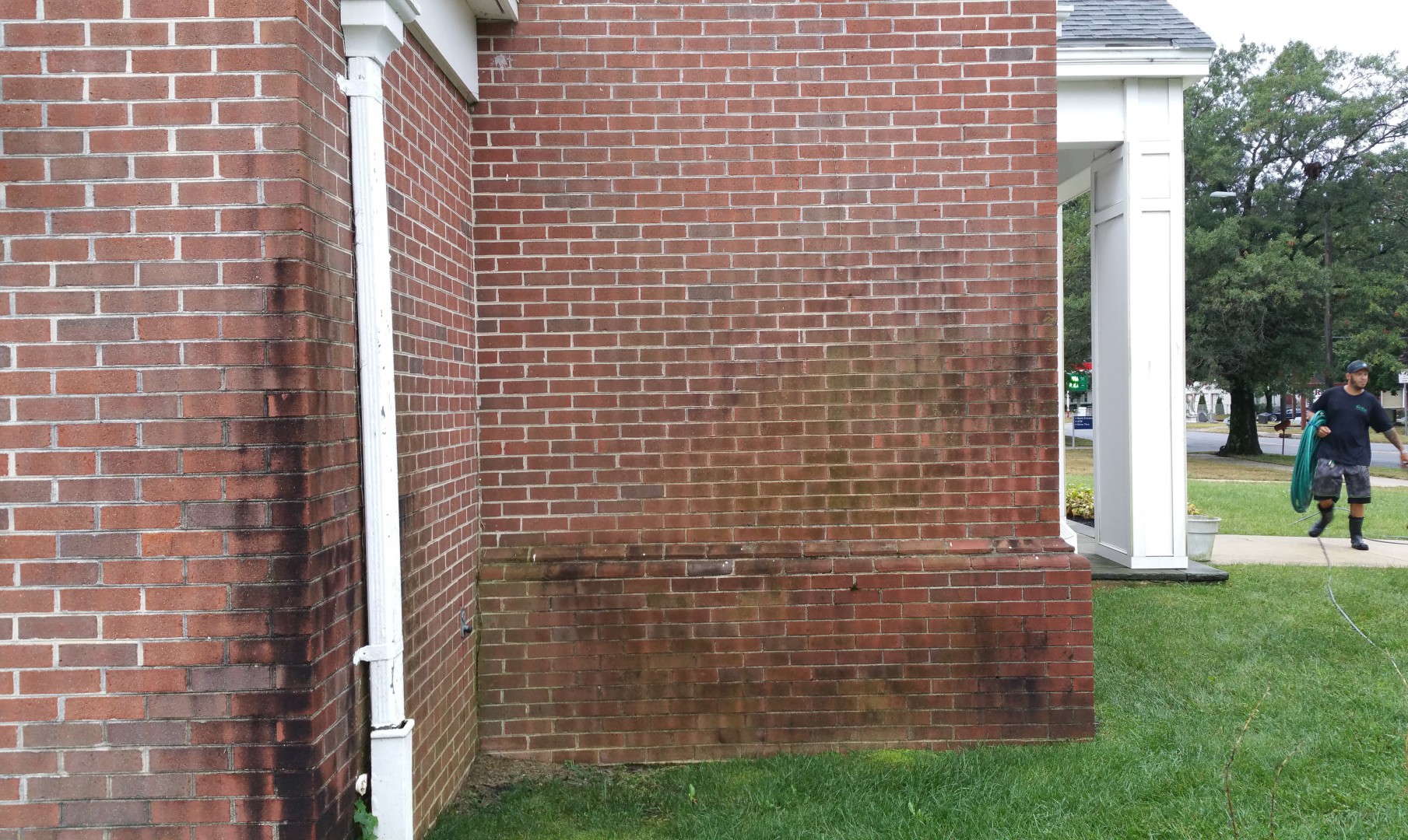

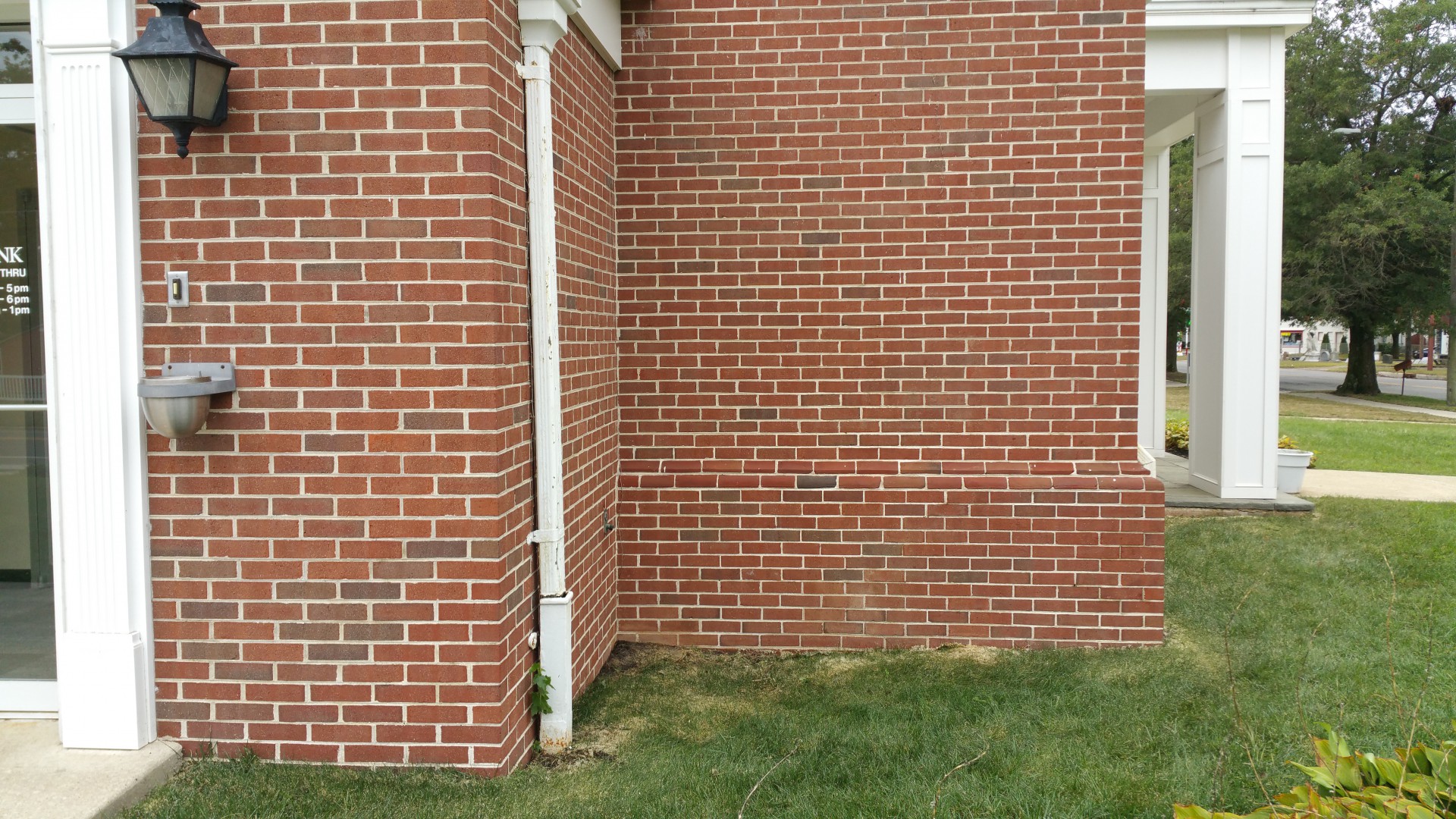

The Roof Wizard cleaned up the Hammonton Branch of Cape Bank this week, before they have the official "Grand Opening". The building is 50+ years old and constructed mostly of brick. The property manager did not want any cleaning method could knock out or damage the old grout. After a small softwash demo, a few weeks ago, we got the go ahead last week. As you can see the black mold and algae was built up for years on the North & West sides and along the sprinkler line areas. We also cleaned the drive thru canopy and concrete islands, with a softwash process. The concrete had some minor rust stains, which F-9 made easy work of.

John, what mix did you use on this brick? 2% or 3% Sh mix

We used mostly a 3% and some 4% on the bad areas.
