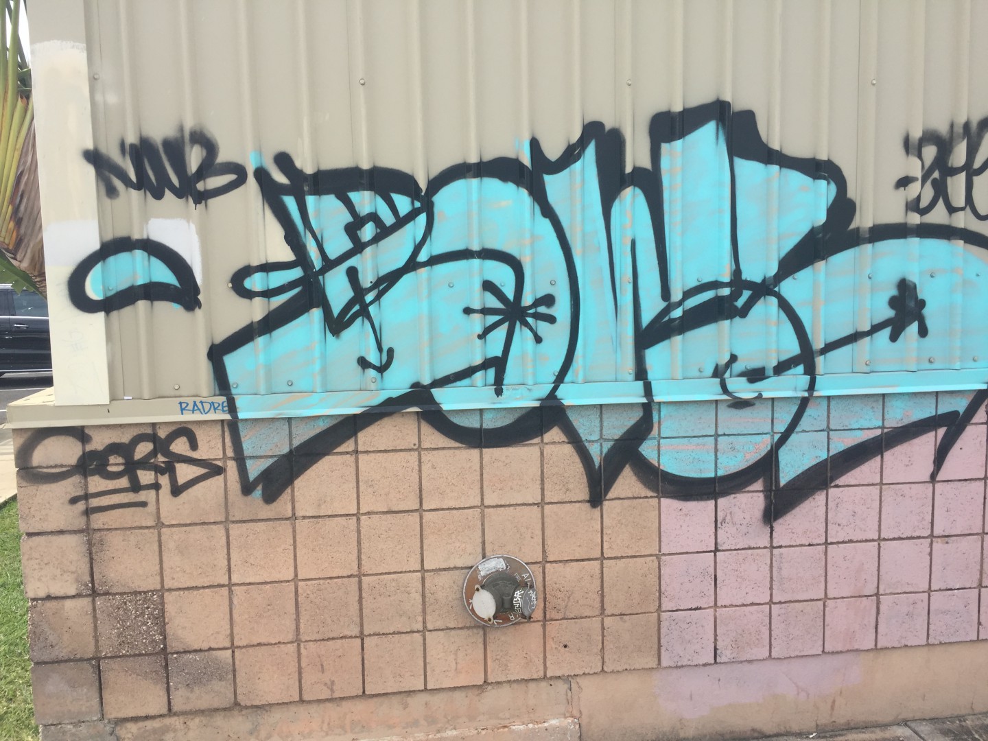

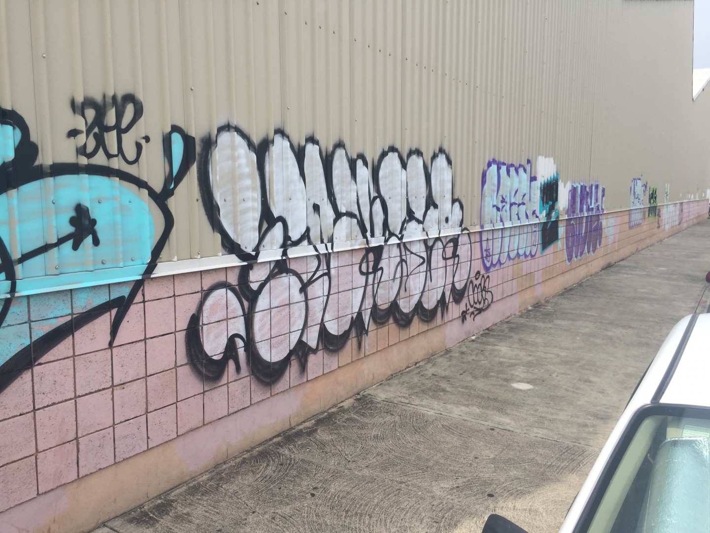

Aloha guys I have a possible big graffiti removal job demo to do. I will be using worlds best graffiti removal on this job. My question is not sure how to charge this one or how much Chems it will take. I figured a flat rate fir first 10 ft then additional on each ten ft square. Also with it being on both metal and concrete will I need the delicate surface cleaner it can I use just concrete one. Any help would be great.

Fora job like that, I charge what I want to get. If I don't get what I want, i don't do it.
With the metal you are going to need to be careful if it's oxidized, and my guess is it is....also looks like someone took a turbo or something to that tile in the bottom of the first pick.
I would probably use Sensitive on all of it, or even a mixture of bare brick and sensitive. You can talk to Adam at Worlds Best and he"ll help you on the mixture ratios. You can even text him the pics at 8052848686 and he"ll help you out. He's the owner and a great guy.
If its me I charge about $2500.00 and I do a test spot first to make sure I'm going to be successful and that they are going to be happy. I also up sell them on the anti coating for another 300-500. Oh and Hot water will be needed on this job.

Thanks Doug I was hoping you would answer. I've been so busy I haven't called Adam yet but I'll send him an email tonight. On the dollar rate I was thinking a bit more cus I'm here on the island but that was my low rate what you said thanks so much guys
