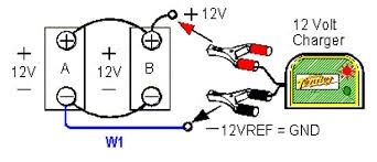

You increase the capacity. It's like trying to clean a 2000 sf roof with a 25 gal. tank. Add a second tank and you won't have to remix. Here is a quote from Battery School... "The final voltage remains unchanged while the capacity of the bank is the sum of the capacities of the individual batteries of this connection. Amp-Hrs, Cranking Performance and Reserve Capacity increases while Voltage does not."

It is very simple...If you run in parallel you can run pretty much as many as you want and the voltage stays the same. It is when you run in series that you increase the voltage.

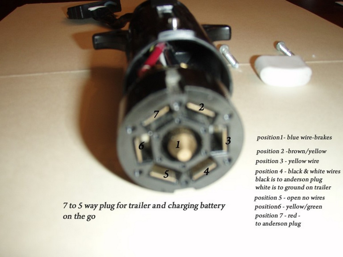

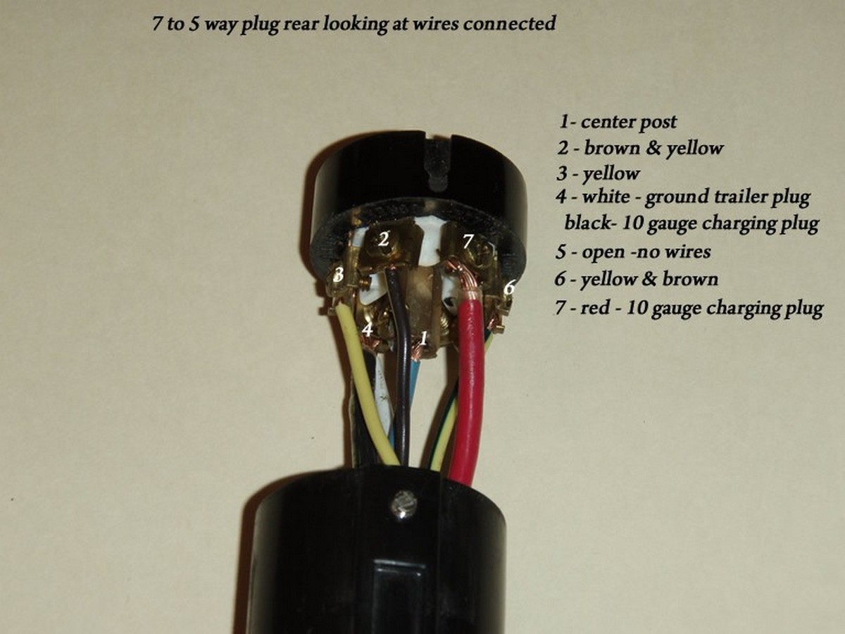

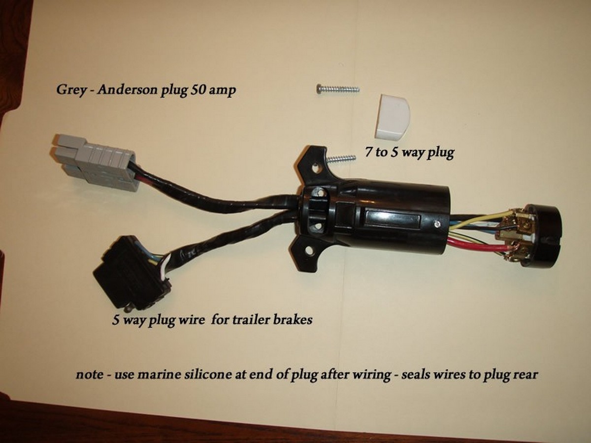

Nice detailed pictures! That will be a big help to those pulling trailers David!
Just trying to help David
Not sure. Click on edit, swipe it and the pic turns blue, grab a corner pull it in.
