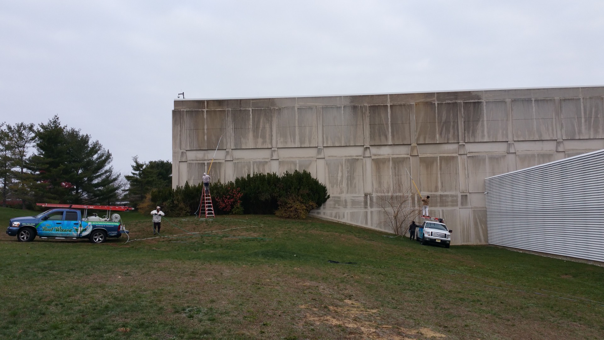

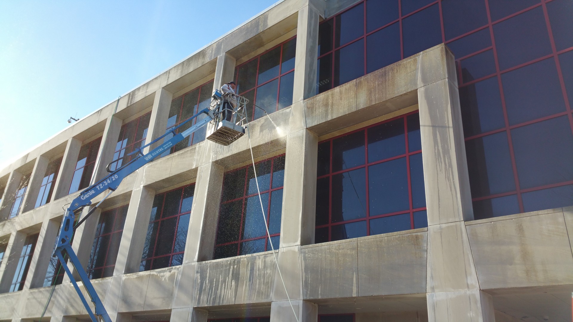

Here a biggie that we started yesterday for Verizon. Temps are in the high 20s this morning when we started spraying and the wind was 25mph plus yesterday. Today we are getting a heat wave....should be 46 by noon. We have just under 100,000 square feet of limestone to clean, 16,000 sf of equipment screen and 12,000 sf of sidewalks. Needless to say the weather is betting us up pretty bad but we should be done in the three days we planned on.

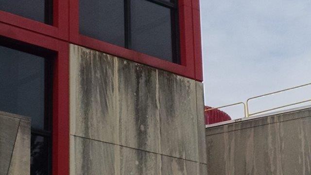

Very nice John. What are you using on the limestone?

Thanks Ed. We are using a regular softwash mix anywhere from 2.5% up to 4%, with 4-8 ounces of Fresh & Clear in the mix. Using just Green Wash and also 60 ounces of Wash per 50 gallon mix tank. So far in two days we went through 540 gallons on SH. Hopefully finishing tomorrow.

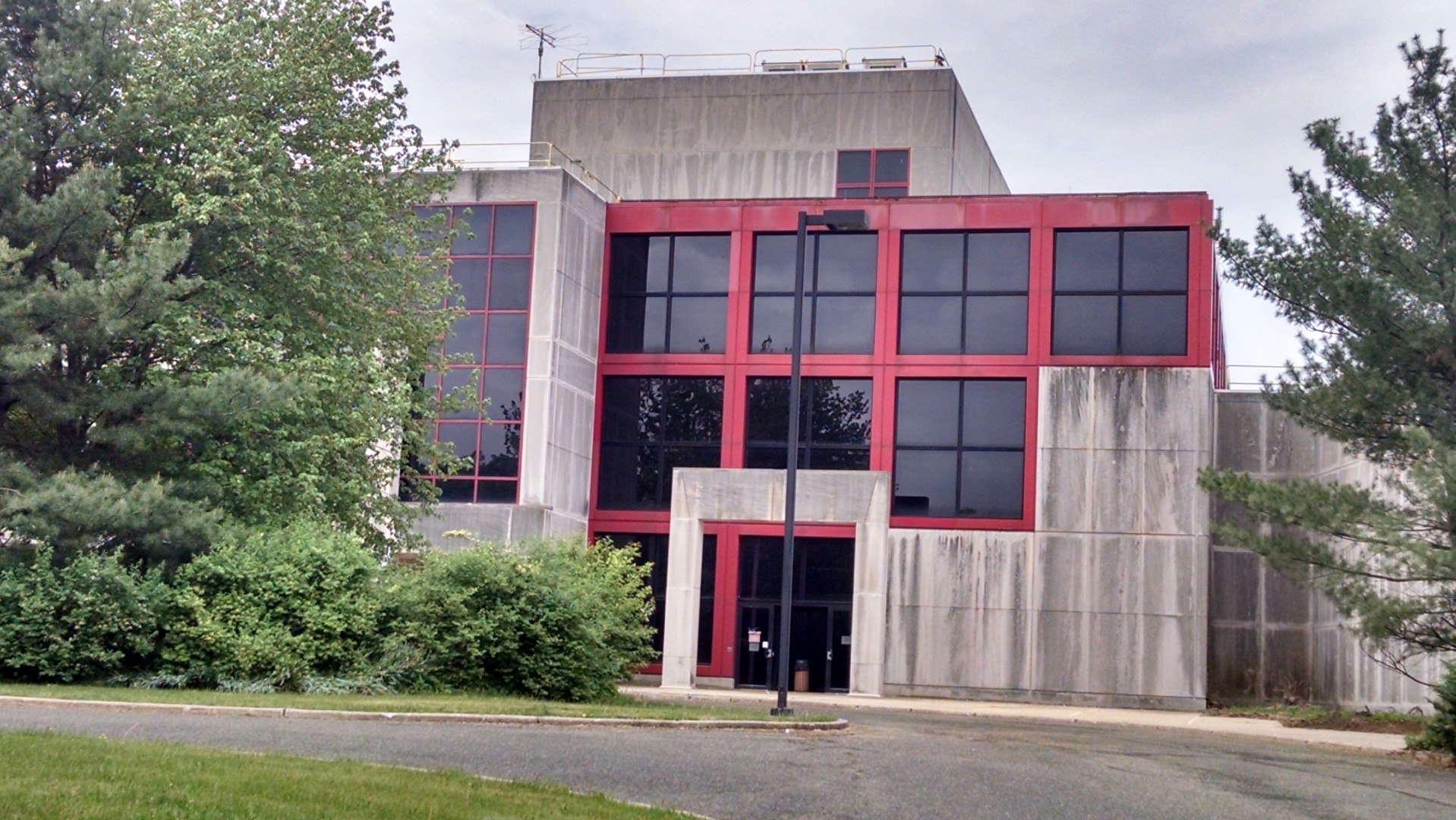

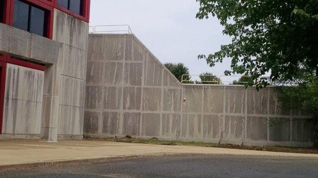

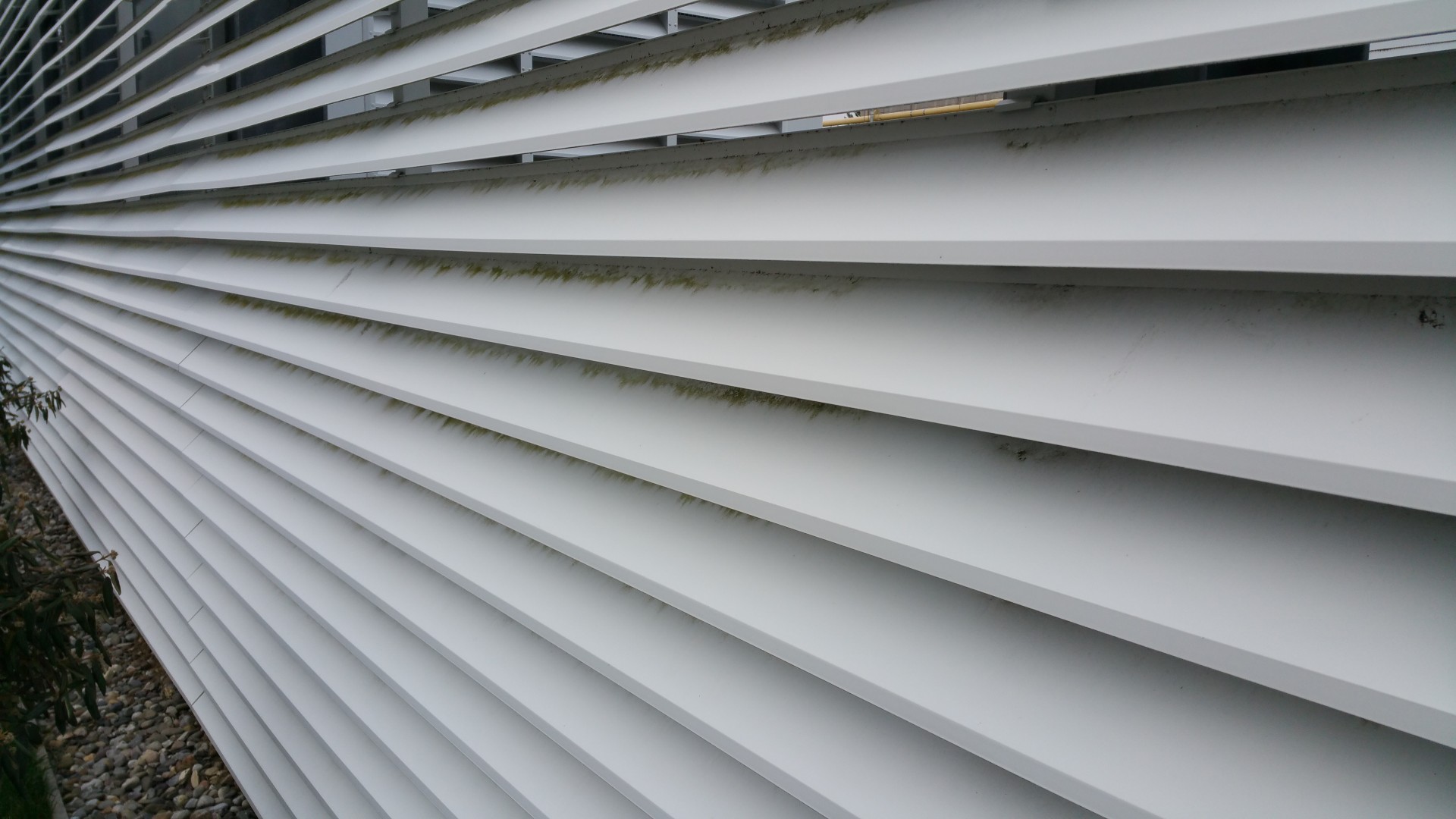

Heres a few of the before pics from when I did my estimate. I will post some afters over the Holiday.
That is 60 ounces of Terra Wash. Not sure why spellcheck omitted it.

Looks great John, are you using hot water an or downstreaming or you just using the "yellow monsters" with softwash pumps?
I never used the extension poles for softwashing but if it works I'm game. The guys don't like to use them because they can't handle them (PW'ING) but I can and blow out 3 storie house washes in a 4th the time with only one helper and no ladders, if I can softwash by pole that's a plus

Thanks Maverick. We softwashead the building. Those guys are only using those poles for two reasons....one of them was the wind,. It was blowing 25 mph, usually we can hit most three story buildings from a step ladder. Second, we usually use a carbon fiber pole for weight issues, but I has another crew on the other side of the job washing windows. i have three of those WF pole guns and we use them all the time for high house washed. For roofs we have used them for hard to get areas on non walkable roof.

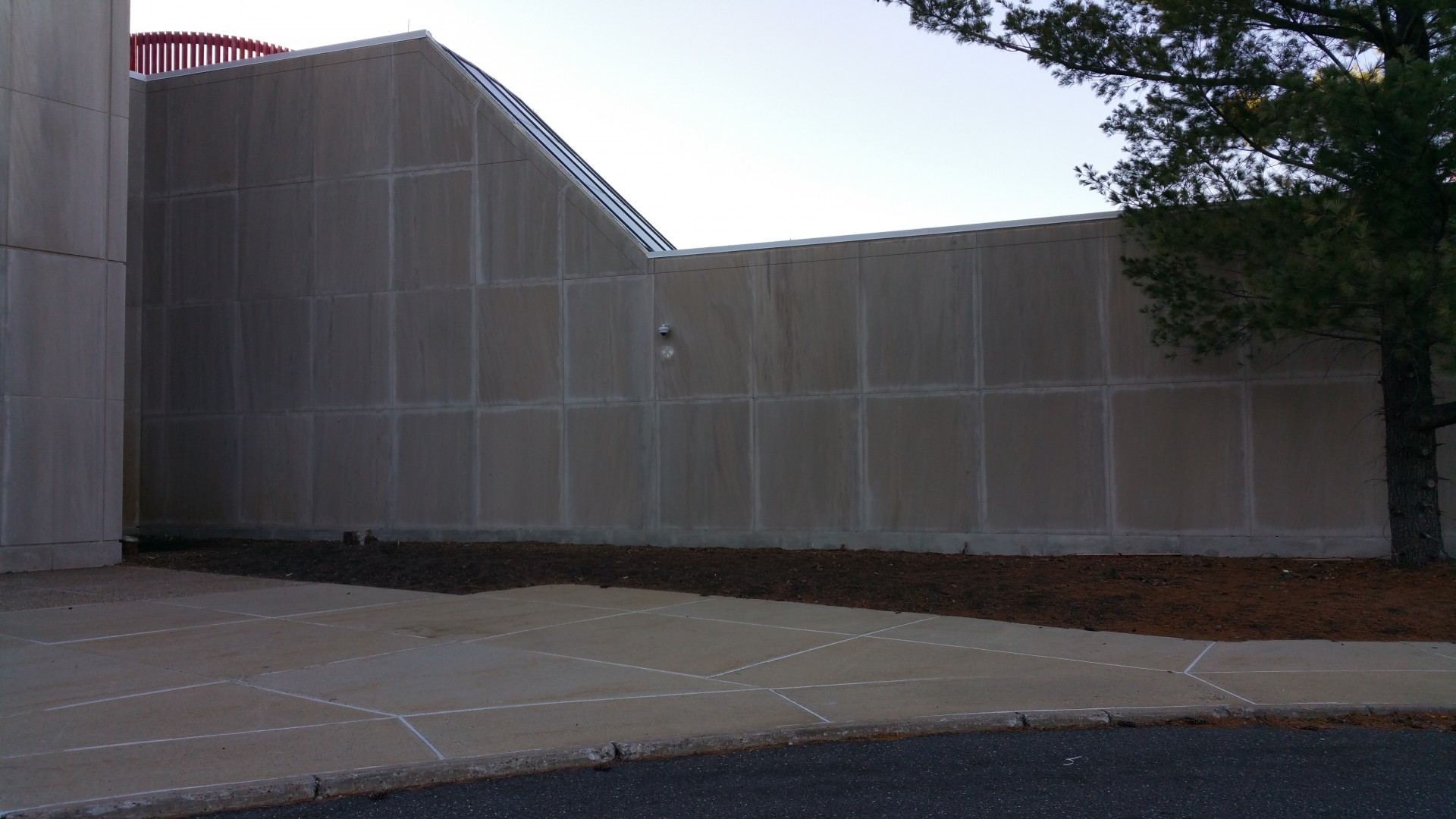

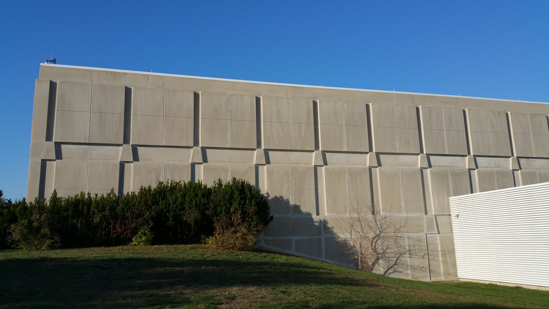

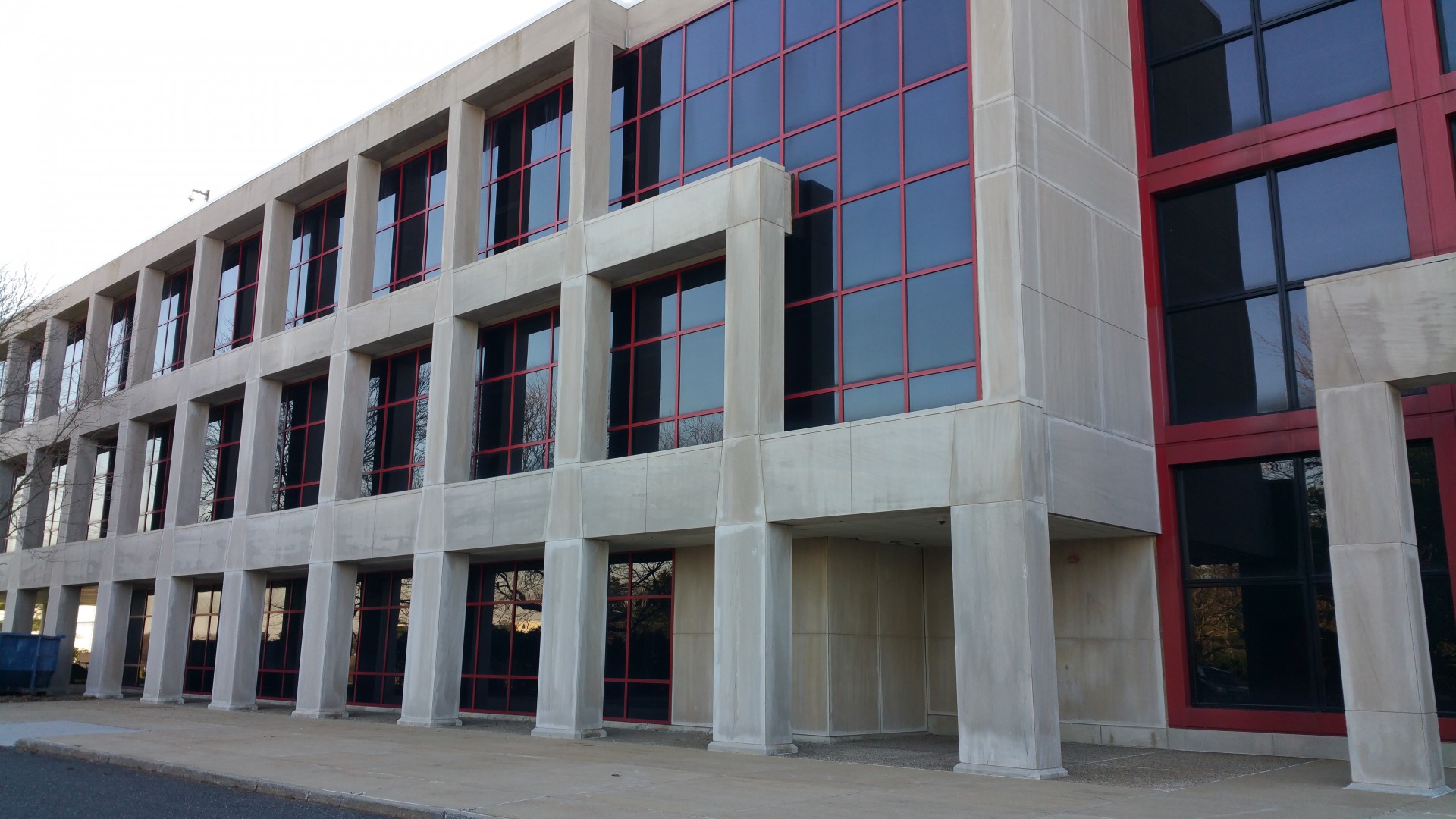

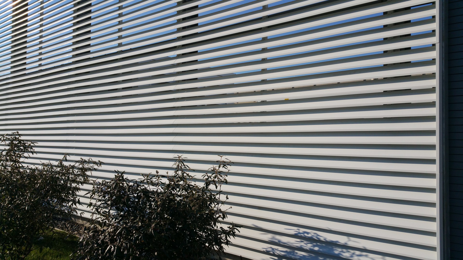

Here are some after pics. Job took three crews, three full days to complete. We use just over 700 gallons of SH in the process. Only part that kind of stunk for me, was the deer I hit on the way home Wednesday night around 8PM. I was only 8 miles from the shop too. Wasn't fun either, because I was towing the 40' lift as well. Good news is that Verizon & the construction manager Tishman Const. were very pleased and we are supposed to start a Macy's Dept. Store for them in the next week or so. Hope the weather holds out!!
