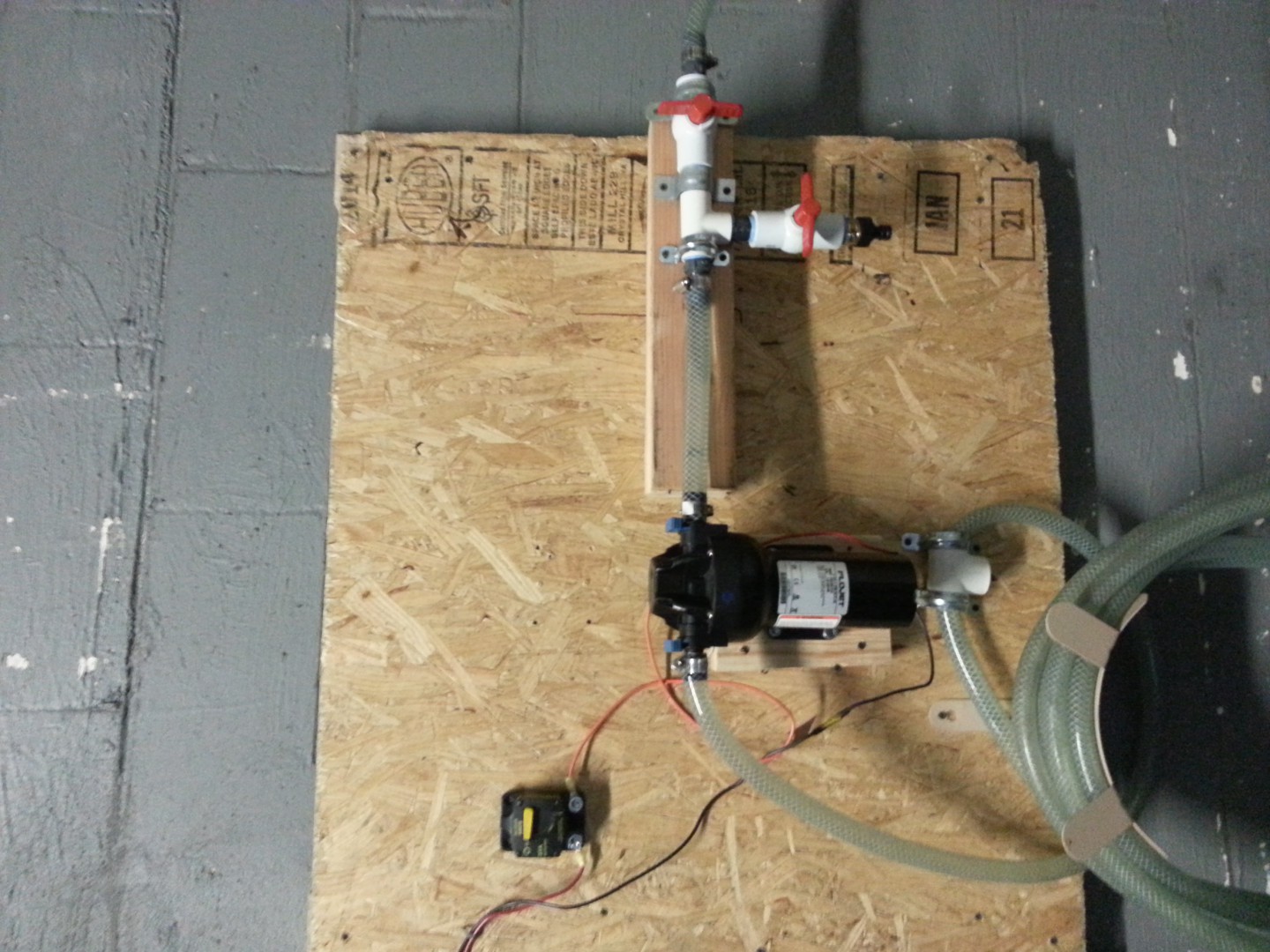

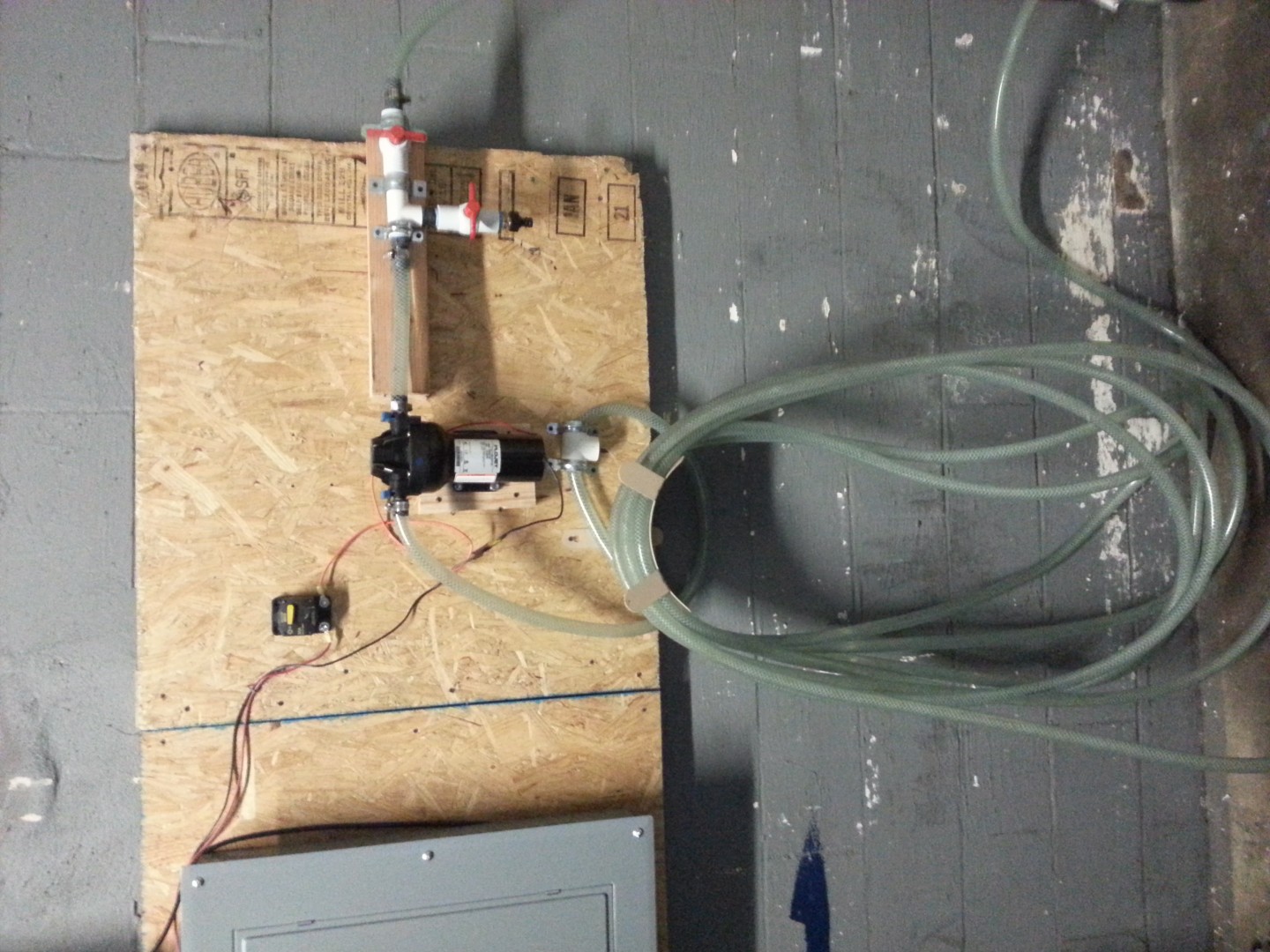

Here's a pic of what mine looks like. Only thing I have changed is the pump.
