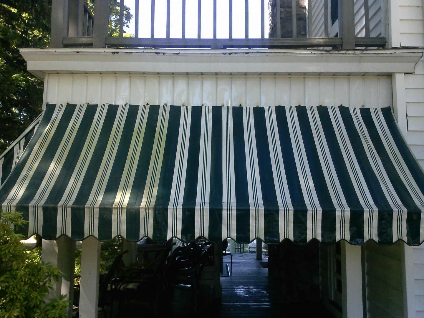

something that small and not that dirty, you mig just want to use Dawn and warm water, with some elbo grease. That is if you do not want to worry about taking the waterproofing coating off. Should clean up fine with a soft bristle brush.
Dec 18, 2015
Thanks John
Feb 6, 2016
John thanks for the advice the awnings turned out awesome and I landed weekly and monthly work for Chanel. They loved it.
Feb 6, 2016
Thats great. what did you wind up using? was it just dirt or was there moss, algae and lichen?
Feb 6, 2016
Just dirt. Warm water and dawn worked awesome.

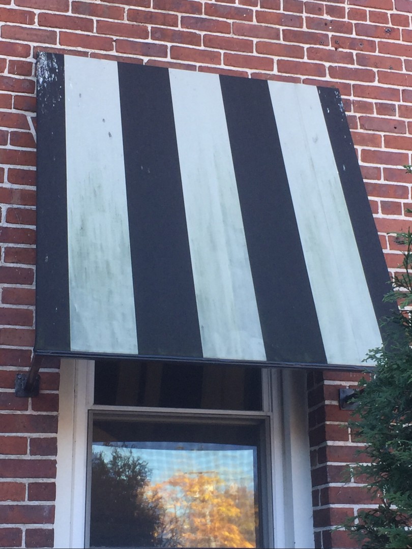

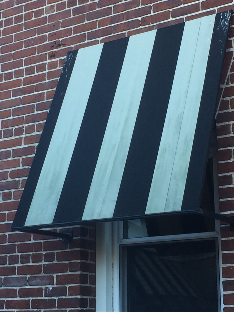

I did some work for this Customer prior, he asked if I could clean his awnings I said sure. I Bought AC 12 and followed the directions,wet first 5 t0 1 mix and had no results. I then tried Sh mixed ...it got rid of the green algae and lichen but not the black stain. I even tried SH straight and nothing. I even tried AC 12 straight and nothing. It was 62 degrees outside and this Awning is in the shade. First two pictures show prior to any cleaning.....third is after trying everything.....every time i used a soft brush and elbow grease....I even tried a stiffer brush and nothing. Any ideas? Thanks
I would be REAL careful using SH over 1%. You might even be surprised if you return a day later and find it looks really really bright.
SH will eat the thread and fast.
AC 12 mixed 5/1 or so works really well. I generally add a dash of SH and a soft bristle brush. Agitate then rinse. Depending on how bad you just need to repeat the process.
Nov 8, 2016
I have done it...wont budge
Nov 8, 2016
Pat,
Here are few we did. Both had not only black lage but lichen too. We pre wet fabric and apply a 2% mix with EBC as a surfactant. Brush and rinse thoroughly. Reapply if needed but keep rinsing after.

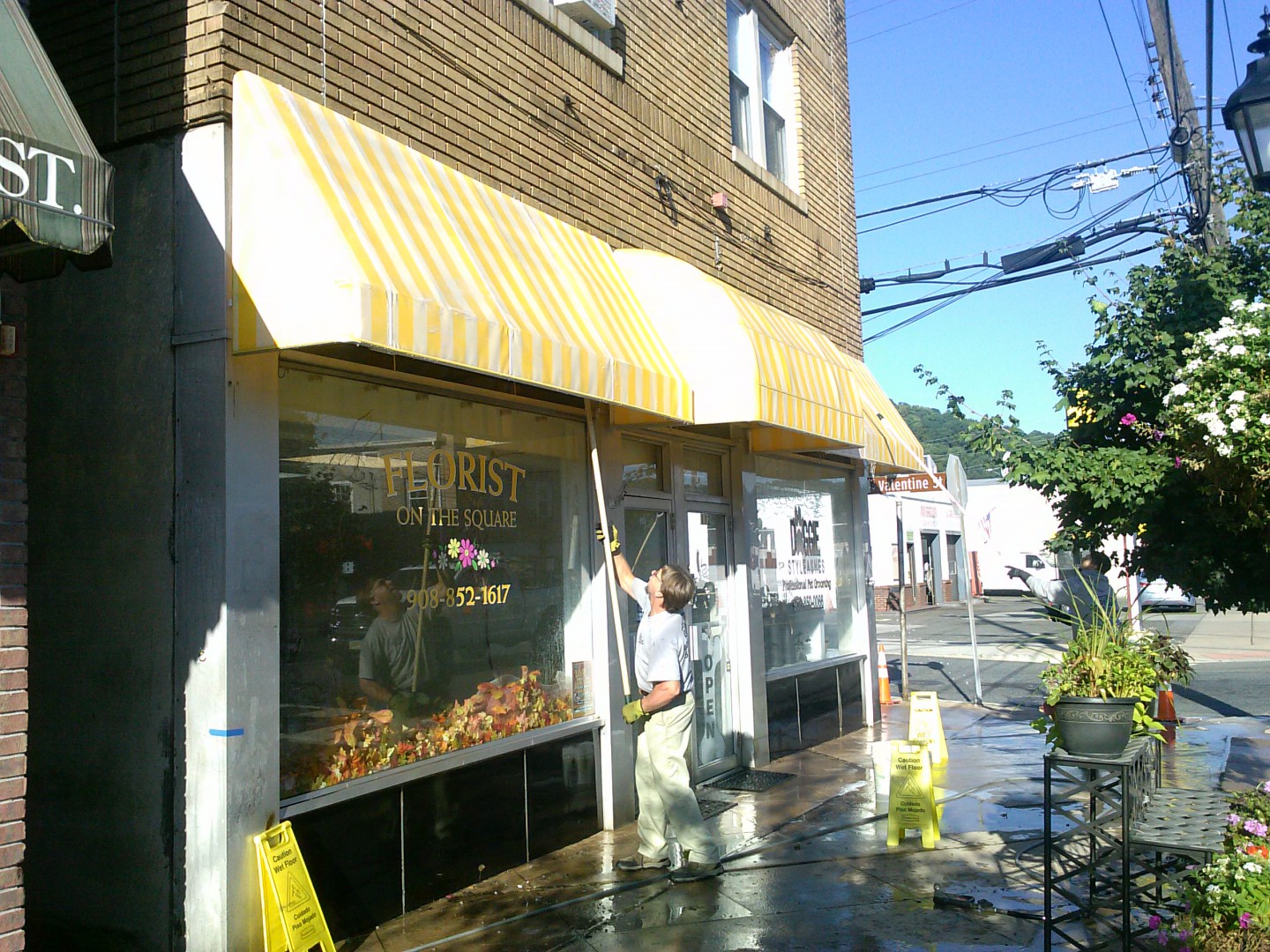

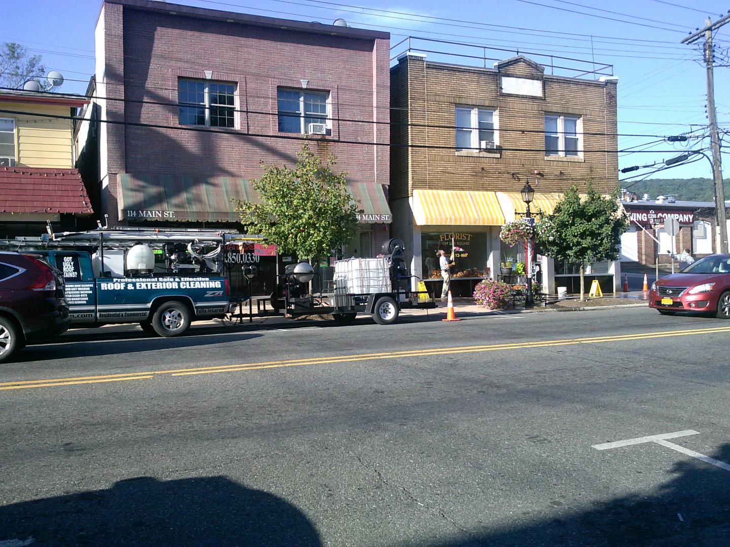

Ok so this joint wants power washing at this place as well. i stopped by and looked at one of the awnings...how could this have happened/ When it dried it looks better? photo one before two after cleaning number three today
Told ya....:}

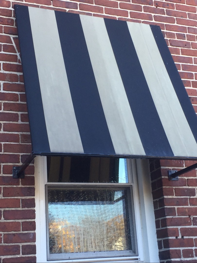

Aloha guys I have a canvas awning that has a coating on it. What is the best chemical product for that.
I like ac-12 The link is just a courtesy....not an endorsement of where to buy from.
If you add SH you can....and will....strip the coating.Use a moderate brush so that its not to hard or soft and don't apply too much pressure.
Do you have a picture of it?
I have used murphys oil soap with good results.
Here's the pics sorry not that close. No mold just dirt.
Chris
Pat,
Told ya....:}
