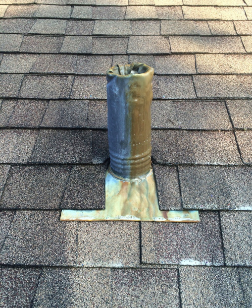

before you can say "oh $hit" its already too late
if you can get to it bag it
I learned about this this week. In case you're wondering, it looks like this...
