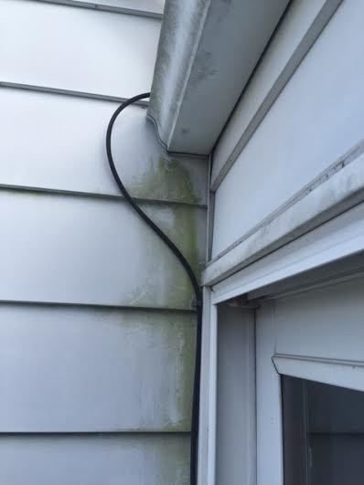

Take a look at this deal I just came across. ( hope pictures load)
house has 25 yr old aluminum siding on it and it's not supposed to be GREEN
gutters are same age , that roof is a shed not a putting green.
can anyone give me some guidance? I know it is a guess on the roof.. I assume a HEAVY solution on that and let is sit. 4%
I'm scared of the siding, don't want to ruin it or lose the rest of the paint. was thinking 1.5% SH, Soap and water.. let is dwell for 10-15 seconds and RINSE.
you have to be extremely careful with old aluminum siding. I would not use that hot of a mix just in case of overspray and def have a groundsmen rinsing the siding.

Set the customers expectations FIRST. If that is old alum siding A LOT of that paint may fall off. Be honest and upfront and know that the siding will release paint. Even 1% could be too much.

i didnt realize you were cleaning the siding. for the roof i would use a 30% (4%) and and becareful up around the siding.
Doug is right! let the client know that it is possible the paint will come right off. if there not ok with that then dont wash the siding.

Aluminum siding can be a total PITA! The only aluminum we have had success cleaning w/o brushing was painted. I always explain to the customer that it will not clean up well w/o brushing and then it just might remove most of the finish. That is a call they will have to make. Most of the aluminum we have cleaned was cleaned to be painted so removing all of the oxidized finish is what they wanted.
Feb 4, 2016
I'm sure it has lots of oxidation also so we regularly paint them afterwards. Do a lot of gutter painting that's been oxidized. Use a bonding acrylic primer first, though there are many newer self bonding finish coat paints.
A great up sell if they will go for it and you can paint but you will need to scrub to remove oxidation and failed paint coat.

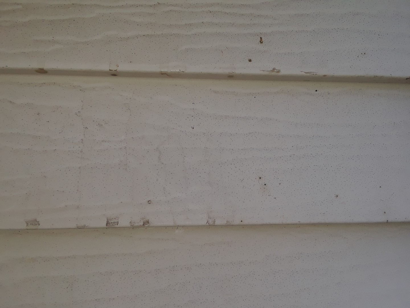

Did you check the siding for chalking? Rub a finger over it, and see how much paint ends up on your finger. This will let you know how bad it is. As far as the roof, a normal mix will do. That roof isn't bad at all. In what I see on roofs, that would be a walk in the park.

I did get some chalk on my fingers when i wiped it.. We are going to sit down and explain it to the client and maybe do a spot behind a bush or something.
Feb 9, 2016
The spot behind the bush would likely not be as oxidized as what is exposed to the Sun. I wouldn't do a test spot on the siding where it's in good condition, if they will allow you,..do the demo on the most oxidized side....Experience will get you away from having to do demo spots on aluminum,..and you'll be able to simply explain the job for what it is. That looks like smooth aluminum siding,..it always seem to oxidize worse than textured siding.
Explain it this way: The dirt is sticking tighter than the paint,..and to remove the dirt,..is going to bring some paint with it. How much,..is a determination by anyone who can see the job in person. Sometimes these jobs will surprise you and turn out better than you think,..even after explaining to the customer that the paint is gonna come off. "Under sell, over deliver"
