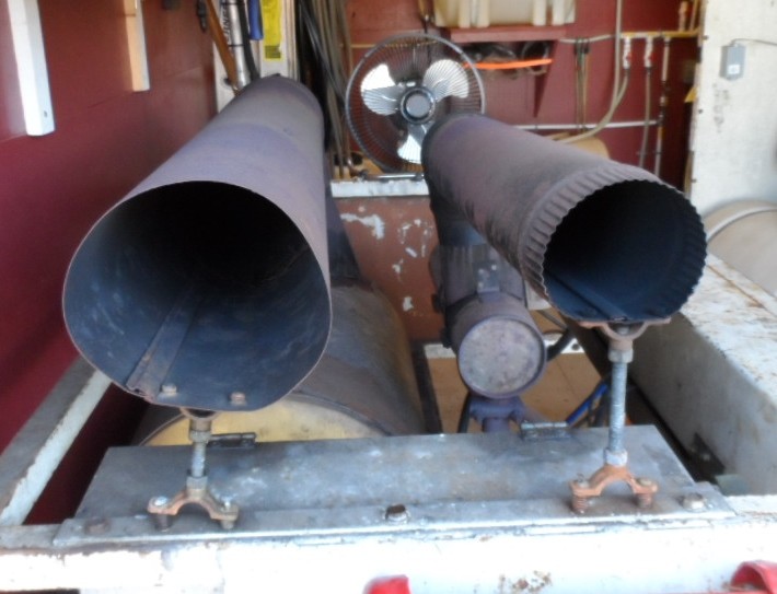

I started out with a 5x10 open trailer I already had. I out grew it quickly and then moved to the first E350 14' box truck that work well for us for two years. I then moved up to an Isuzu NPR 16' box. There are a number of reasons why I will never go back to a trailer unless it was committed to commercial only.
I live in an area with 5 small cities I service that date back to the 1700's. There are so many places where the trailer was a real problem due to parking, streets & driveways. I learned early on that the trailer was a problem more than once a week. Now we only have a problem with low branches and steep driveways that the tailgate hits.
I solved the problem with venting the pressure washer engine and diesel exhaust with black stove pipe out the back door.

The way I vent my box truck if I run PW off the back is open up rear door and put a $15 box fan at the cab side hooked up to a jumper pak with built-in inverter blowing g out. Simple cheap and modular. Just the way I like it😊

Some six inch pipe with one elbow and three inch with an elbow with a permanently installed fan wire into the PW generator. All the fumes go outside at a cost of about 50.00. Turn on the PW and don't touch anything.
Brett, I see the fan in the back. Is that hardwired in? That's the position I setup my vent fan plugged into the battery pak. Provides all the ventilation I need esp. when guys need a break from the sun and heat at lunch during summer.hell some days we keep a 5gal pail filled with ice water to dunk their hea da in lol.

"a permanently installed fan wire into the PW generator"
