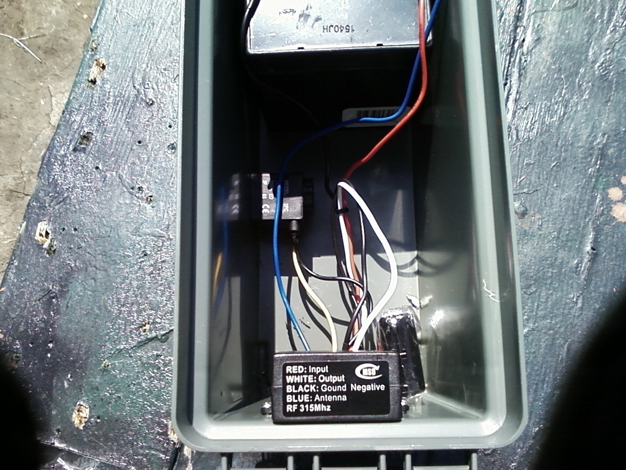

Hey Mike,..no,..the antenna comes on the remote receiver as a simple 9" blue wire. And it seems to be very adequate in my testing as mentioned above.
In fact,..my antenna is even enclosed inside the box I built,..figured I'd put it through a hole if it was gonna be an issue,..but as stated,..I get at least 300' with obstacles,..and there isn't any hit and miss,..it works everytime.
*But I did wire in some green L.E.D. lights as an indicator. Just put them inline with the solenoid,..when the lights are on,..the soap is on.
**I bought a heavy plastic bag thingy for keeping the remote inside and clipped to my waistband. Also gonna put silica gel packs in with the remote,..and a few inside the transmitter/Solenoid box.

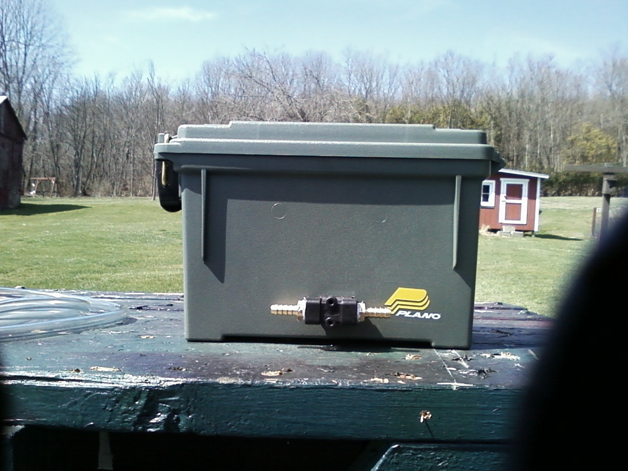

Heres a picture of my backup remote. Testing it was flawless,..worked everytime behind my own house at about 150',..BUT,,.that is all the further I went,..it's the same remote as the other that reaches 300' through houses without issue,...so I didn't feel it needed to be tested at a longer range at this point. It will be my backup,..I may also tie in the plug for the lights,..but in reality,..once I get comfortable with it coming on,..the lights won't be as "necessary". But that initial confirmation will be nice I think.
This is a standalone unit,..just plug in line of DS pickup and you're ready. This is one of the cheap solenoids $12.00. It is plastic with a Viton plunger,..Will be fine for a backup,..but I will also be using it off and on to see how it holds up in MY environment.
Total Cost: $56.00. And with pieces and tools laid out,..took about 15 minutes. Not bad to get your feet wet and see if you'd like a remote. And will also work with a pull start washer.
*I did forget to add the fuse,..not a big deal though,..I will put one inline. Will also be keeping the battery unhooked while not in use. **Ok,..I also see that it looks like a bomb.

You can also wire it into any other 12V battery you have on board already. I run my remote off the PW starting battery.
Also,.On these cheap solenoids I've been using,..I get about a month out of one,..but compared to the Dema 481P that I got 1 1/2" months it's a way better deal to stick with the cheap ones. Although they did raise the price on these cheap ones to $46.00,..I inquired as to why and the response was they are low on stock and the price will be coming back down. But I am currently using another cheapy. And so far after a couple weeks is still working fine.
http://www.ebay.com/itm/290909115114?_trksid=p2060353.m2749.l2649&ssPageName=STRK%3AMEBIDX%3AIT
I connect the remote to the plug using corresponding ,.. (2) pin plug connectors. Makes changing easier. I simply solder the connector to to spare solenoid and have it ready. Can be changed then in 2-3 minutes. In reality,..considering these last a month,..simply twisting the wires and black tape would likely suffice,.although I'm not condoning that, Ha,Ha,..
The main thing thing I wanted to do with these remotes is show anyone interested how simple they are to put together,..you can mix and match whatever components you like after you see how simple they are.
*When the Dema went, the plunger tore and it was easy to tell it wasn't working. It has a different type plunger.
**I've said it before,..and I'll say it again,...I will never be without a DS remote again,..completely changed the game as they say.
Finally put it together and used it today. Loved it! Did 3 sides of the house and then it wouldn't close. I could hear it click so I know it was working. Can't believe it wore out just like that. WOW!
