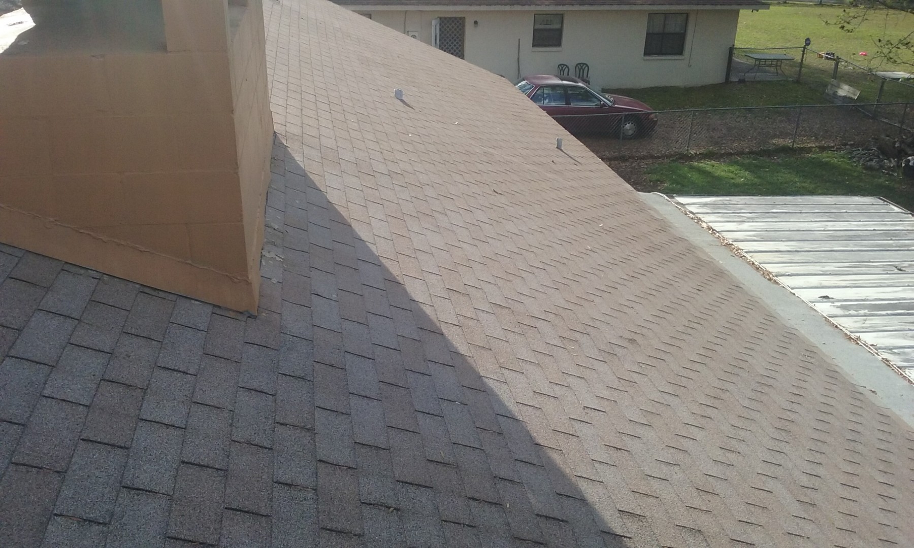

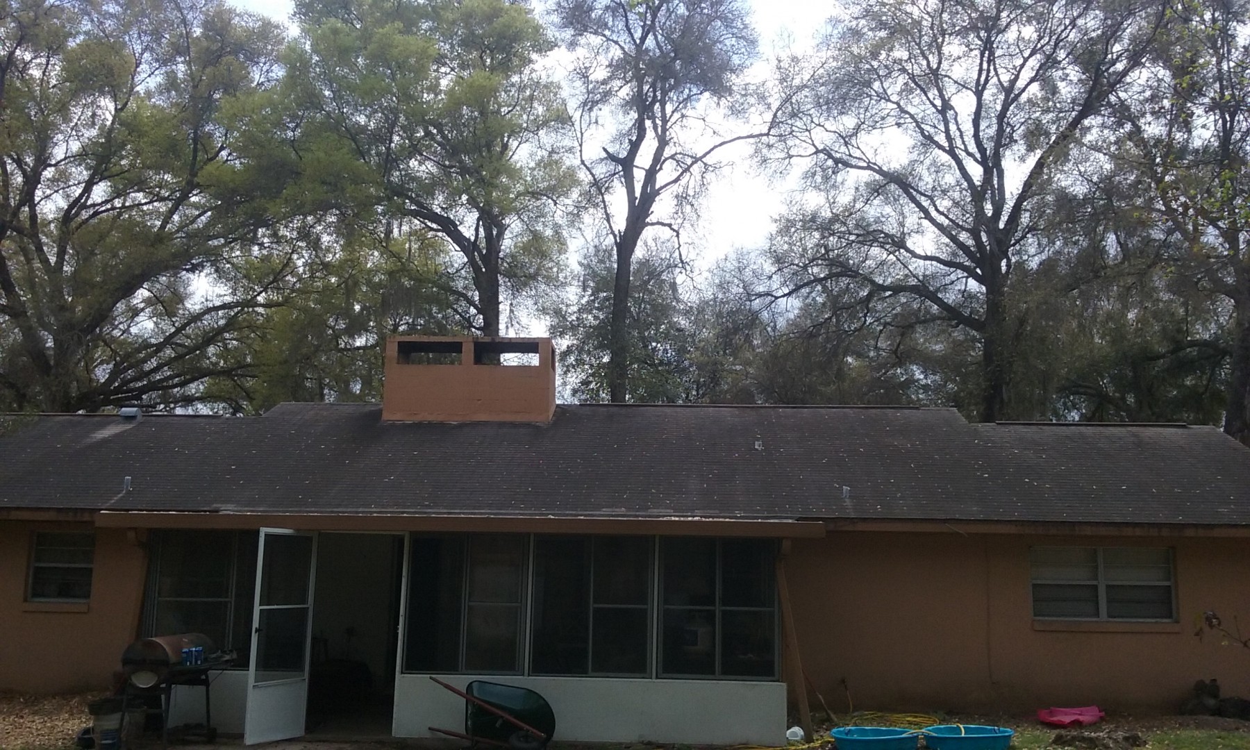

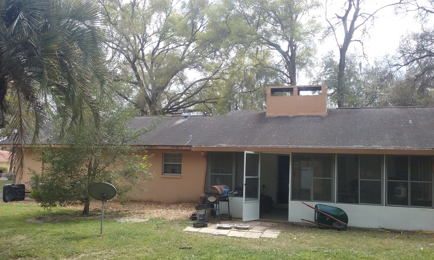

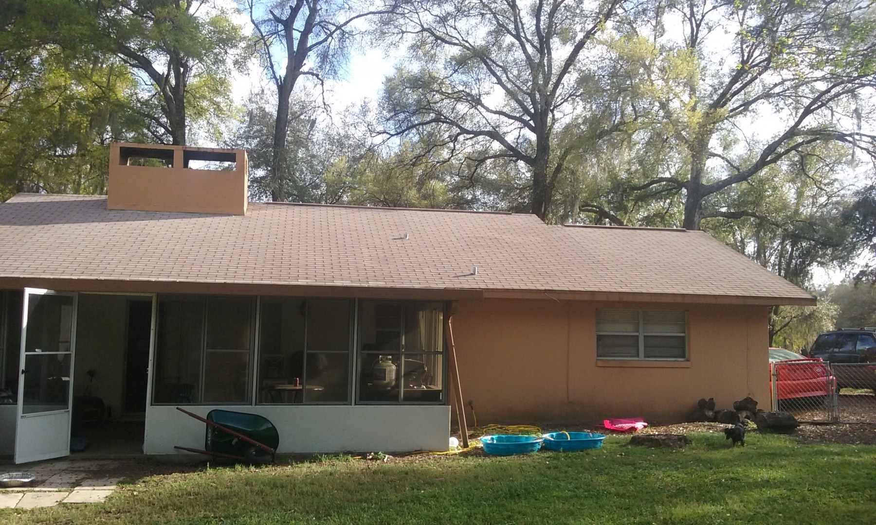

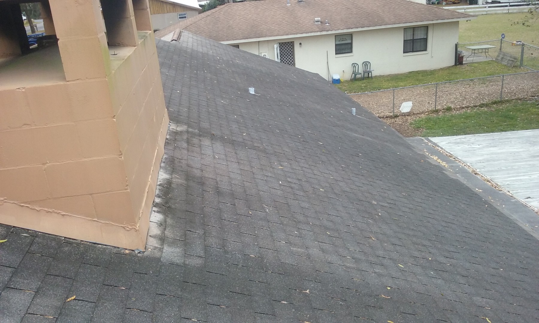

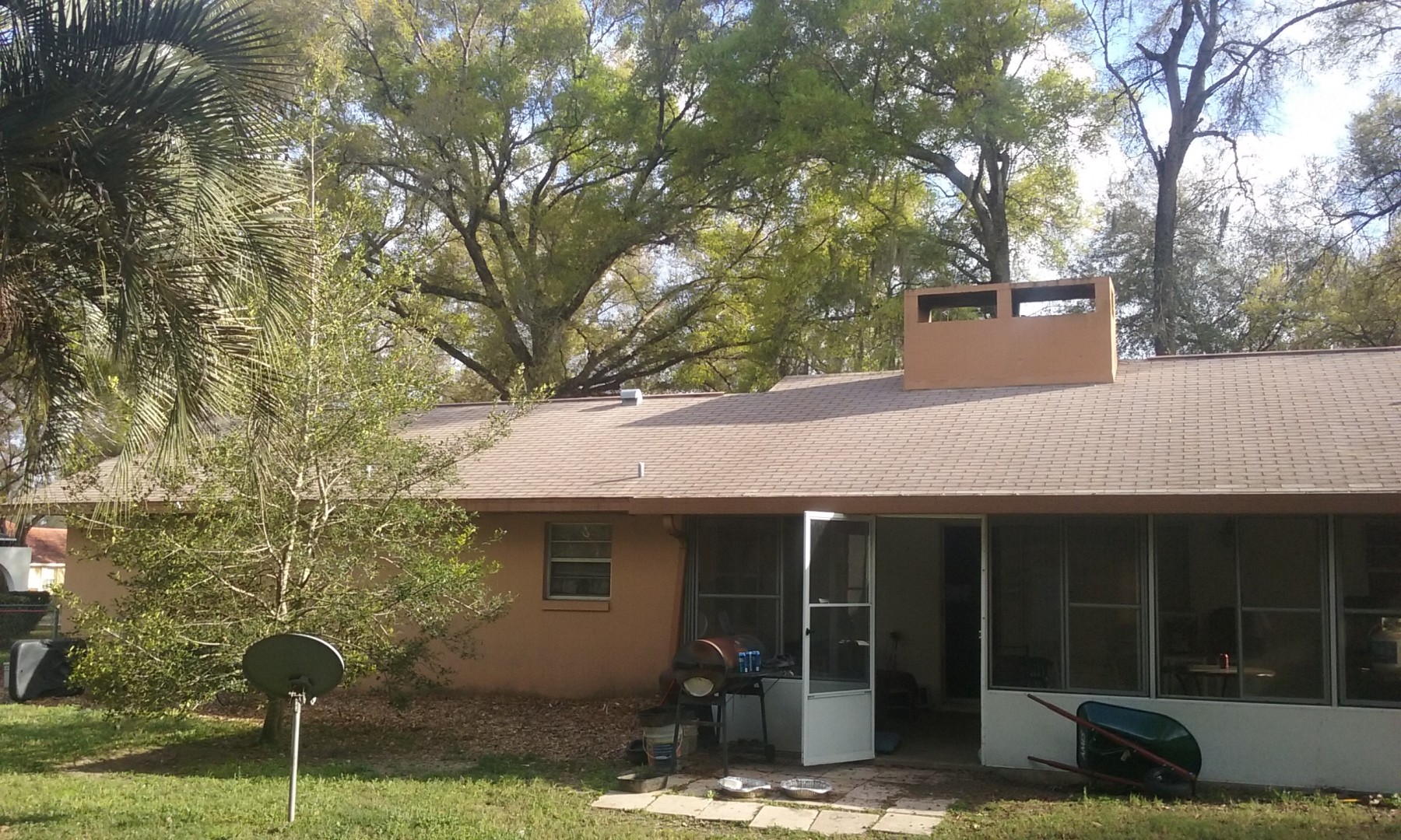

Great before and after photos. They tell the story.
Mar 19, 2016
Nothing wrong with cleaning old shingles so long as the homeowner knows ahead of time. I've cleaned lots of older shingles that, still had a few years left, for clients that were getting ready to sell.
Awesome to see you off to a great start.
Mar 19, 2016
Yea,..that looks good. Made the house look better overall.
Mar 19, 2016
A totally different home Nicholas!
Mar 19, 2016
Nice work Nicholas
njacobson said
Mar 19, 2016
Thanks everyone. yes, it made a huge difference. I had to spray, rinse and spray again because it hadnt been cleaned in 7 yrs and the shingles were deteriorated pretty bad. The algae and pollen was so thick and really holding on. I did learn that i need a booster pump for rinsing. I used my twelve volt system to rinse, and wasnt very efficient
