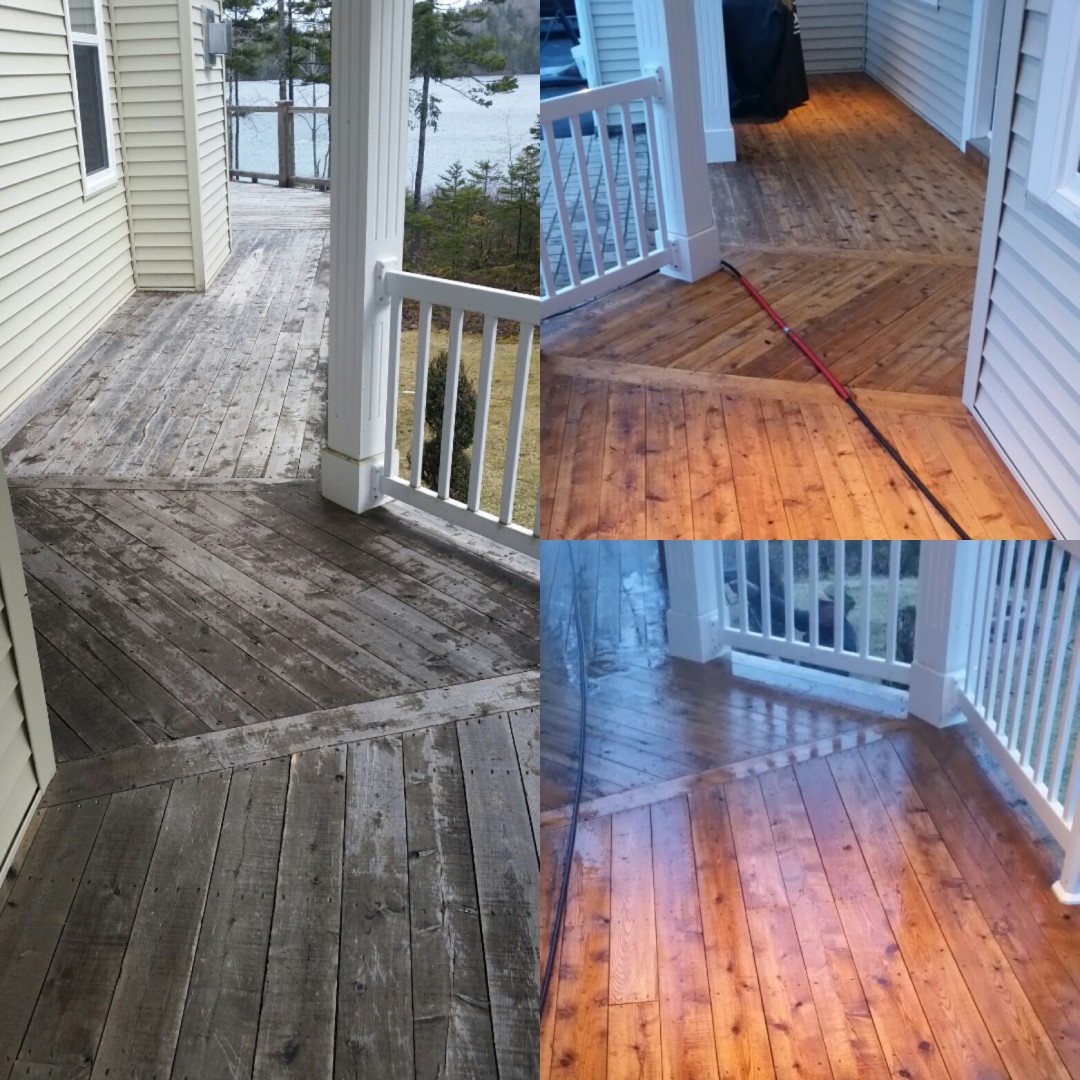

Looks great!, the only problem is with out a UV protective coating it will grey again in as little as one season plus it will dry, cup and Crack quickly, a 2-4 year recoat maintenance program is a great way to ensure future work !

Thanks for the advice! What would be a good alternative to stain? Linseed oil?
Apr 10, 2016
I wouldn't use linseed oil, there are products that have high iron oxide pigments that protects from UV. I'm currently researching for a huge IPE, Ironwood decking and cedar siding on the water and while Im not endorsing anyone but Armstrong Clark is very good and duck back super deck which was just aquired by Sherwin Williams and there's one in Halifax.

I use Armstrong Clark on my Cedar Deck. Every 2 years I hit it with a bleach wash and Britten it with o/x. Comes out great.

Simon, holy cow! That deck is truly transformed. Great looking job.
Apr 12, 2016
Looks awesome

Just restored this beautiful cedar deck. It was over 2700sq ft of wrap around decking. Came out absolutely beautiful,
The homeowner wanted It clean so they could stain but we're so impressed with the cleaning they want to keep it natural.
