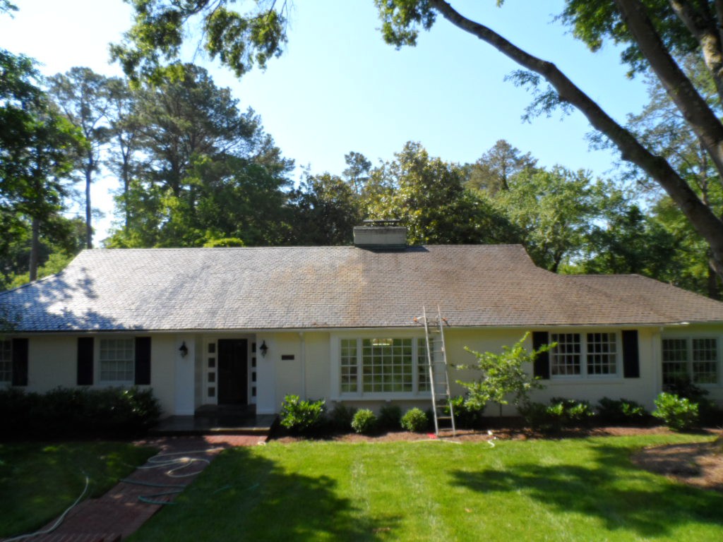

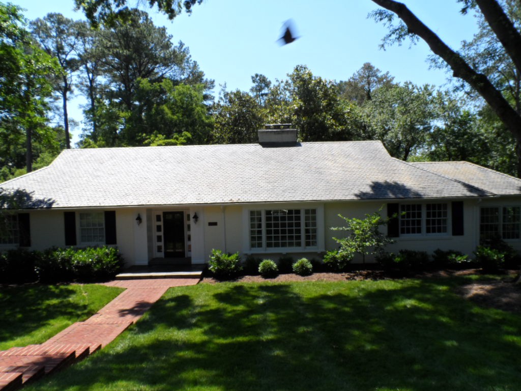

I do my share- favorite roofing to clean. i dont see a difference with surfactant or not. just less runoff with it. I only rinse the lead or copper metals.
Heres one i did as the first job of the year. Just needed a nice rainfall to wash slates clean.
Wow! That's a great pic. I can't imagine cleaning that without some skicky stuff.
Ive been using it lately pretty much whatevers in the tank from previous roofs. this baby was steep!

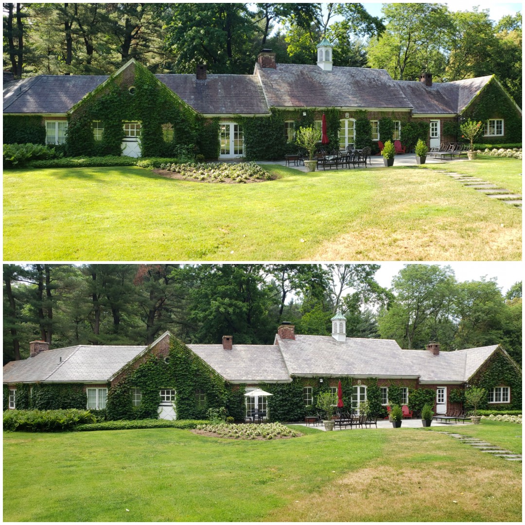

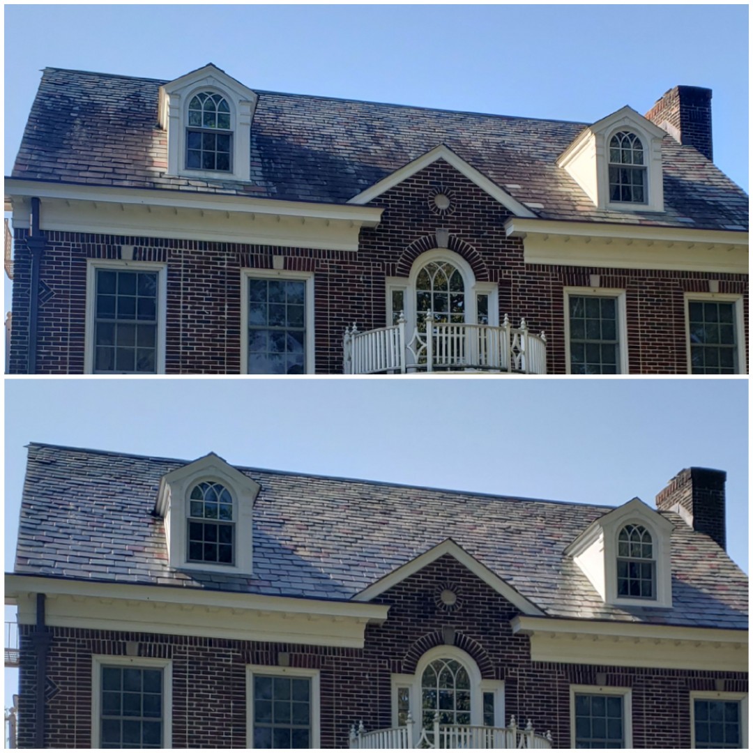

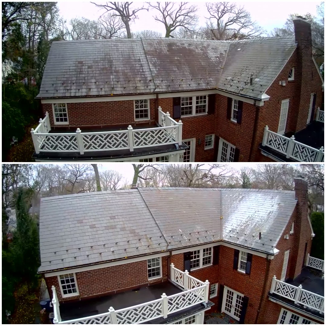

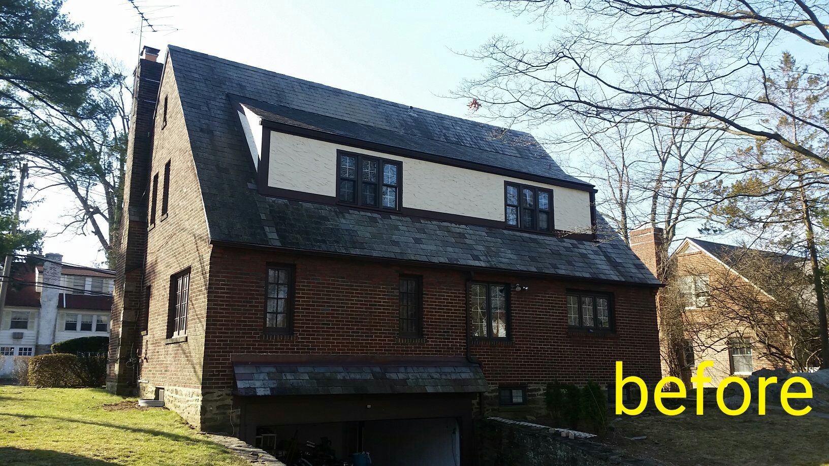

Slate Roof Cleaning
-- Edited by Art O on Sunday 8th of January 2023 05:57:42 AM
Slate roof cleaning
Nice Erik! I don't know why some make it a big deal cleaning slate. It takes a little patience and a bit more time. Once clean, they look new!
