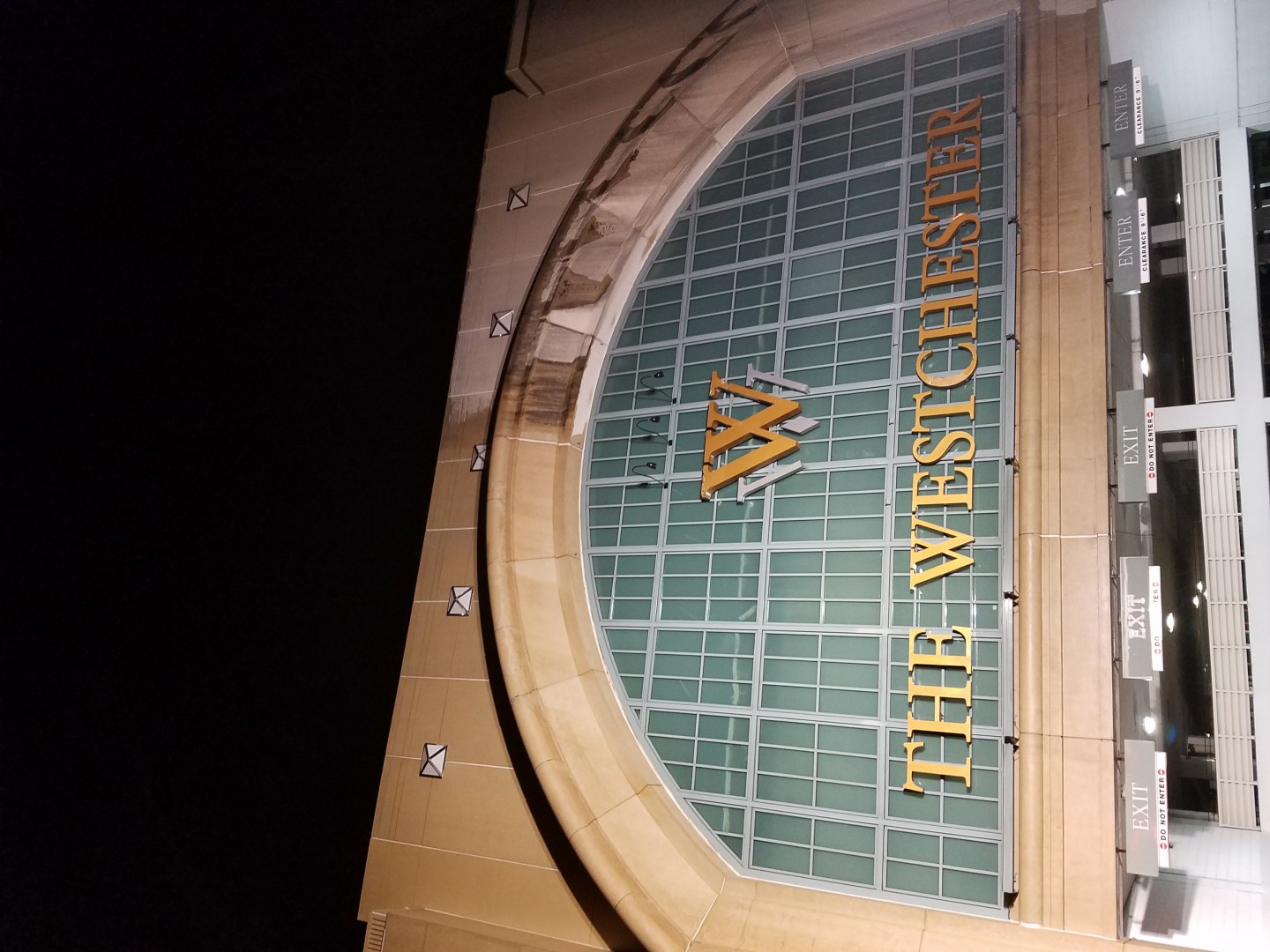

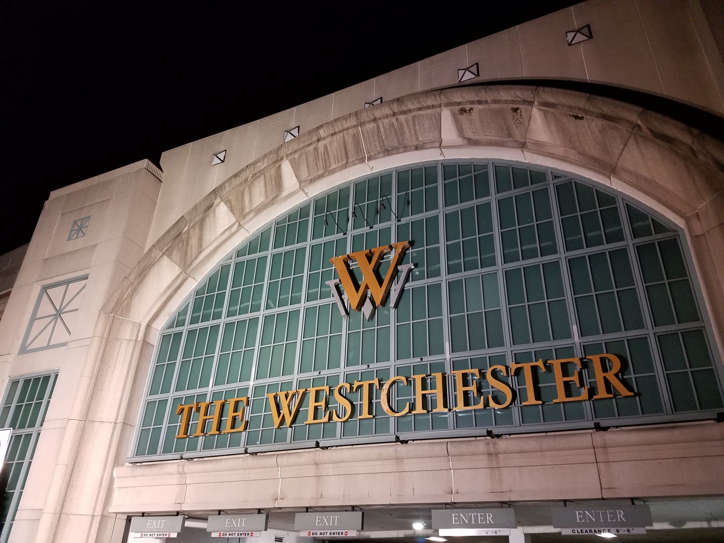

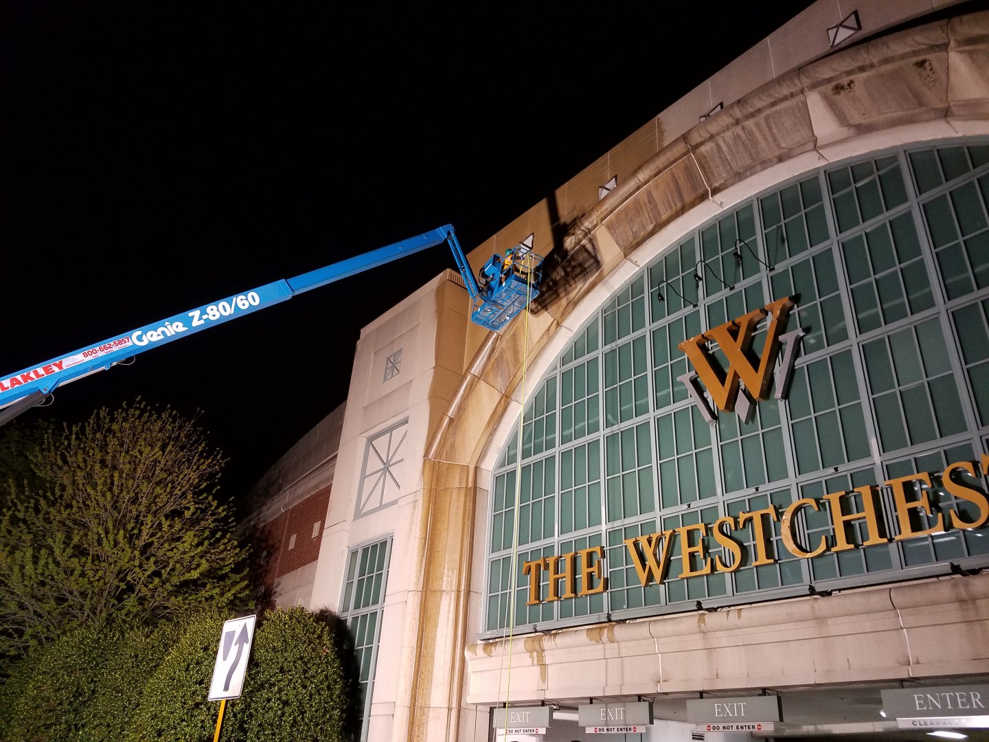

Here's a little demo area we are doing tonight for a property owner we do work for. They are flying in from California tomorrow morning and it was kind of a rush thing. The rain didn't stop us but we are glad to be done.

We had to do a mock up for theme because the project had 8 base bids and 6 alternate bids. We have a contract on the base bid's and now after the mock up we have just signed all of the alternates too. And yes I charged for it.
Hank it is precast.
Mav... I did it right at the main entrance above the parking garage entry for that exact reason.

Nice job John, that last rotated photo says it all!

Wow. Just a demo? Looks great. Curious what was approximate dwell time. I have found precast can be finicky
May 6, 2016
Thanks guys.
Andy, the majority of the wall we did got one coat of 3% mix and the nasty black areas around the cornice molding areas got 2-3 coats of 3%. Pretty much a 20-30 minute dwell time on all areas before a nice booster pump rinse. We actually love cleaning precast. I find it cleans easier than most substrates.
