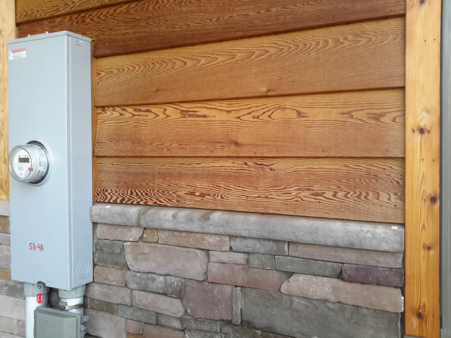

The last image shows the protected siding under the back porch by the electric service box

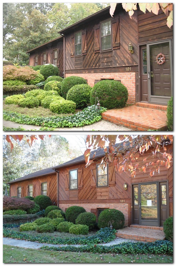

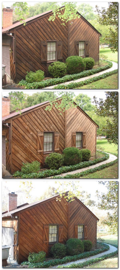

Hoover has a great recipe. Sodium per carbonate with caustic soda, rinsed with oxalic. The black at the staples are most likely rust. If you don't secure the bottom it will curl fast. Here are pictures of a home we did a few years ago. The first two are before, after cleaning then after stain. The third is B & A.
I appreciate the input. Great results on your project. Did you also apply the stain? What brand of stain was used?
Beautiful results.
Yes we did apply the stain. Rymar at Sherwin - Williams.
