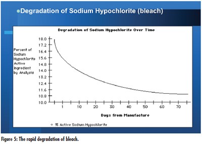

For everyone, a degradation chart of Sodium hypochlorite
-- Edited by Maverick Contracting on Saturday 28th of May 2016 03:46:40 PM
Thanks Maverick, That will help them out a lot !!!!
May 28, 2016
No problem, the stuff I get is 15% a day or so old but have noticed late in season (fall) seemed weaker, fresh it is smoking out of container and smells like a skunks azz!
