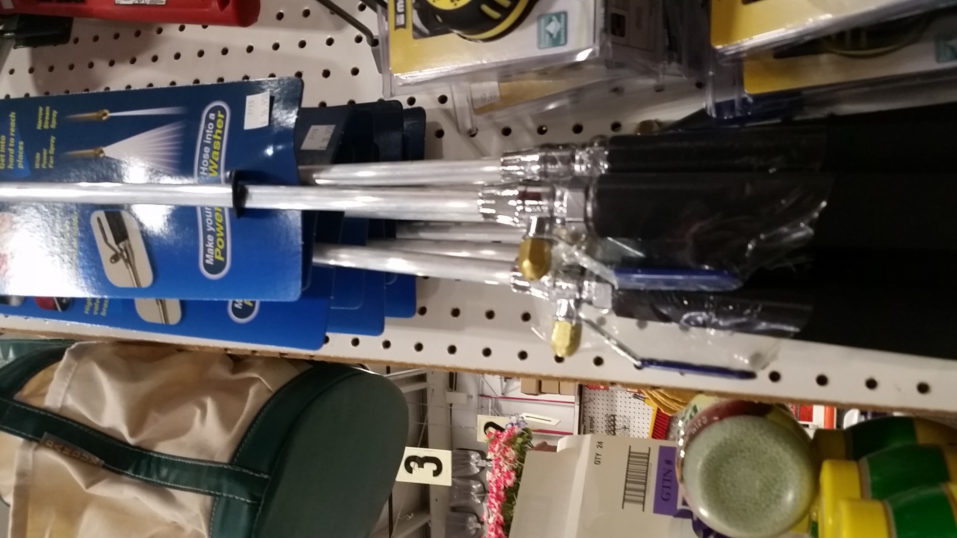

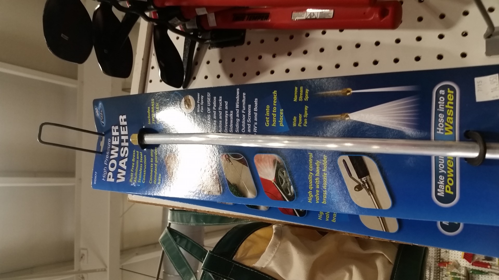

Found this the other day, don't know how well it works but has a ball valve

Maverick,..I doubt that is for high pressure. Iv'e seen those and they are made for the end of a garden hose.
