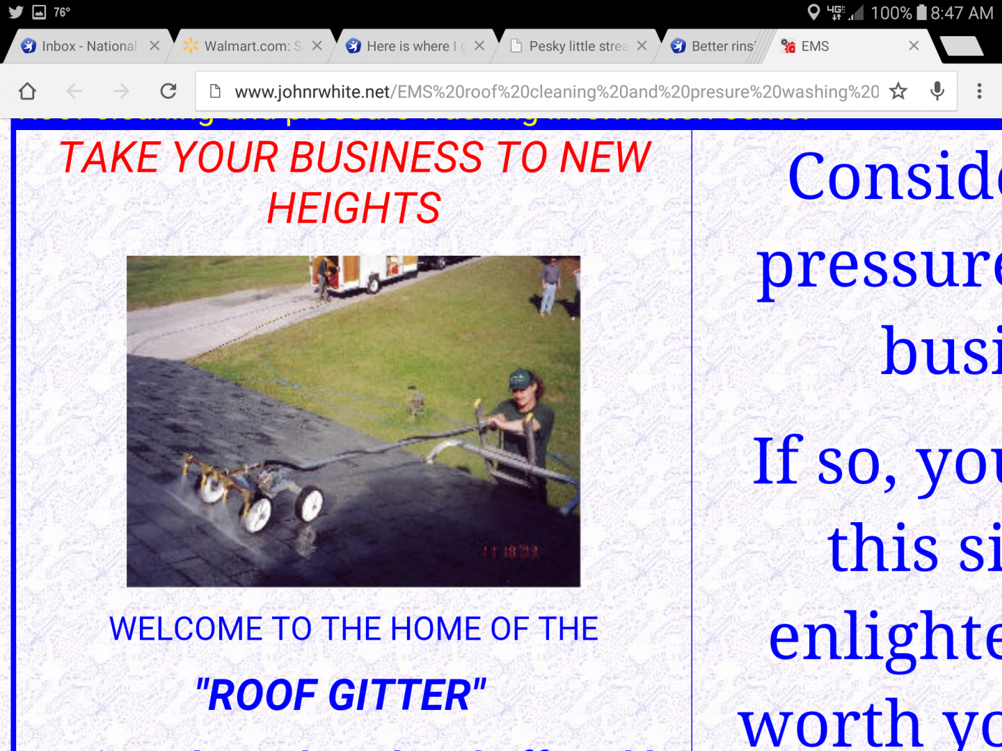

I've been doing alot of reading and research on getting my softwash roof cleaning business off the ground. I bought a ebook from John White in Virginia, and he explains how to do it and what tools I will need.
One tool is a roof gitter, but I don't see anyone on here using one. Has anyone seen this equipment?
I have bought 80% of the material to build it. Hope I haven't wasted that money. Any thoughts? Here's a picture
Water jets 4" from the roof surface is a bad idea. I bought that ebook too when I first started, but kept reading. I think there's better advice here, on the RCIA forum, and at Softwashsystems.com. Also Doug Rucker would be helpful to you since he uses a mix of downstreaming and roof cleaning. If I were you, I'd spend my first money with Doug and save yourself a learning curve. His online school really helped me with understanding terminology.
Yea i talked to him last night. We're going to talk more on the school Tuesday. Can't wait to start.
