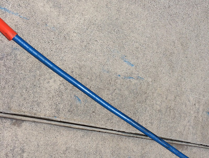

This is the blue (USA Brand) hose I got from Pressure Tek. What hose do I need. Can't spend the last 30 minutes of the job looking for blue marks on the concrete.
I completely agree. I bought one last year. It didn't start leaving blue until this season. The good thing is they come up real easy. The bad news is time! I have gone back to grey. It has never left a mark.
Bryan, after the blue hose brakes in it stops leaving the marks
