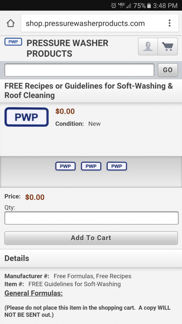

Just was reading on the net and came across some recipes wanted to see if they sound legit to you guys. If so I'm going to keep this for a reference. Ty

What's the source link?
Jun 1, 2016
I'll let you know when I get back to the house
Jun 1, 2016
LORI, "RCIA" Maverick you have been around long enough to figure that one out.
Got it from here.
No. You can draw plenty of value from this.
