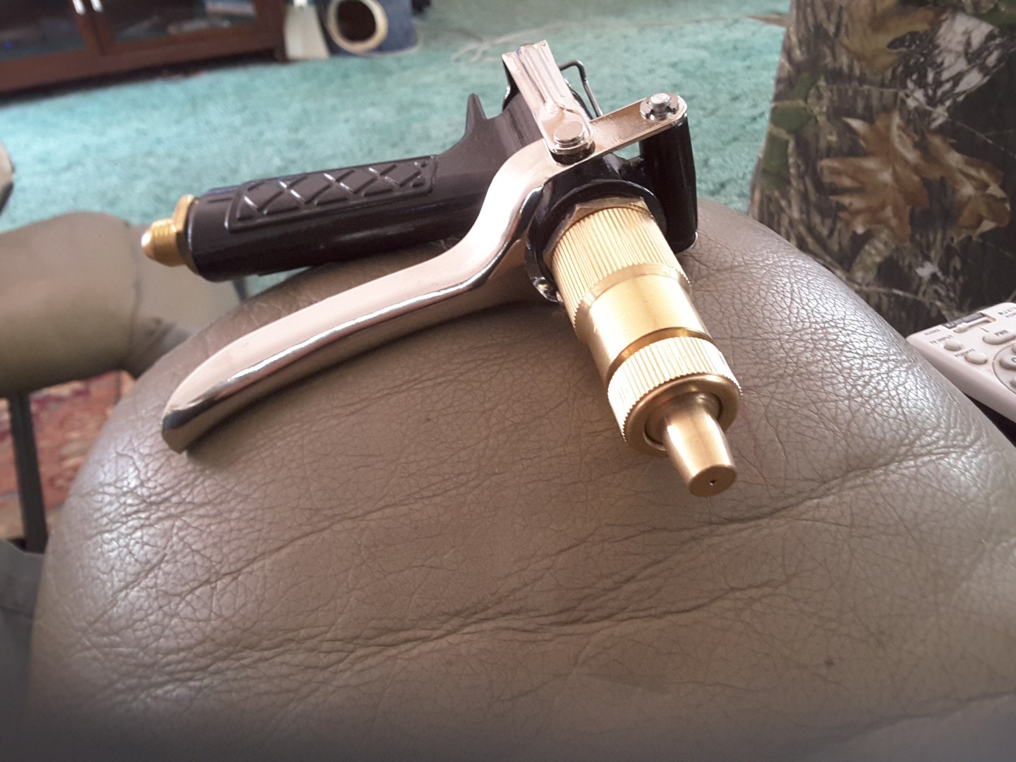

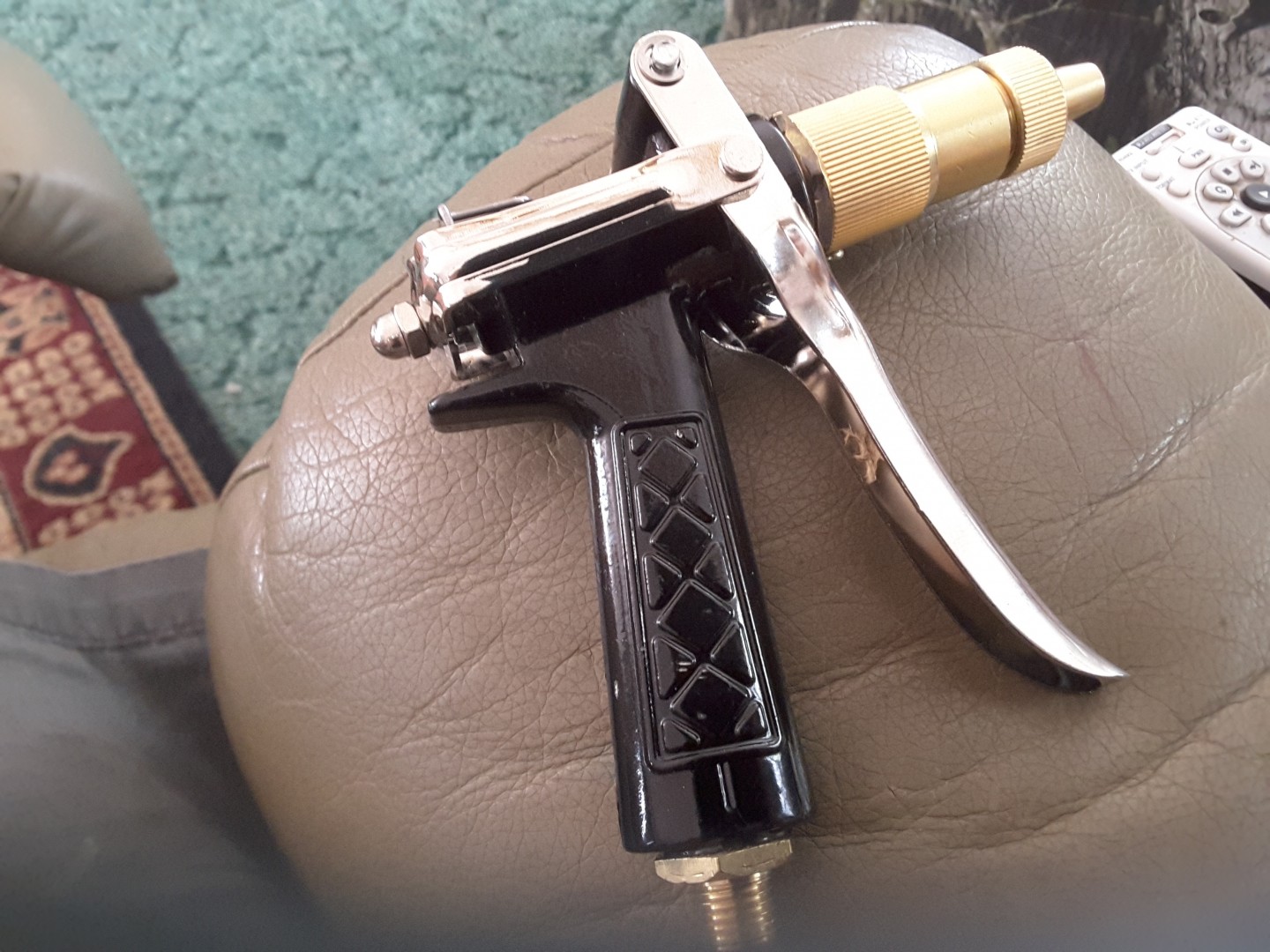

Bought this off ebay before I realized it was in china. Now 1 month later it arrived lol cctop wash gun.
Don't know if it is worth a crap or not lol.
Anyone else ever use one?
Do distance test (45 degree up is best).
Would like to know how tight it holds its pattern
I had to track down a hydraulic fitting to fit those threads on that thing. Hooked it up and my battery is dead on my washer lol forgot to charge it, grrrrrr.
But the stream goes around 20 feet just with the water on so that's a good thing I guess.
Have to let it charge over night while we're at the hospital.
-- Edited by A_J Pressure Washing on Wednesday 1st of June 2016 10:07:10 PM
Better be a low pressure machine or you may sprain or break your wrist from the kickback, better off with a wand if that's your intention of use.
How many psi is it rated for ?

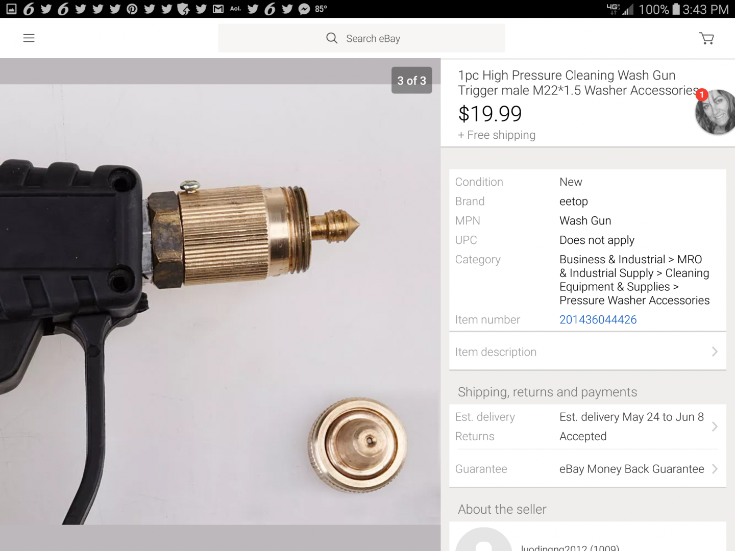

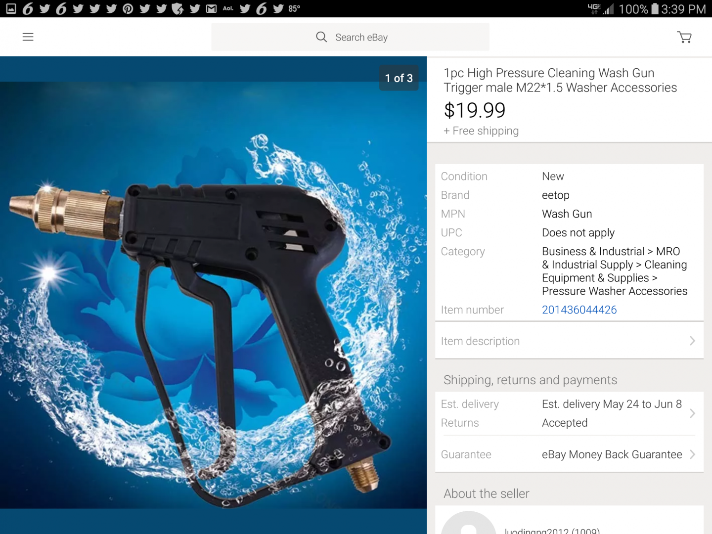

Here is a couple pictures of it and what it's called on ebay
And a pic of all the specs I have.
One more.
8m = 26'
60c = 140 F
Twenty-six feet isn't bad especially for the price.

The video does it for me. Thanks for posting it. I'll stick with shooter tips!
As an employer, "ain't no way that will be on our truck!"
Honestly, you folks are growing a true hands on family business and that type of spray gun will get you hurt.
Your humility is to be applauded, as getting input from the seasoned professionals can literally save your life and make you money. Posting the video allows them to help you make an informed choice.
If you have an industrial heavy duty pressure washer, please use high quality spray guns. They really do not cost that much, but you get to come home with all your fingers at the end of the day.
Any gun that does not automatically shut off, when dropped would be a missile on the end of a high pressure hose.
Just this week, we had two absolutely preventable operator errors with a pressure washer and both could very easily have killed one of us... Unbeknownst to me at the time, I was only six feet away from a open pressure washer wand when it was powered up. Fortunately I only have to turn in a claim on a very large damaged sliding glass door system-- My wife is not making funeral arrangements
Respect all that power and it will serve you well.
One of the reason OSHA requires certain length lances (wands) if so that if you drop, or miss fire a pressure gun, you're not hurting your self with a laser beam of water.
